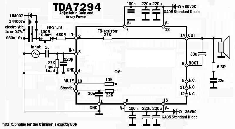

Ok some more TDA7294 related questions.
I am hearing a power on pop and a power off pop.
My present values are 10k between mute and +
And 22k with 10uf for stand by. My plan is to increase the 10uf to 47uf will it help introduce a delay any other ideas.
They say the power off pop is not dangerous but Id rather not hear it. The board has 4 x 4700 uf caps.
My P3A board has more so when I power off the music plays for a few seconds and fades off which is fine. There is a power on pop though. But only sometimes.
For reference here is a schematic.

just a remark: if the GIF shows the values of your circuit the amp has around 32 dB gain, not 27 dB.
you would need to reduce the feedback resistor to around 15 kOhm (slightly less or you dial in a higher value to ground with your 100 ohm trimmer) for 27 dB.

No the gif was putup just to show my mute and standby situation / values.
I have read the data sheets and have been playing with these values but it doesn't seem to change much.
Technically this setup should not have a turn on thump or a turn off pop. But it does.

By the way the mute circuit on the data sheet should work ok to prevent power on pops, but unless you have a control signal that changes level when the power drops, it won’t prevent the power off pop or squeal.
The gif above has nothing connected to mute/standby pins.
A mute/dc protect relay is a better option although more complex and expensive.

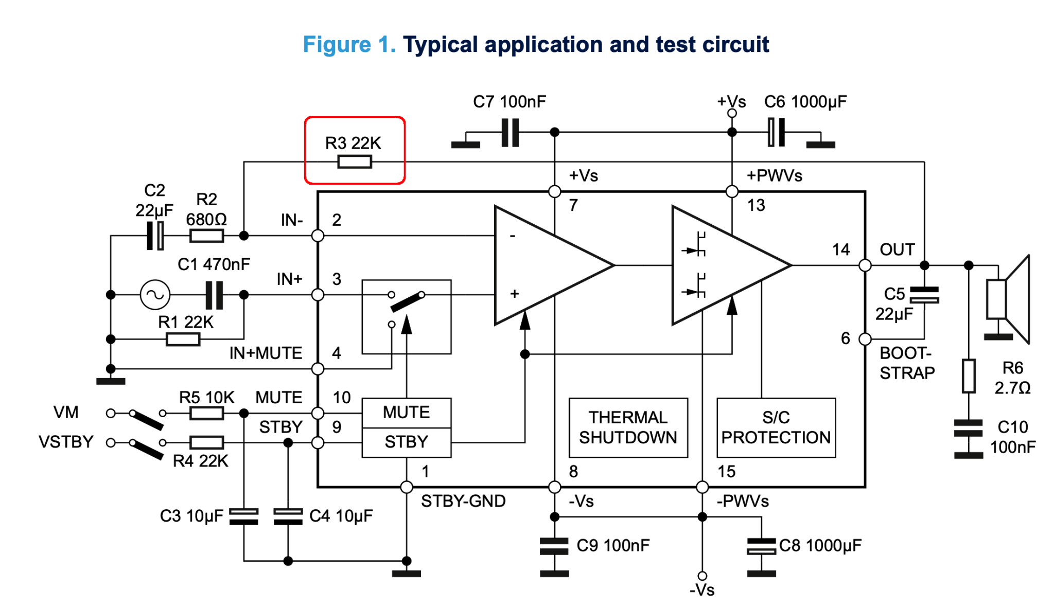

If your circuit looks like this, replace R3 with a 10 kΩ resistor for 23.9 dB gain. You can also put another 22 kΩ resistor in parallel with R3. That'll give you a total of 11 kΩ, which results in 24.7 dB gain.
Changing the gain will allow you to go up to maybe 3-4 on your 0-30 scale. The best solution is to add a volume control.
