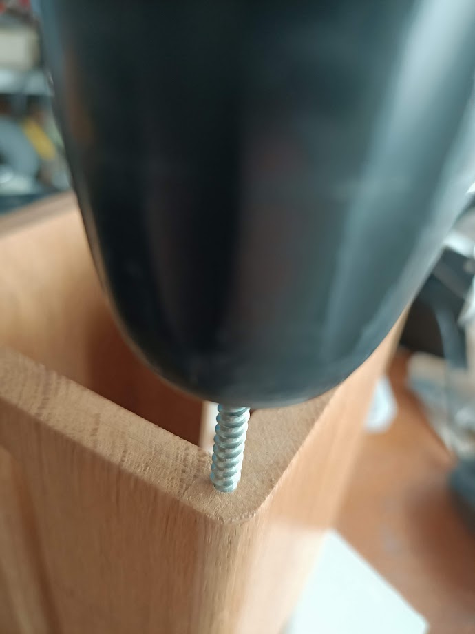

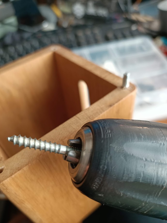

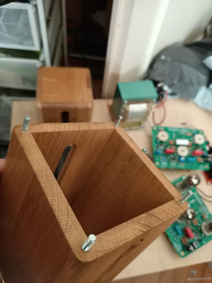

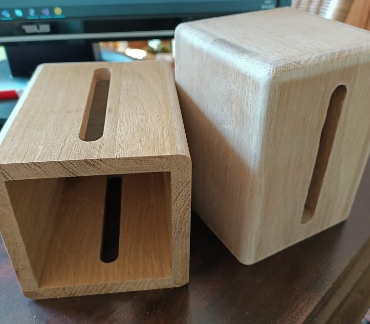

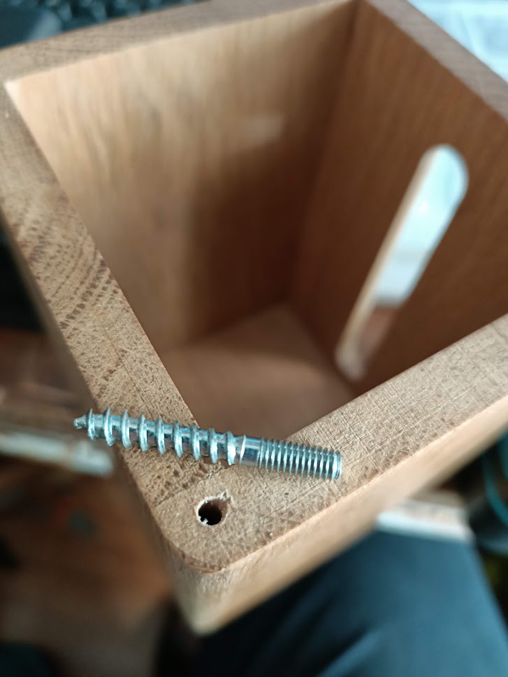

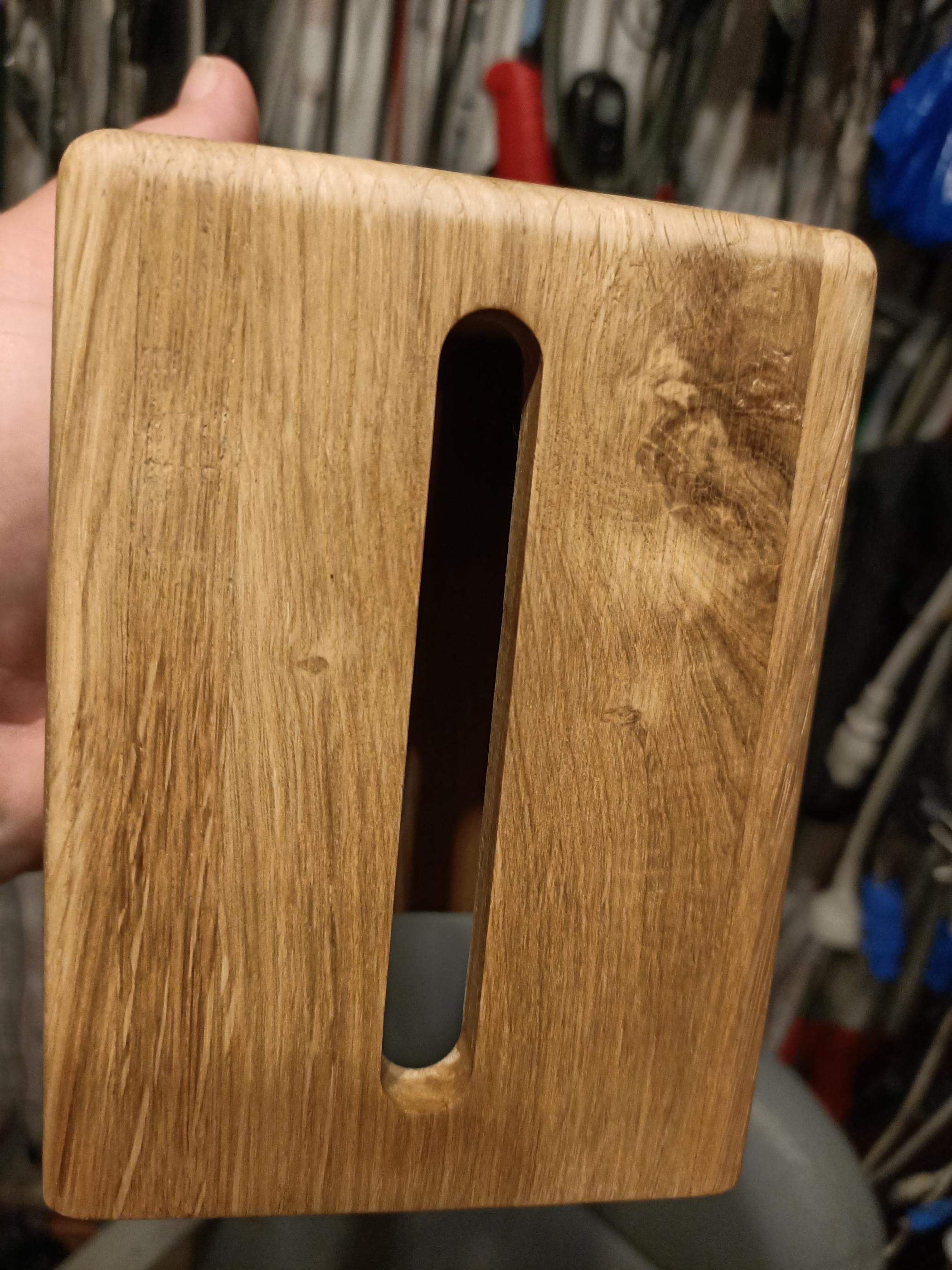

I'm prepping the enclosures for the transformers now. They are Ikea pencil boxes. I've used them before...but this time I thought why don't I route the sides round....

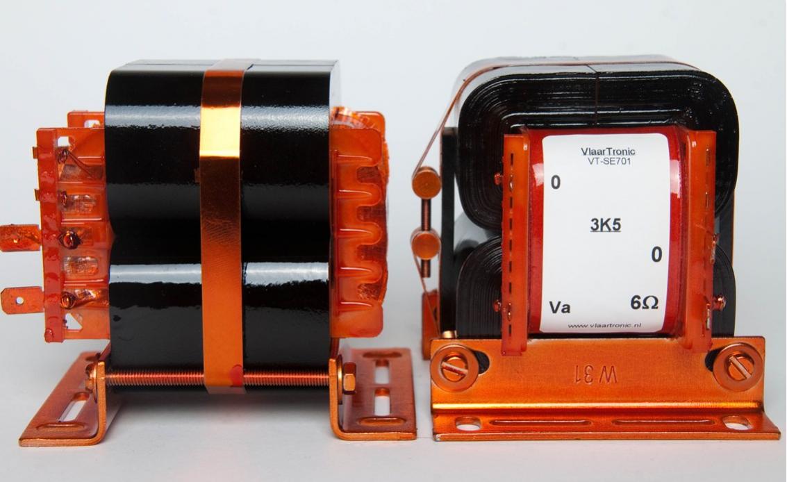

I've ordered local. Not only Dutch but also around 20km from me as the crow flies. The ones on the picture below are single ended ofcourse. But the ones I ordered are based on those cores.
Perhaps interesting. I've asked UL taps to be 25% instead of the ubiquitous 43%.

Hey Bas! Tell us more about those transformers! Have you used them before?
What are the prices like compared to say Lundahl?
Hi Mac. I've used the single ended output c-cores before. In my 6v6 single ended amp. I am very happy with them. They are not cheap. But I know the craftsman who winds them. No rush jobs by a big company. He is a one man shop.Hey Bas! Tell us more about those transformers! Have you used them before?
My PP EL84 cost 225 euros per pair. Home - Vlaartronic They would have been 175 in EI core versions.
I just bought power transformers from these guys. They also seem to have nice EL84 PP. 2 Stuck Gegentakt Ausgangsubertrager ATR 15 8000 Ohm Raa UL | TBT Trafobau
That is cool! It is always good to have another transformer supplier. Especially one who cares about quality and craftsmanship...
I feel like it is worth the extra money for the knowledge that the trafos are well made and quality units. and supporting a one man shop in the Netherlands. Thanks for the info!

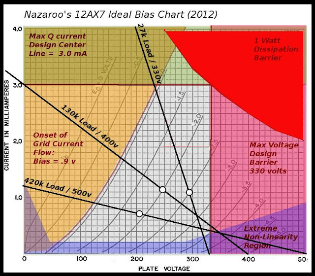

Voltage across r18 is 1.056 volts. Perfect.
From member Planet IX
1,1/1000R=1.1mA
Measured is 1.056mA. So that each half of the triode is 0,5mA. Which is the target set by the designer.
Bas, I’m checking things again before I push the button to buy my parts, and I noticed you stated the designer aimed for 0.5 ma per 12ax7 triode. On my schematic, dated Nov 19, 2018, it shows 2.5 ma for the combined tail current (see just below R5). Am I looking at the wrong schematic? It shows R18 as 560 ohms.

The 2,5mA is I believe meant for the EL34 version which has higher b+.On my schematic, dated Nov 19, 2018, it shows 2.5 ma for the combined tail current
The original baby huey el84 was aiming for around 1mA/1,2mA. Someone pointed that out to me and did the math. I think he was right on that count.

I looked at the 12ax7 loadlines at 0.5 ma fixed by the CCS. I expect ~130v on the plates (310/440*189) based on gabo‘s post in the BHEL34 thread. He measured 189v on the 12ax7 plates for his EL34 build with 440v B+, and with his R18 at 680k. That seems to be a better operating region in the loadlines, than the one for BHEL84 under the conditions mentioned.
Since Ian designed the BHEL84 to run 0.5 ma on the 12ax7 triodes (based on your review of the thread) something could be wrong in my analysis. I hope someone more knowledgeable could help to explain the apparent discrepancy.
It would be very helpful if someone with a completed BHEL84 could measure your plate voltage, cathode voltage and voltage across R18 (assuming 1k, or mention what was used)

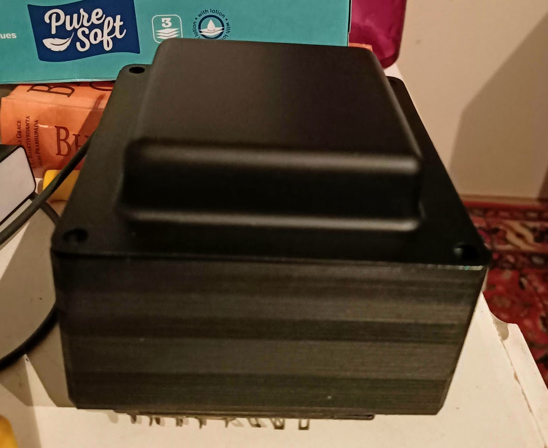

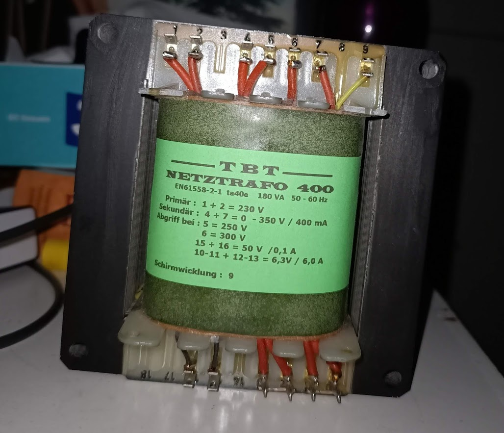

While there is beauty in a big bad *** black power transformer. I don't like the way it shows dust. And prefer something lighter. Hence the repaint (something I try to keep to a minimum...as painting is tedious, takes time and is in my experience easily damaged. Not a 100% sure I'm going with this transformer yet. But it is on the table.
