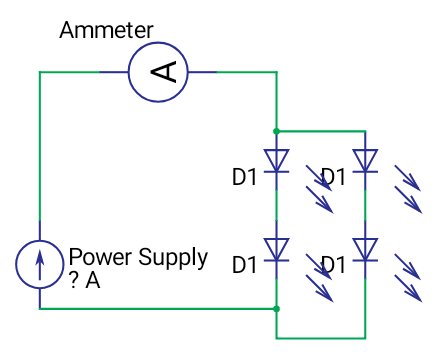

Just to make sure as I don't know your level of knowledge - current reading needs to be done in series ie. You will need to break the connection.
my meter has but i am have no practice with this. you have to switch the red cable from position mA to 10A... further the lamp blinked once i was measuring i don't want to screw things up.Your meter have a current setting? I would measure that, then you have a good starting point.
what exactly should i setup on the meter to measure ~700mA?
-add yes i have done it in series that was ok...
Set meter to 10a and move the lead
Disconnect one side of the power to the LED module
Put meter in series ie. The disconnected wire to black and the disconnected side of the LED module to red. Best to connect up unpowered and then power on.
