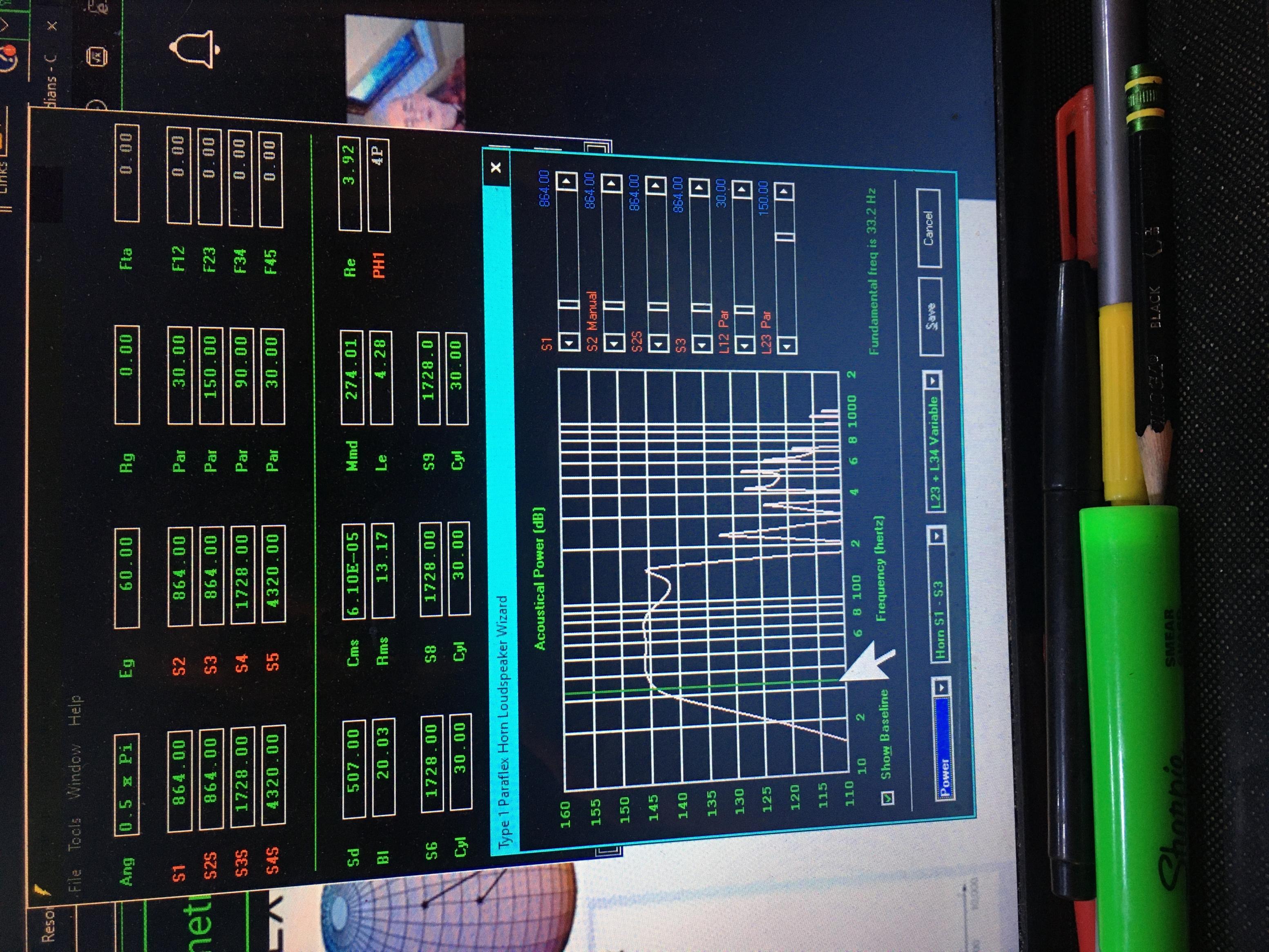

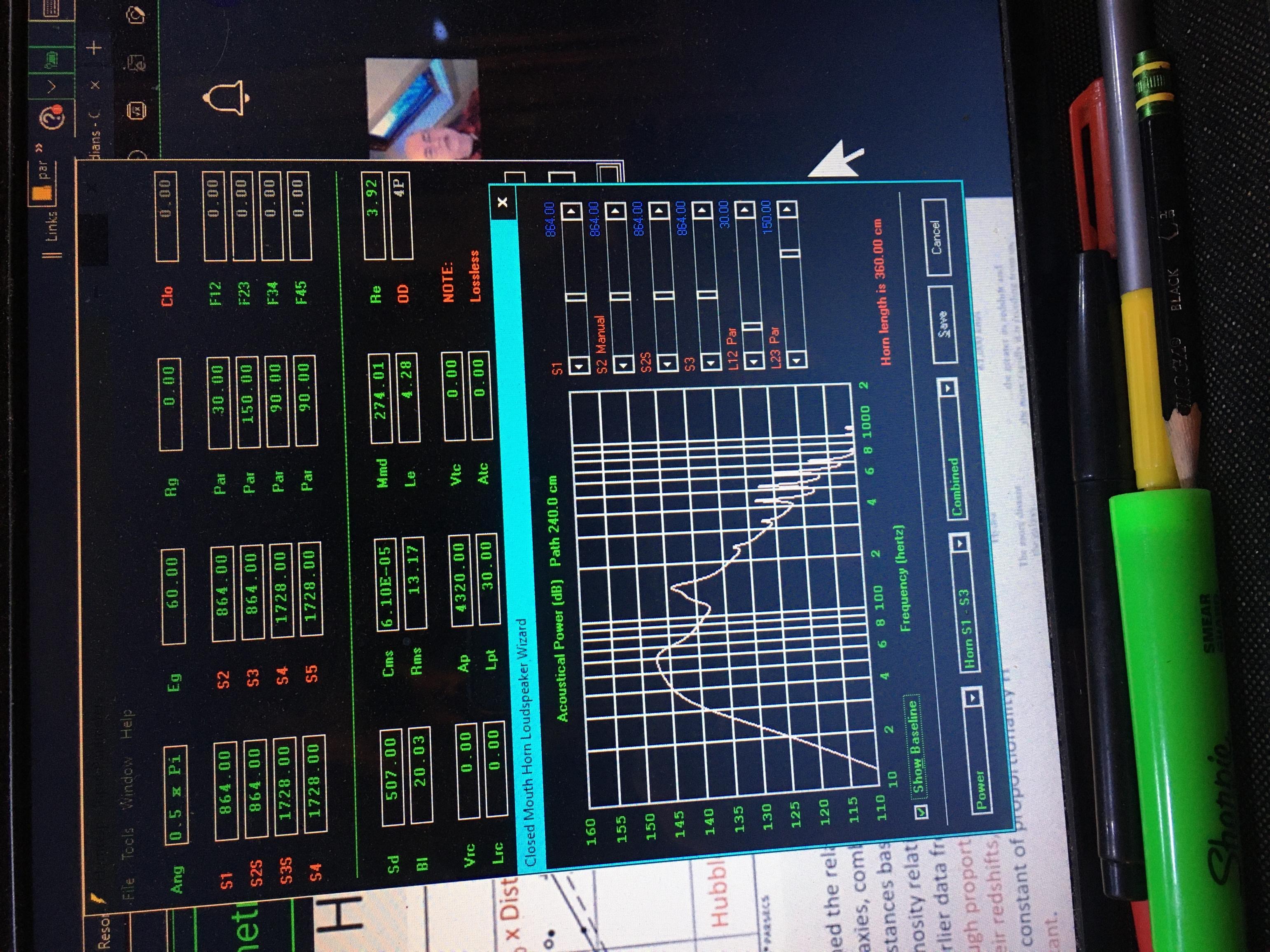

While working on the BOXPLAN workbook for the TH-SPUD tonight, I was struck with an idea - would there be any value in placing the mouth of a TH not at the end of the expansion, but offset from it, e.g. at S4 instead of S5 (so S4-S5 becomes a stub that's closed at S5)? The offset could possibly be used to null out one of the out of band resonances that THs can be subject to.
Is it possible to model such a beast in Hornresp?

Hello Brian,
It would indeed result in a reflection that could out cancel some frequencies, but if you want to cancel some frequencies out of the total system response a better solution would be to do this in electronic part of the audio chain.
If you want to cancel out some specific frequencies spikes, that are originated from resonances within the horn, you can not do this in electronic part. You have to place some closed end stubs inside the horn at the exact right place. See for instance the DTS20.
gr. Marcel
gr. Marcel
Those resonance peaks that are caused by the speaker's properties will tend to amplify any harmonic distortion that's generated at those frequencies, and that can't be addressed by electronic means. Best to deal with them if you can within the speaker's design.

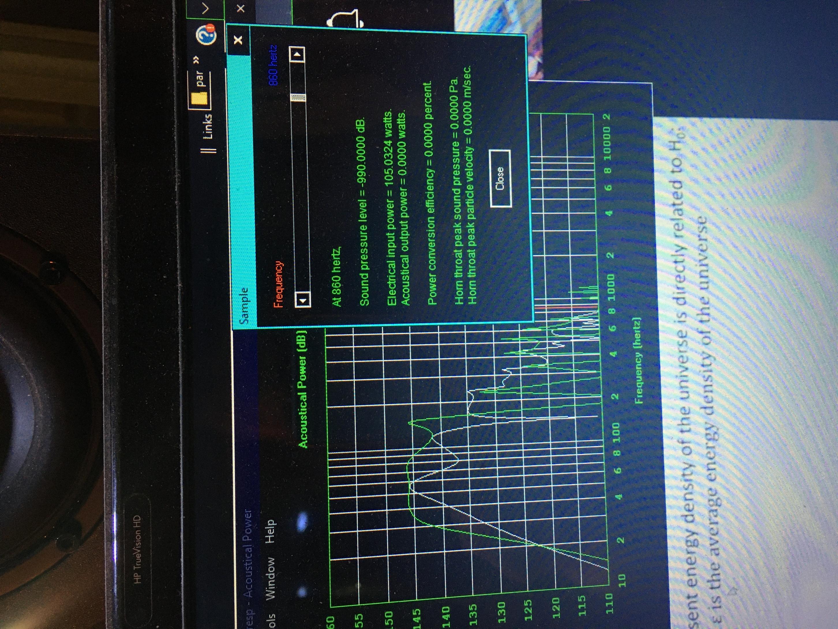

Thus is what I wanted you to check out??
-990 at 860 hz.
That repeats over and over again at that same interval of 860 Hz the Entire Way out through 22 more in the 20k of horn resp/human hearing span.
It also rides in a ripple of 48,96 and 192 hz between those and the math sneaks in at 191 every now and then so it fits in between every other 860 interval meeting 1720-ish is when that swaps. But what happens is the pattern and all of those numbers as they climb are the exact same sequence that we can see lots of numbers that some of which are 1728 (0) with a zero is 12×12×12 or the inch in the cubic foot and square foot. But 864s also diameter of the sun and Decimals shift and all this will be the metric system effectively but it works and frequencies to as you go up it would seem 860 From the 864 that it becomes , (or that it prior to that was in the long long version of math Where the numbers will repeat themselves though they will be longer or much shorter inevitably they become repetitive version of the same thing only slightly changed and all of that) to that is the number of seconds in a day on earth (86400) (1440 minutes) which is also diameter son and half the diameter of the sun, is the radius 432 squared , is the speed of light at 186xxx andthe long list of numbers that that that represents there after is ridiculous but the 30 cm that is being used to start /beginning of the same as if you draw a right triangle above the planet earth and the short leg is 864 mm and the triangle acute angle at the sun outwawrd towards the earth at 30° , the hypotenuse will be 1728 and the long leg will be the 150 that is the second entry also the distance from the sun to the earth. (30 is the angle of the speed of light is parallax to the parsec in the light-year ) That’s only the beginning I could fill out four pages of factual information into Regards to this and perfect to the decimal point…
