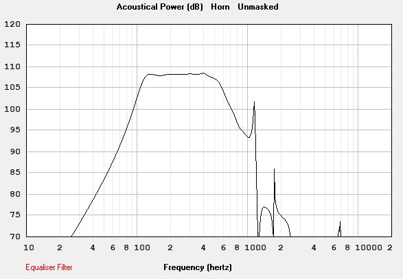

Great. I am getting some really interesting figures while playing with Hornresp. I will try to come up with a meaningful combination of available drivers and available space. Dual 8PE22 offset horn looks interesting so far.

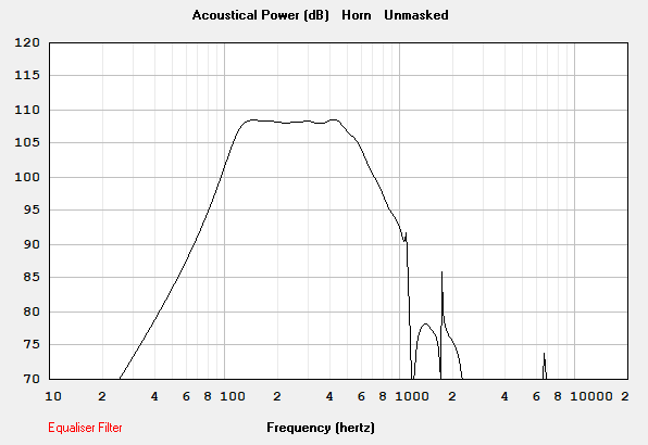

This is just a first trial, roughly 60 x 60 x 60 cm with two 8PE21s, Hornresp record attached:

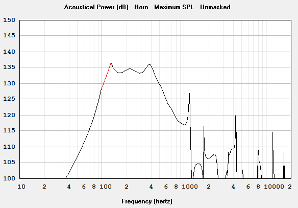

Theoretical max SPL in half space:
It is just a quick sim, but it should fit my goal. I forgot to mention that my targeted horizontal dispersion is around 60 degrees.

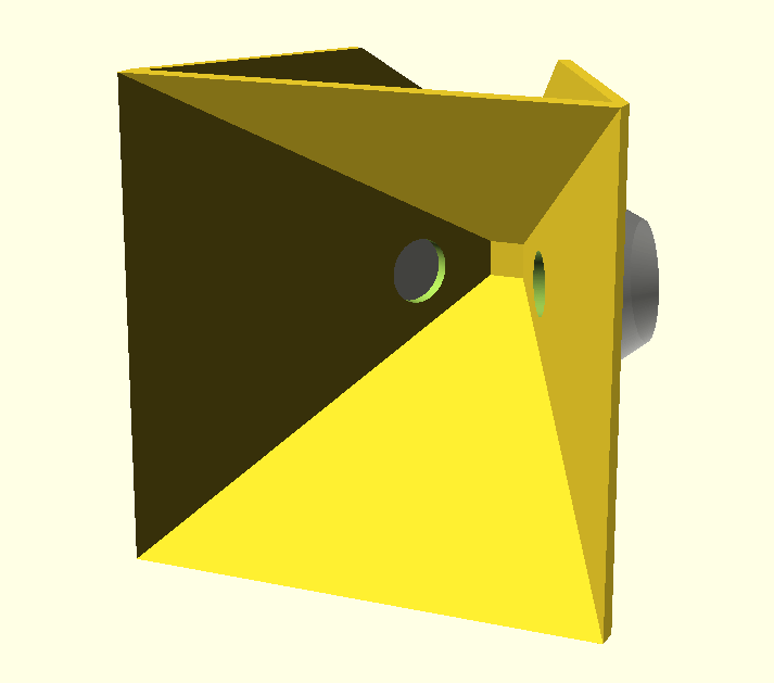

The model in OpenSCAD is getting closer to its final shape:

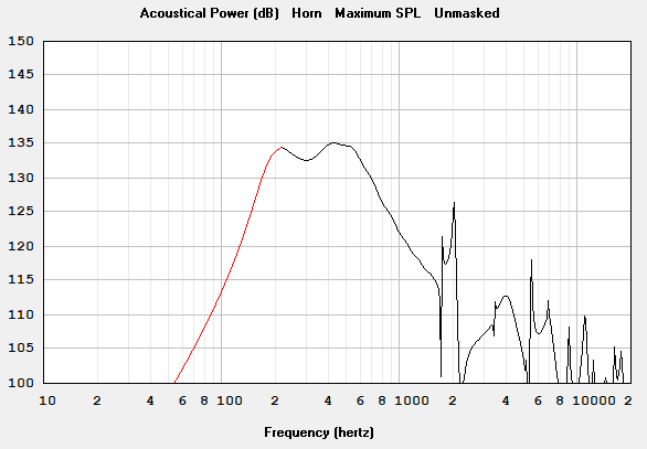

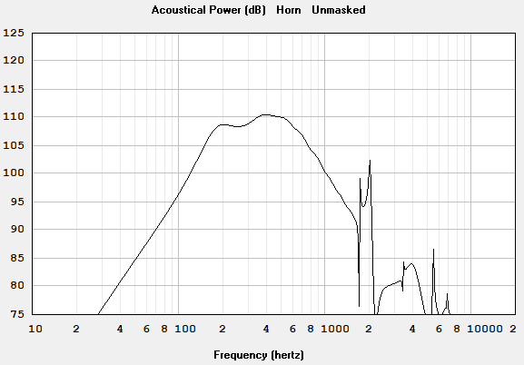

Raw Hornresp model:
And with a bit of EQ:
I need to have a look if I still have some 16 mm chipboard left🙂

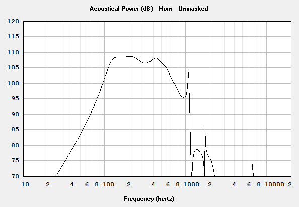

Raw Hornresp model:

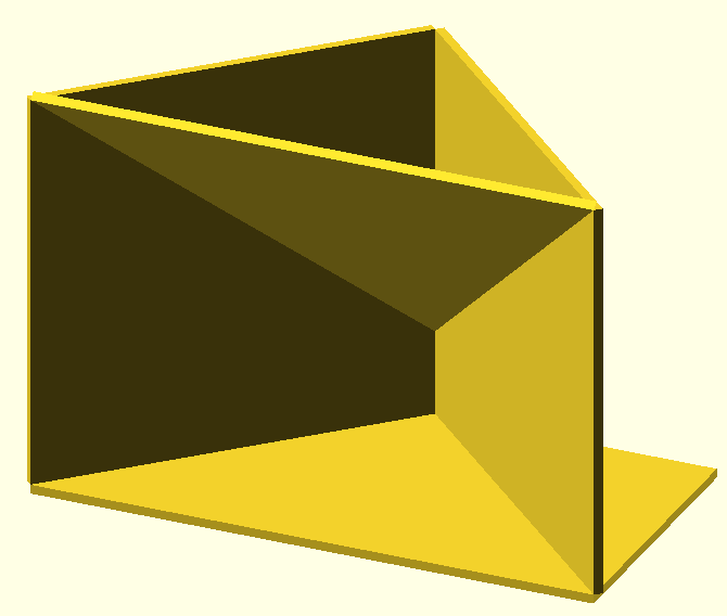

Since it will be placed on the floor, would it make sense to make the horn vertically asymmetrical? Flat bottom and the upper wall at an angle instead of angled top and bottom - it would save some wood - would there be any benefits or drawbacks to this?
It's what we did in some prosound apps and I did in a few high end HTs and IIRC seems like I saw a picture of one at one of the USA DIY Meets ages ago now, so if it suits your app......... Ages ago now someone sawed a 511 horn down the middle where it was welded together, made an adapter to mount a cheap, small tweeter horn driver to it and dang if didn't load that little driver down to nearly 500 Hz (at low power of course!), so proved a valuable POC that in a way also works with what I'm currently using; i.e. the Altecs I've posted pics are MIA service wise, needing new HF diaphragms, XO caps installed, so have RS Minimus 7 mounted flush on their sides, making the empty horns acoustic amplifiers down to their ~250 Hz cutoff and increases system efficiency to the point where folks not familiar with the Altec's sound assume its them they're enjoying at (their) high average SPL till they get very close to the 7s to clearly hear the acoustic BSC 'step up' disconnect, so to speak.
You'll have 3 benefits of putting the bass/mid unit on the floor and having a flat bottom. No floor cancellation, all the space below the tweeter horn can be used to create a big enough upper wall to do the job needed, and the source would be further from the ceiling widening the allowable ceiling angle for controlling the ceiling reflection.
If you can implement the proper control with a symmetrical waveguide, then you might prefer to do that however the chances are that you'll run into compromise there as well. It's a matter of which is more workable.
Thanks for the feedback! The construction of such a horn should be really easy using available right angle triangular bars and some CNC.
This is how I imagine it now - just the panels creating the horn.
