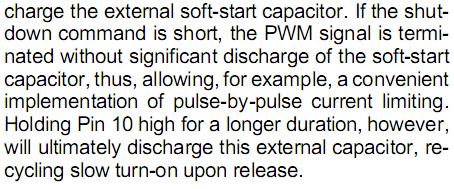

Take a look at the appnote for this IC ,I think you will have all protection you need with a very simple current monitoring circuit simple diode bridge with two resistors and cap.Check Marty Browns 280 watt HB while book has many errors for this circuit idea is same.Have a good one as an after thought I see a few of the SG3525 supplies with SS cap value larger than needed.
