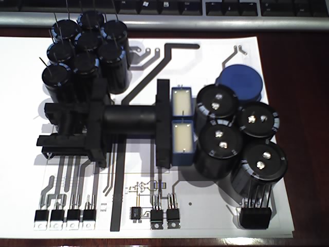

Done the magnetics today
The main trafo, 36+8+8+4, ETD59, N27
The inductor(s), 6+6, ETD34, N27, 1mm gap
The current trafo, 1:100, R12, N27

I attach preliminaty layout of the board, it will be 20x20cm.

jamesrnz, the formers are from Distrelec catalogue.

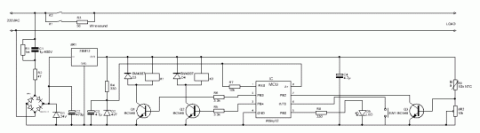

Now I'm working on soft-start circuit, I thought about using a triac, but simulation shows that pulse current is a bit high, and charging SMPS primary caps this way wont do much, so I've decided to have a fancy soft-start with resistors, relay and MCU (Attiny12) which will provide us with a fancy-one-button-on-off-switch, allows to have temperature protection, plus I've connected relays as I've seen it on Mark Hennessy pages, this way if soft start relay fails, maximum damage will be a burned out fuse.
