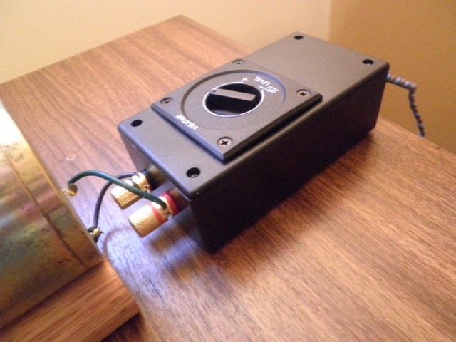

off-theshelf L-pad or build with 2 resistors
Right. I'm distracted by other work at the moment. Here's the correction.

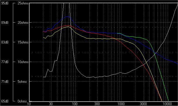

It stands to reason, shmb. If I could throw in my 2c about the plot in post #12, the dark blue trace (resistor after filter) comes down to join the red (L-pad) trace at its lower end. Ie: the resistor after the filter keeps the crossover point whereas the light blue (resistor before) doesn't.
However, it is the higher up parts that we care about more and the resistor after doesn't control that well. Some tweeters have worse impedance peaks than others.

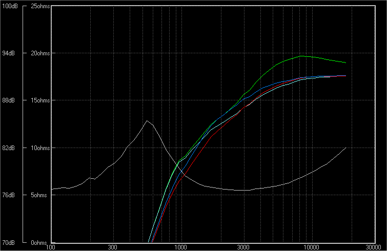

Is it possible to do a simulation on my design?
Heres my situation: The tweeter is a Vifa D25AG-35-06 (6 ohms) and it uses a 12db HP xover, with a 5.6uF Cap and 0.47mH Coil.
Originally I had a 2.2R resistor in series (before xover) and gradually, after many listening tests, ended up with a 6.8R.
Now, since reading this thread, I've tried removing the 6.8R and replaced it with an l-pad arrangement (after the xover) consisting of a 6.8R in parallel with the tweeter and a 2.7R in series. Theoretically, the tweeter should now be louder, but it sounds almost softer now, probably because its so much smoother and imaging has improved massively.
Is it possible to do a simulation of my situation with the single series resistor vs l-pad arrangement?

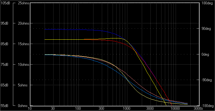

Possibly. You can't assume the tweeter behaves like a resistor whose value varies according to the impedance plot and when you rearranged this you did more than just changed the impedance magnitude. To be certain, you need to include impedance phase.
Anyway, my considered guess is that your tweeter is now a little louder, but it cuts off at a higher frequency. I'd say maybe half an octave, ie: above 2kHz now.
Ok, well it does sound like its crossing over higher, maybe that's it, but how can that be?
I always thought, from what I've read in the past, that a second order filter (unlike a first order) won't vary its cutoff freq with impedence, only the Q varies?? Maybe its got something to do with what you mentioned just then, ....impedence phase? What does that mean?

You removed the leading resistor that was reducing the crossover point.
Electrically, the tweeter can behave capacitive, through resistive to inductive.

Probably means that they expect the impedance peak at resonance to be dealt with. The simplest way to do this is to use an L-pad but the effect will be only partially dealt with in that case. The better way to do it is to use one resistor, capacitor and inductor in the form of a series notch filter. This creates an equal but opposite peak for a flat total. If you can find such an impedance peak compensation filter on an existing design with this tweeter then it will save you the time of measuring your own tweeter and simming it.

"Now, since reading this thread, I've tried removing the 6.8R and replaced it with an l-pad arrangement (after the xover) consisting of a 6.8R in parallel with the tweeter and a 2.7R in series. Theoretically, the tweeter should now be louder..."
If you had moved the 6.8R to the back alone the tweeter would have been louder, but then you added a voltage splitter, the 2.7R, which really makes an impact. Try the theory by removing the 2.7R. You will see. And by the way, put the 6.8R in series, like before.
