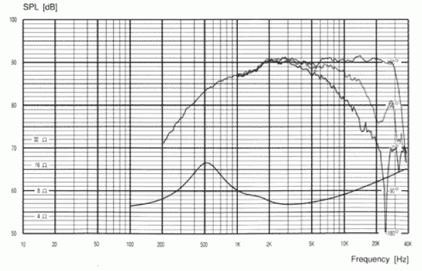

Here's the chart from ScanSpeak for the 9500 tweeter for on-axis response, 30 degrees off-axis response, and 60 degrees off-axis response.
The response of the 9700 is pretty much identical.
http://www.d-s-t.com/main/index.htm
You be the judge. Good luck.

That chart is a little fuzzy over here, can't really read what it says (mabye it's my monitor), but is that good or bad for off-axis response? The domes will be going in the kickpanels of my car with probably an average of 40% off axis for the drivers seat and pretty much on axis for the passenger...
It's a little below average for a one inch dome tweeter. 20 K Hz is the theoretical highest frequency hearable. 15 K Hz is the highest most people actually can hear.. At 20 K Hz, the 30 degree off axis response is 12 dB down. It's about 5 dB down at 15 K Hz. At 40 degrees off axis, it will be more. I think for a car, you will probably be okay at 40 degrees off axis-you'll probably be just a little softer on the very high frequencies.

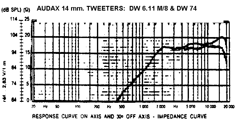

Dug into my "archives", (okay, actually just an old looseleaf binder), for some frequency response charts for some old models of Audax 10 mm and 14 mm tweeters. Although Audax now has different models, the frequency response, both on-and-off axis, should be similar.

And now for the 14 mm tweeters. Just a bit behind, but still very good. Only about 2.5 dB down at 15,000 Hz. The Scan Speak 1 inch was about 5 dB down at that point.
Remember, these are old Audax models, but the newer models should have similar off-axis performance.
Audax recommended you cross over these 14 mm models at 4500 Hz.
