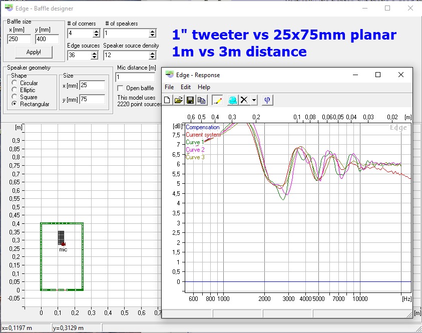

Those things are planar radiators, so any directivity modeling program can give rather reliable results, eg. The Edge. Many of them have more ripples above 10KkHz than simulations show because of the mask/frame where membrane is. Because they mostly are rectangular, vertical dispersion is usually different (and more aggressive) than horizontal.

Both have no directivity in low end! Was the 9' measurement done indoors? Then it could be "more boundary reflections with dome" Line arrays keep similar response to far-farfield because of radically different pattern, but difference between single planars and domes I don't believe that this works.
If we believe in Edge (and why shouldn't we), the difference of 25mm circle and 25x75 planar is minimal. A dome is not that different animal, but sure it radiates more to 90¤.

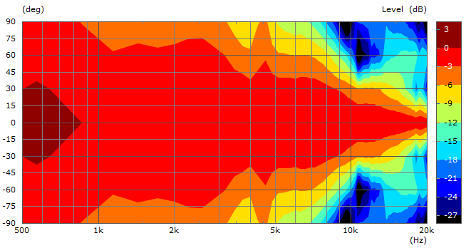

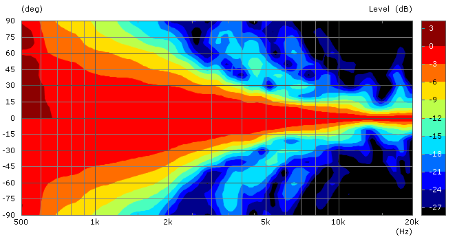

Directivity of an AMT/ribbon only depends on the dimensions of the radiating area. Here is an example.
Dayton AMTPro-4 without faceplate
Horizontal (3.8 cm wide):
Vertical (14.5 cm long):
The Beyma TPL-150 looks very similar without the horn. It is just a bit shorter.
It is generally not true that ribbons have a wide hroizontal dispersion. The Dayton for example starts to beam above 8 kHz which is a result of its pretty large width of 3.8 cm (1.5"). Below that the enclosure's dimension are responsible for directivity (in this case the naked driver). Build in a larger enclosure the dispersion will change, but the beaming above 8 kHz will not.
