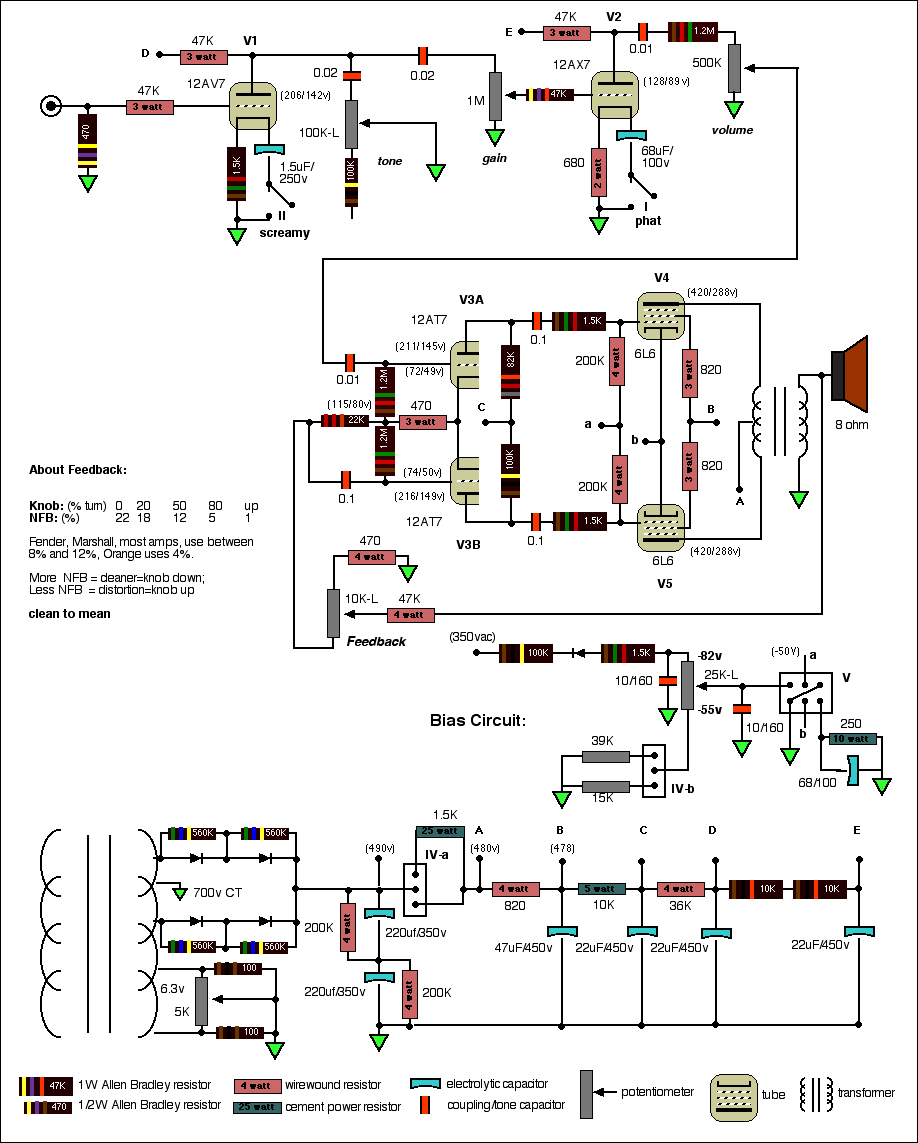

Well, yellow and green would normally be 8 and 4 ohms and black would be ground but I'm just guessing. What about the global feedback loop? Did it have any? As for the strange current readings....are the tubes fixed biased? A schematic would help.
here is a schematic...
That's what I thought wrt to the colors. The power stage is the like the bassman, and the feedback is variable to adjust for amount you want back into the phase inverter. I have both fixed and cathode bias on a switch.
The voltages on the schematic are from another amp and was the targets. The only ones on that page that are correct are the ones on the power supply, plate and screen voltages.
In cathode bias it is really off, so I have only been trying to get it working in fixed so far.
**ignore the -50v in the bias part, it was a target also...

in fixed it is set to vary from -55 to -82, in cathode I'm not sure I checked that, there was 34v on the cathode if I remember.
The other amp I built, clone but only cathode biased, only had 420 volts on the plates. This one has 480. Not sure if that's part of it.

31 Watts plate dissipation for the 6L6 is too much. Increase the value of the cathode resistor. Maybe you cooked the tubes while in cathode bias, did you notice red plates?

Well I'm not sure what the problem was, but I do have the current running 'balanced' in the tubes now. With my adjustment pot I get from 51mA to 19mA which is exactly where I want it. The plate voltage is about 460v so that 51mA is right on the edge.
I increased the cathode resistor to 440 ohm and that works great. I have about 40v on the cathode pin.
The only thing that's strange is the speaker taps. The yellow seems to be 4 ohm. The amp really sounds bad, buzzes weirdly on the front of the picking when I'm using that one through an 8 ohm speaker. I switched to the green tap and the clarity is much better, louder and does not buzz.
