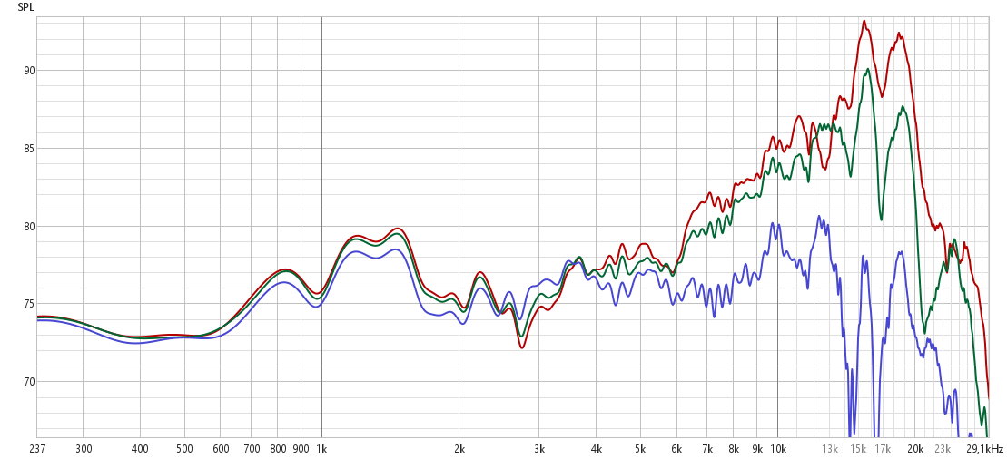

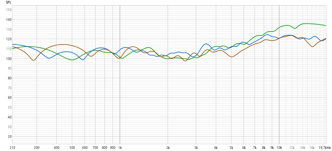

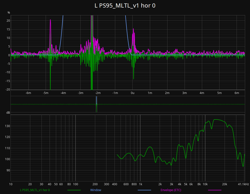

Thank you! Have seen this one - that visually "small" bump is pretty big, in the 4dB level - which is very likely true according to my measurements.
I have found also some .cal files on audio forums of the the same model microphone I am using, but they had very different curves, no such bumps.
What software would you recommend to build .cal file from scratch? Text editor?
I would assume, that it's intended use is for room EQ, where the frequencies of interest are <2kHz, so nonlinearity >5kHz is not incredibly important.
The opposite: I am most interested in all the range including up to 10-14kHz. It will be used to measure 2-way bookshelf speakers I am designing from scratch.
