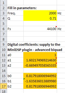

All-digital-coefs (HPF, Z1:Z3):
b0 0.979837613667748
b1 1.959675227335500
b2 0.979837613667748
a1 -1.60217496921463
a2 0.66949705856534
easycalculation:
a0: 0.8179
a1: -1.6358
a2: 0.8179
b1: -1.6022
b2: 0.6695
earlevel:
a0 = 0.8179180069449915
a1 = -1.635836013889983
a2 = 0.8179180069449915
b1 = -1.602174969214631
b2 = 0.669497058565335
BiquadFilterView (freescale):
b[0] = 0.817918006944992
b[1] = -1.63583601388998
b[2] = 0.817918006944992
a[0] = 1
a[1] = -1.60217496921463
a[2] = 0.669497058565335
I haven't seen any complaints about that coefficient calculator sheet - does anyone know what might be going on here?

You don't mention f0 for your HP, but looking at the values it was 2 kHz. You are looking at the wrong place on the sheet, the values you are looking at are not normalised to a0. The spreadsheet gives the same values as the others you tried if you look at the normalised results, aside from the change of sign required when feeding the miniDSP:
