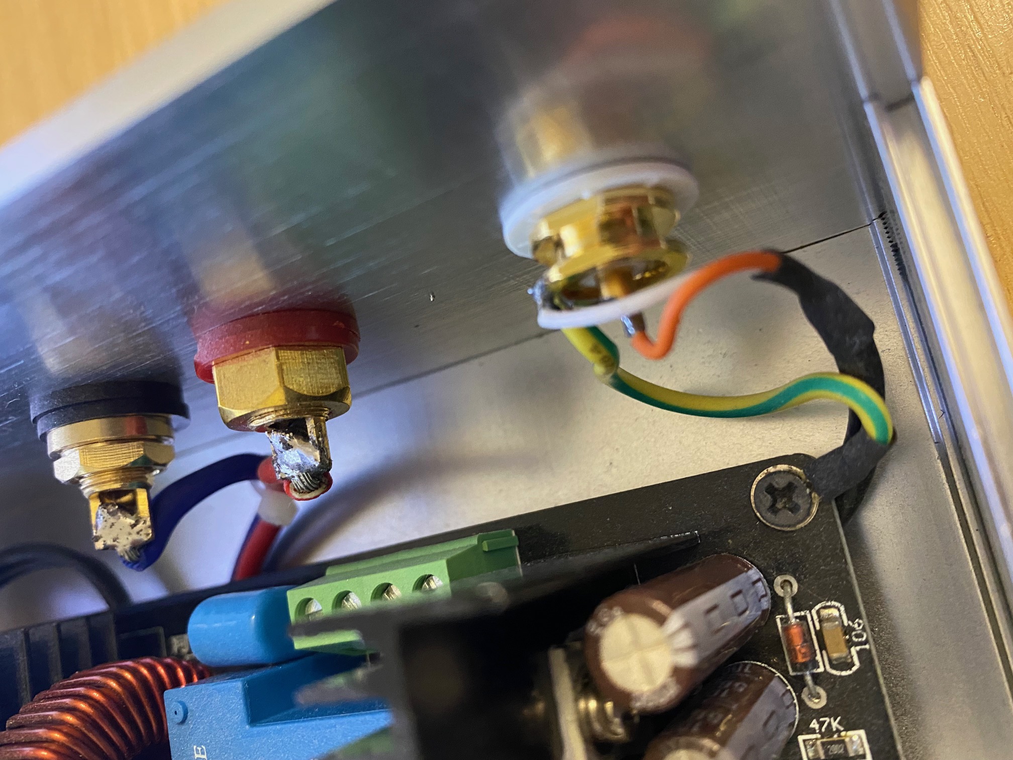

I have a weird problem with a pair of eBay special monoblocks I bought a couple of years back. They are silver shoebox cases using IRS2092 and IRFB4227 boards of a type I suspect folk are familiar with.
These amps have relays for activation / output, and these relays happily click and beautiful sound comes out of my esoteric Vienna Acoustics Beethoven speakers - provided I leave the case off each amp 😕

It's likely you create a ground short with the case. That often happens when the input and/or output plugs are connected with the ground/case. Especially the outputs have to be isolated (yes, the - too!). Ground loops with multiple ground connections should be avoided anyway.

That makes a certain amount of sense. I have a big pack of nylon washers somewhere...
I do wonder whether this was really their intention...
For spacers on boards I didn't made myself I usually use nylon ones. For my own or boards which do not have ground connected to every mount hole, I use brass ones because they are more rugged and stable, sometimes a requirement for a heavier board (ie. with on board heat sink and fan, big chokes etc).
Plastic washers are sometimes really a game changer, when I buy speaker terminals or RCA plugs I always get the ones which already bring isolation spacers with it. For the ones which lack these spacers/washers there is still the possibility to mount them on an isolated plate or plywood part or get plastic washers from the hardware store.
