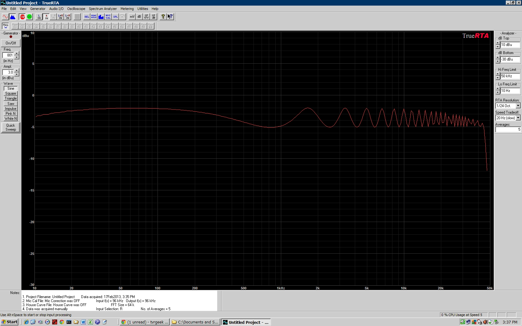

Doing a loop-back test with my M-Audio Profire and TrueRTA. Rather strange interference happening. I have not seen this with any of my previous boxes.
I get ripple. Lots of it. If I do a single channel Out 1 back into the front Instrument ( center of mic) It is fine. If I have both 1 and 2 going into input 1 and 2, this is what I get. Or if I have output 1 going to both inputs 1 and 2, I get the ripple. But if I have the output 1 going to input 1, and a mic in input 2, all is very good.
With the LIMP/HOLM/SoundEasy style impedance speaker jig, this is essentially how it needs to operate.
Any ideas?
