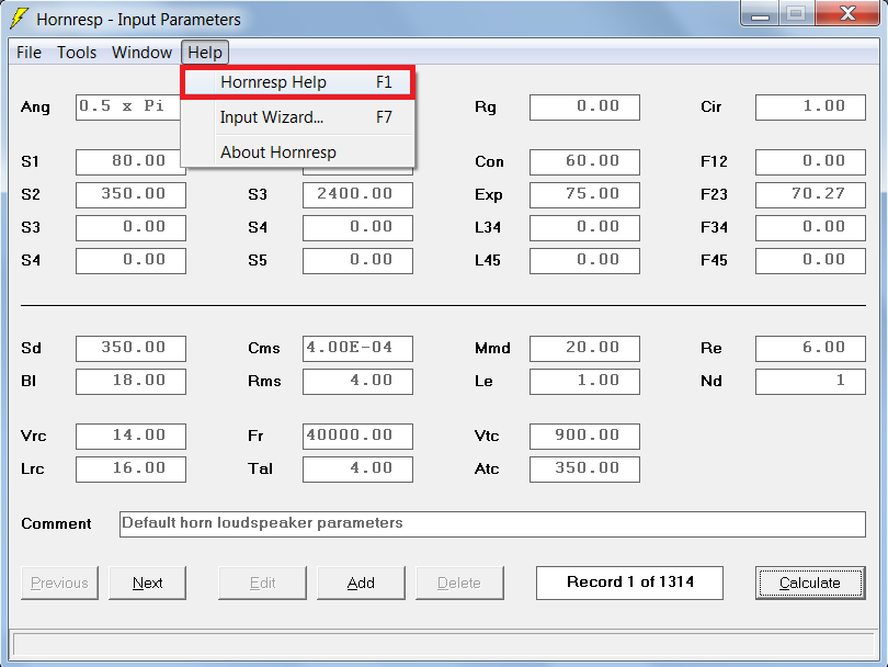

I have tried to sim a TL subwoofer enclosure that HR calls an axisymmetric design.
Essentially a box with a pipe sticking out of it (at least I think it is; that is what it looks like).
The odd thing is I have input two different S3 variables and the programme has accepted that and calculated it.
See the attached, ignore the highlighted S4. And ignore the Comment too; the driver is RSS265-HO.
I'm not sure exactly what's going on here. Can there be two different S3 values??

Okay, I think I have kind of sorted it now.
I had double clicked on S1 which had turned the S numbers red. Returning the S1-5 figures to black and it solves the issue.
Also, in the schematic diagram it changed the form of the S2 to a negative flare horn segment.
Not that Im all that much wiser as a result.

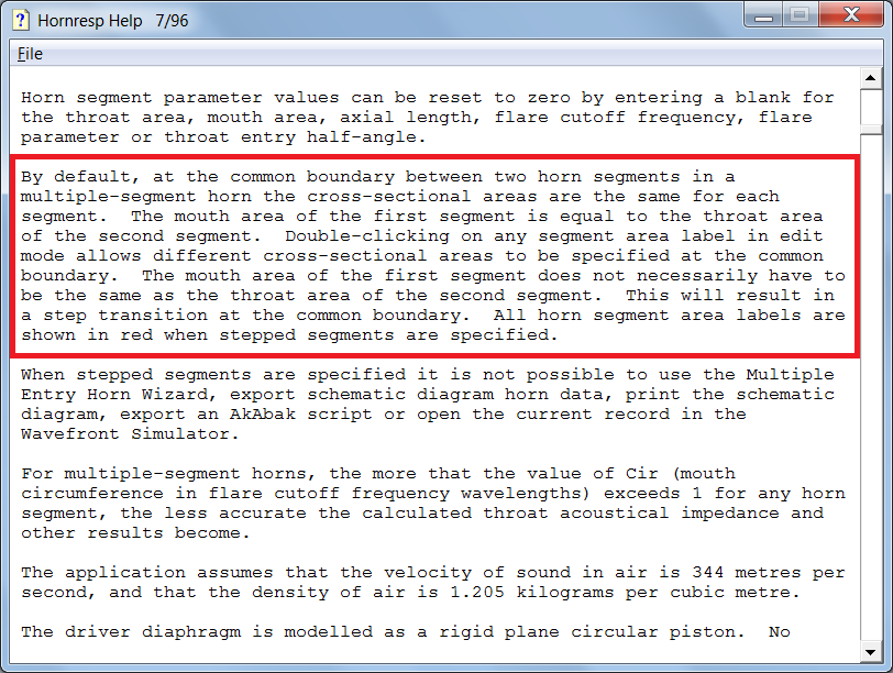

When stepped segments are specified, yes.

I tried to access the Help section of HR
FWIW I converted mine to a Wordpad file, so I could change font/size/spacing for easier reading, add highlights, notations, etc..
