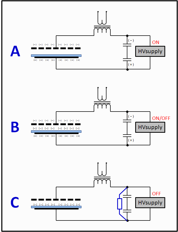

A capacitor needs two conducting surfaces separated by a dielectric which can be air, some material, or a combination of both. So, I don't think a capacitor within a capacitor is really relevent to your situation since you don't have conducting surfaces on both sides of the mylar the way geraldfryjr had in his test panel.
See the attached figures for a simplified explanation of what is going on.
(A) When you first turn on the HV supply, the HV capacitors charge and their voltage levels are transferred to the ESL stator and diaphragm. These voltages levels placed in close proximity to each other result in attaction between the metalized layer of the diaphragm and the stator. The figure shows the diaphragm a distance away from the stator(for ease of drawing), rather than stuck to it which is what happens.
(B) Over time, the mylar starts to pick up some charge from the stator it is in contact with. Once it builds up to a level similar to that of the charge on the metalized side of the diaphragm, the attraction between the metalized layer and the stator are offset by the repulsion of the static charge collected on the mylar. Turning off the HV supply will make little difference in the situation until the supply capacitors are discharged.
(C) Discharging the supply capacitors with a resistor removes the charges on the stator and metalized side of the mylar as well. All that remains is the static charge on the mylar. This static charge will drain off over time depending on the humidity level. As you found out, the retained static charge will cause it to be attracted to pretty much any object.
If you had the required test equipment, you could also see that the phase of the sound output is reversed in (C) relative to (A).
So, why did the paper insulator fix the problem?
Because it is not as good an insulator as mylar and charge was bled off about as quickly as it built up.
Similar charge retention problems will be encounted with more traditional push-pull ESLs with insulated stators if the insulation material is too good of an insulator. Strickland experienced this when he was experimenting with different types of insulation for the Acoustat stator wires like PE/Teflon. The fix was to switch back to the Janszen patent recommendation of PVC.
“…Strickland told me once that he'd seen lab speakers that actually played louder after power down of the bias supply than before (for a while anyway), and sometimes he observed audio phase reversals at that time too. This was all with PE before he switched to nice leaky PVC. Weird science…”
http://www.diyaudio.com/forums/planars-exotics/58407-insulated-vs-bare-metal-stators.html#post658044
Note that even PVC wire insulation retains a small amount of charge that will "power" the ESL for a while at much reduced sensitivity if the HV supply is removed or disconnected after having been left on for 24 hours. As with your single ended experiment, the phase of acoustic output is reversed. If you have a variable supply, it is interesting to turn it back on and slowly increase the voltage. Instead of SPL increasing, it first decreases, reaches a null point, and then increases asthe HV is brought up to normal operating level.

Yes, Thank you for verifying this for me Bolserst!!
It was the only logical thing that I could figure.
I have experienced all of the things that you and Strickland had described.
I now have to determine if running a 9kv Bias as oppossed to running a 4.5kv Bias is worth doing as it does make a difference in sensitivity.
I know that this has been discussed before, But I guess I am going to have to setup a test on this some how at a later time.
Now that I have figured out a stator coating that can handle such voltages I have to compare the sensitivity to one that can't, under the same driving voltage conditions.

1) I have been using the term "mylar" as a generic. I am actually using plastic foil of indeterminate origin sold in hobby stores for gift wrapping. It is remarkably thin and light with a mirrored appearance that is slightly transparent when held up to a bright light. My stator is a small piece of very smooth perforated metal (fairly magnetic, presumably steel). There are no rough spots or jagged perforations, which I realize can be an issue with higher-voltage designs. As far as I can tell, this setup is very similar to the early ESL tweeters that used to come with console radios.
2) I noticed that my bias supply (voltage doubled wall current coming off of a 1:1 isolation transformer) causes a slight hum and some static when using either the plastic diaphragm or the foil/paper combination, but it is much more pronounced with the foil/paper diaphragm. This surprises me in either case since I wouldn't expect any appreciable amount of current to be drawn by the bias supply.
3) As predicted by bolserst, I can "reset" the plastic diaphragm to a neutral charge by exposing it to a humid environment (steam from the sink).
4) After a few days of handling the plastic diaphragm, reversing polarity, discharging the supply, and generally abusing it, it seems to become inert, hardly responding to bias voltage of any polarity and suffers dramatically reduced sensitivity to the audio signal. Holding the diaphragm to the light sometimes reveals "ghosting" of the stator holes, presumably where the aluminum deposition has thinned for some reason.
5) I experimented with replacing with the DC bias supply with a self-biasing arrangement consisting of a second step-up transformer connected to secondary of the audio transformer that is subsequently voltage-doubled. This actually worked quite well for louder passages, but turning down the volume quickly caused the bias to droop (the slackening of the diaphragm was clearly visible). I would have expected the bias to stay at the level set by the loudest passage, at least for a while. If my plastic diaphragm is such a good insulator that it is becoming polarized by simply being in contact with the charged stator, as in bolserst's explanation, I would have expected it to happily hold the momentary bias charge for a considerable amount of time.
None of these observations are really in any logical order, they are basically just my lab notes. At the end of the day, my goal is to stabilize the system so that every time I plug it in, the plastic diaphragm sucks itself strongly into the stator and stays there until the bias voltage has been removed. If I really am barking up the wrong tree and my materials simply aren't up to the task, I'd be willing to accept that, but I feel like I am very close to figuring this out.
Thanks in advance for any insight people can share. This community really is an incredible resource.
-Nick

Your observations seem to show that there is some amount of current flowing.
You should try putting an ammeter in series with your power supply to find out exactly how much current is flowing.
Or if you have a scope you can see how much ripple there is.
Being that it is a Single Ended setup the hum caused by the ripple will be more pronounced because you don't have the second stator counter acting the force of the ripple voltage on the opposite side of the diagphram.
3 and 4.
This has basically already been discussed.
However, I should note that in a study that Beveredge had written, the corona does tend to eat away the aluminium coating on the surface of the film.
Another example that I have found was on TAC (The Audio Circuit) back in 2000 to 2003 by Willy Lefebvre ( I think was his name).
He used two Diagphrams one on each side of a single central stator kind of like an Isoberic setup if you will, This worked well.
http://www.audiocircuit.com/DIY/Electrostatic-Speakers/Project:Central-stator-ESL-by-Willy-Lefebvre
Later on I had found his websight and his update was that part of the aluminium coating had been eaten away after a while and so he had choose not to rebuild them using this method construction and choose to follow traditional methods after that.
It took a lot of digging to find that info quite a while ago and recent searches for another follow up has not been fruitful, as many of those older sites and links are now defunct.
Also recheck your connection points as I had mentioned earlier for the above reasons.
A visual inspection is not enough I am talking about continuity here.
Also any kind of bodily fluid by handling the panel is sufficeint to cause a path for the charge to leak through.
Especially along the edge sides and believe it or not this is where most all of the failures of even the commercially built panels occur, due to leakage paths along the edge.
5.
The self biasing techniques have been used in the past and been tried by many, It simply does not work well.
IMHO, In order to make it even remotely work well you would need to take the signal and clip it to no more than a .1v p-p signal and multiply that into your required bias voltage.
Although, Even a .1v p-p input signal can be heard very well.
Not to mention the clipping action will probably be heard too as it is can get imposed on the original passing signal.
