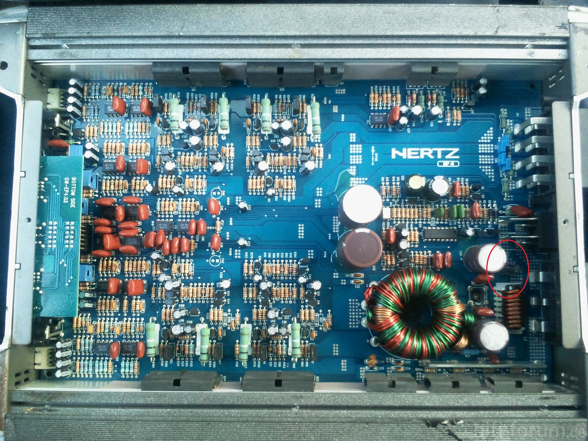

I had a look further. It has the issue on all 4 channels, which going off the schematic, and common sense, means it has to be the PSU. I guess it would be a fairly logical and straightforward first step to recap the electrolytics in that section. (I do have a scope to probe it out, but I haven't used it for a few years - which means it is in a fairly inaccessible strata in the garage)
There is one big issue though. See the linked photo. How on earth do I remove the heatsink spring clips? I can't even really pry the bigger ones up at all with a screwdriver, never mind move them. I could Dremel them off, but the swarf would probably mean the whole thing would need a run through the dishwasher. Then I would have to thermal epoxy them back down...

Sorry , to me at least its a bit dark in your red circled part of the photo and not large enough.
Jl audio 500/1 Transistor clamps
Recapping, if the caps show no signs of leaking or venting, is likely a huge waste of time.
That said, if you see a lot of high frequency ripple on the power supply rail voltage, that would indicate that the rail caps are open or out of tolerance.
