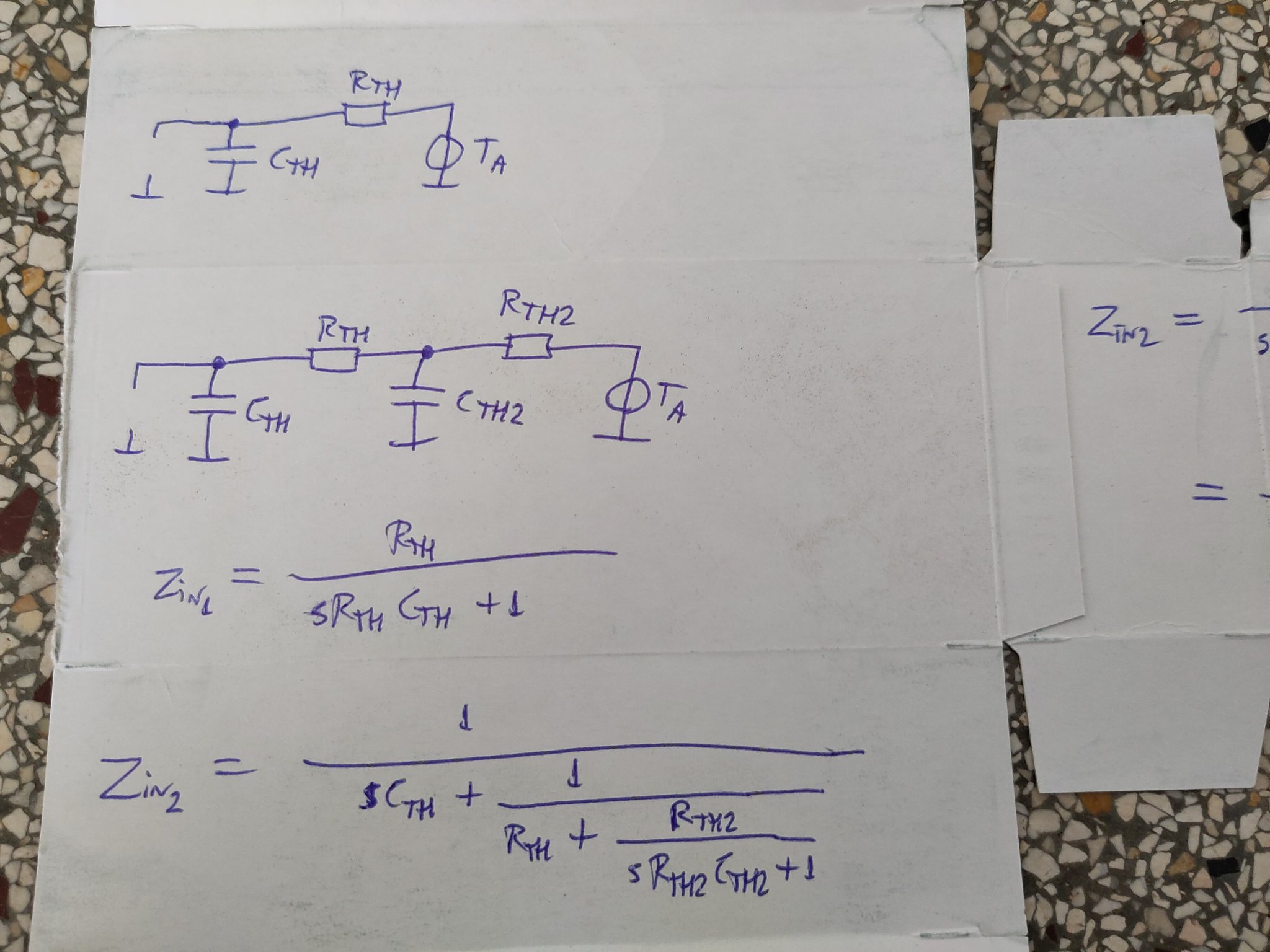

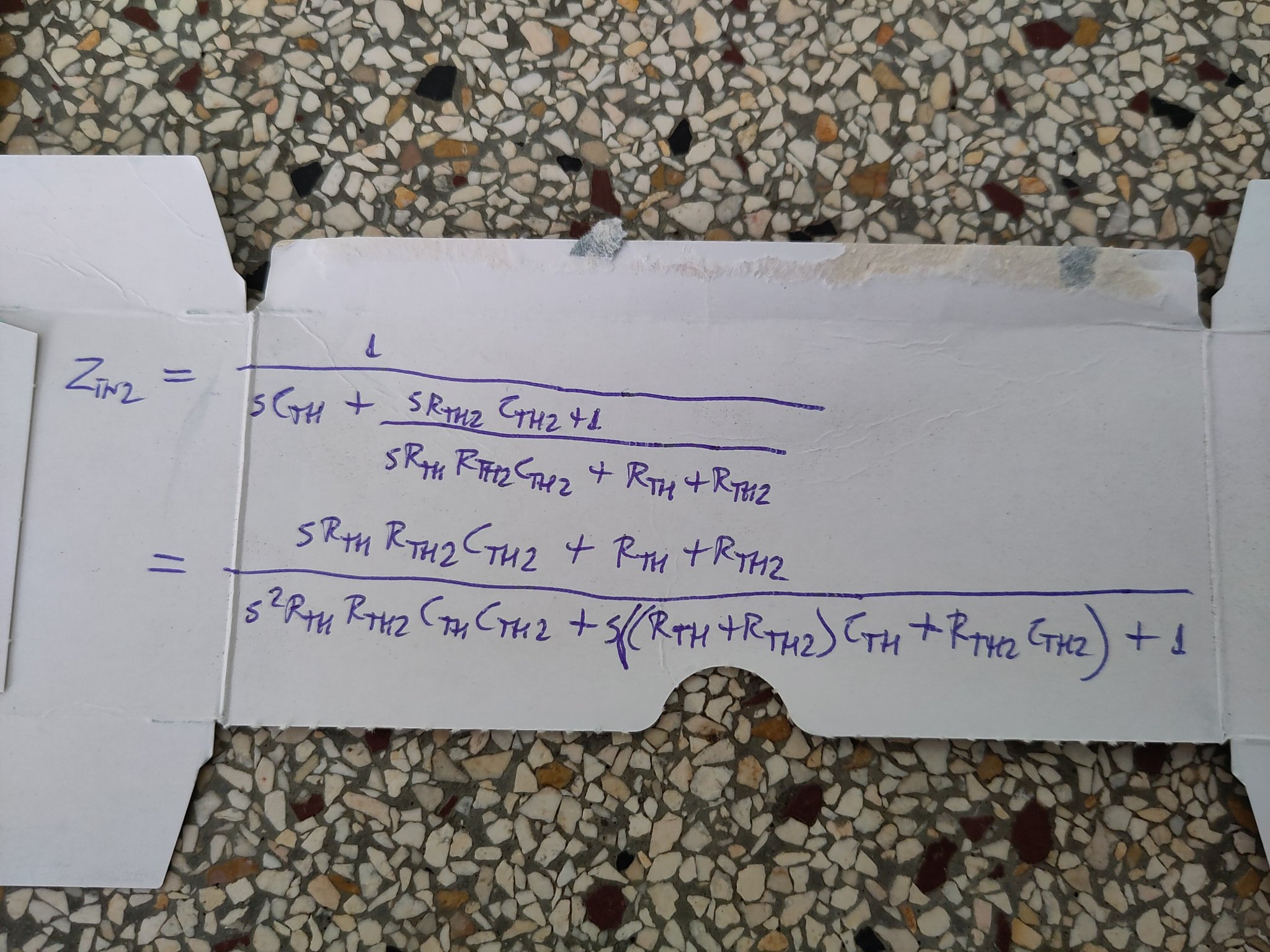

By the way, when I was at university, there were two people there working on some oven-controlled measurement set-up that had to settle very accurately to the set temperature in limited time. They found that after they had added some extra thermal capacity and thermal insulation to protect their temperature chamber from external temperature variations, it would settle very slowly. That is, it would quickly get close and then the final settling would take long.
The explanation we came up with, was that it was due to the extra pole-zero pair in the heat to temperature response caused by the thermal insulation and capacity. I'm not sure if that was the correct explanation, as thermal networks are never really lumped, but it was the best we could think of.
The first network is without extra insulation, the second with. To the extent that the lumped approximation applies at all, you get an extra zero. Under closed-loop conditions, one of the poles will end up close to but not quite at the zero, and this pole results in a long settling tail.
I don't remember many details, as it is some 30 years ago.
