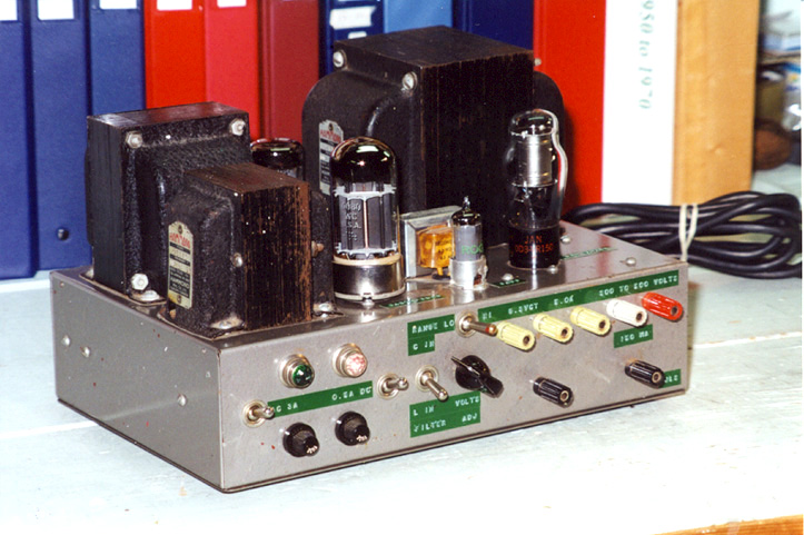

50W Amp with in Chassis Screen Regulator
This one is PP 6550s or PP KT88s. The B+ is about 500V, the screens regulated at 380-400V. The screen regulator losser is both sections of a 7AU7, the error amp a 6AU6 & the reference a 991 Neon Regulator.
The 7AU7 heater is parallel connected for 3.5V operation thru a dropping resistor from the 5V rectifier winding. The HV rectifier is a 5AR4.
The 6AU6 error amp is visible inside, behind the center of the front panel. It & the 7AU7 are on a brass plate with some of the regulator components.
The iron is mostly Hammond from the mid-50s. This I built circa 1956.🙂
