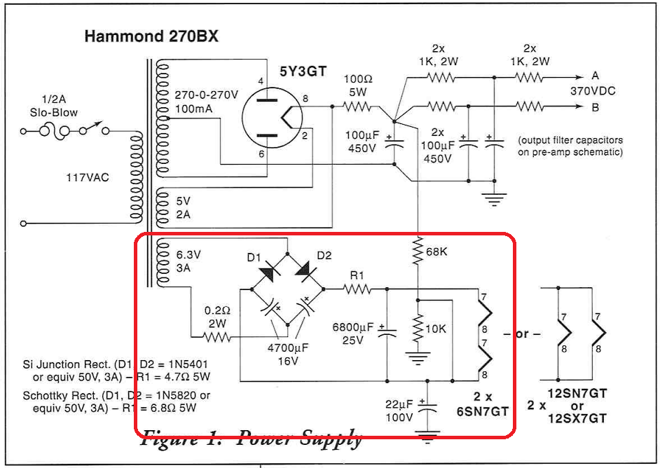

I'm looking for a preamp thhat can provide higher drive for a SET amp with a single stage driver.

I see a gain stage in front of a CF. Doesn't look much different that what you're building.It's a tube buffer project that has unity gain and easy to wire by hand, no PCB needed.

The through write-up in the web page seems to indicate that putting the volume control at the end of the circuit changes the output impedance, which may be suitable for the amps @Freecrowder is trying to drive.
