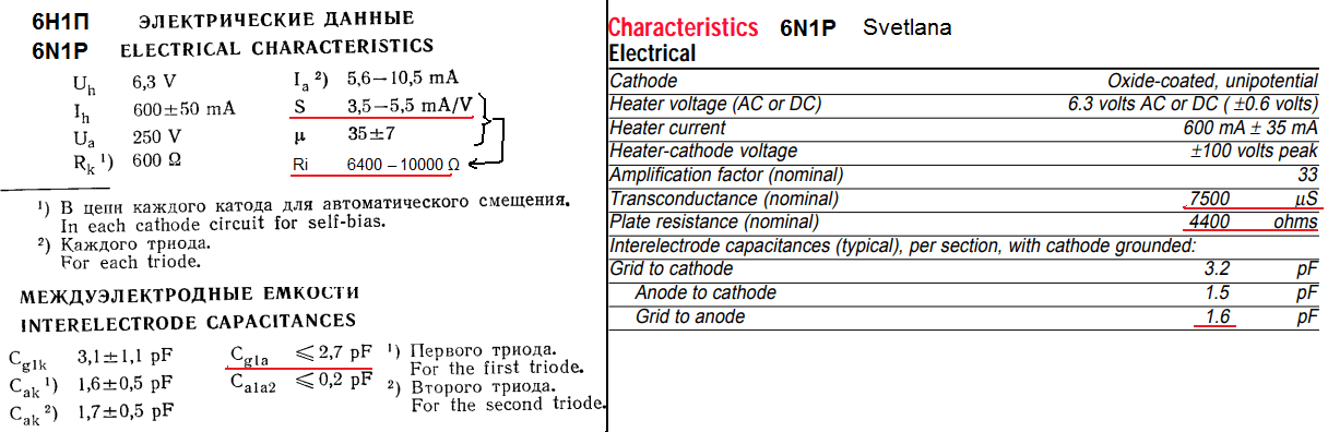

Actually, 6N1P has an Rp of 4400R...A 6N1P has a plate resistance, rp of about 7700 Ohms.
https://web.archive.org/web/20070707054433/http://www.svetlana-tubes.com/pdf/6n1p.pdf
Actually, I own quite a few Svetlana 6N1P tubes.
And I have the Svetlana 6N1P data sheet too.
The Svetlana data sheet is wrong. The u (Mu) is correct.
But they Swapped the numbers of Gm and plate resistance, rp. (swapped the numbers, but not the units uMhos and rp).
Svetlana had that error, and never corrected it; then they went out of business.
I have mentioned this before on various threads on Tubes / Valves.
More than once, I built single stages using the Svetlana 6N1P.
The data sheet u = 33 At least the Svetlana data sheet got that correct.
I used a plate load resistor of 3 x 7700 Ohms (RL = 23k Ohms), the stage has a gain of 25.
Gain = (23k/(23k +7.7k)) x 33 = 24.7
The Svetlana 6N1P plate resistance, rp is 7700 Ohms (not 4400 Ohms as listed in the Svetlana data sheet).
And u = Gm x rp. 4400 uMhos x 7700 = 34
So the Svetlana 6N1P transconductance, Gm is 4400 uMhos (not 7700 uMhos as listed in the Svetlana data sheet).
I rest my case.
Just my measurement results, and my calculations.
Your probes and oscilloscope measurements may vary somewhat, but not so much as the Svetlana data sheet errors.

We need to remember that datasheet values are average values. The Russian 6N1P datasheet I use states u = 35 +/- 7. That's a big swing. Your specific tube may be anywhere in that range.
That, and you could have deviations high in one triode, low in the other triode- within the same bottle. Can be frustrating for some applications that count on roughly equal gain between sections for things like phase splitters without a CCS tail, or using one half per channel for gain and ending up with different volume levels.We need to remember that datasheet values are average values. The Russian 6N1P datasheet I use states u = 35 +/- 7. That's a big swing. Your specific tube may be anywhere in that range.
Another benefit to the cathodyne versus a long tailed pair is that things like this don't cause extra work.
Gm 4400 uMhos
rp 7700 Ohms
Or . . .
Gm 7700 uMhos
rp 4400 Ohms
That is 1.75 to one (if that is the spread of those tubes, that is +/- 37.5%
Any tube that has that much range, I throw it out.

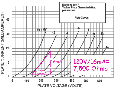

The Svetlana lists the maximum plate dissipation as 2.2 watts.
200V and 11 mA is 2.2 watts.
Look at Svetlana's own plate curves at this link, and graphically solve the Gm and rp for yourself:
https://datasheetspdf.com/pdf/1039296/Svetlana/6N1P/1
Yes, you can get higher Gm and lower rp, but only at voltage/current combinations that are higher than 2.2 watts plate dissipation. That means use it as a pulse tube, not an audio tube if you want those Gm and rp numbers.
I certainly tried more than one Svetlana 6N1P.
The Svetlana data sheet Gm and rp numbers are way off; but the plate curves are correct (it is hard to fool a curve tracer)
I used to have access to a Sony / Tektronix 370B curve tracer.
Your Mileage May Vary.
If you use 7700 uMhos and 4400 Ohms as your design guide, just be prepared to change the plate load resistor, and the self bias resistor, and be sure to Pulse the tube into the high dissipation area.
Just my opinion.
