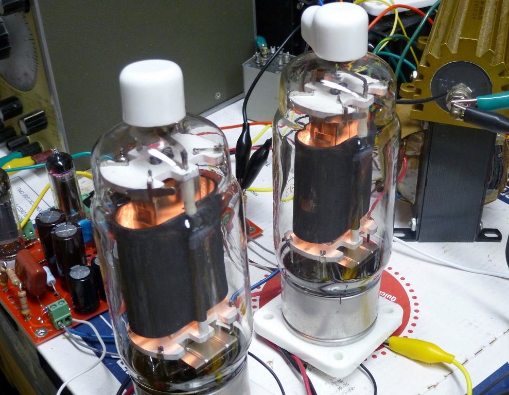

Most of the tubes mentioned in this thread are overkill for LTP duty even though they may work. It is possible to put a pair of 6HB6's into Pete's driver board, then wire the driver board directly to an OPT without an output stage and make a decent 7 watt amp. That was limited by the current available rom the CCS in the tail, a 10M45 with the current set resistor shorted.
With that, you can choose any appropriate output tube......

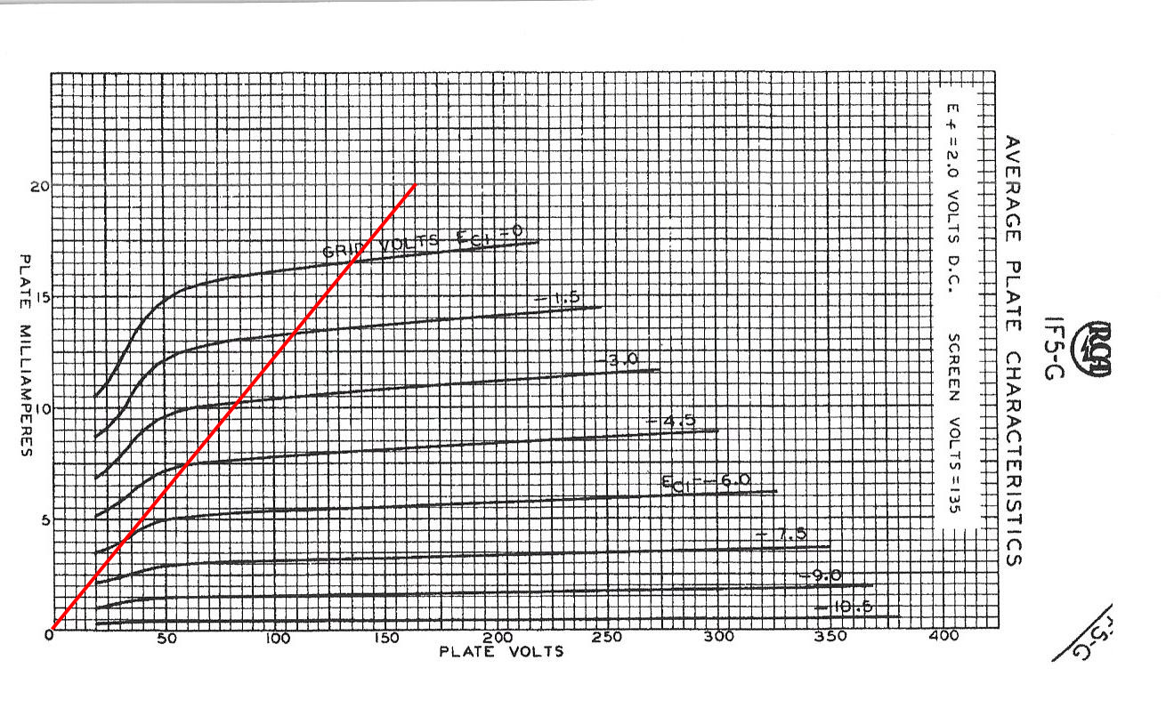

Here are some numbers calculated by the brute force method. When Smoking Amp does the tests of rp these numbers will not be far off. But they may not look as good, these tubes are now 70-80 years old.
About 20 yrs ago I did build a PP 33 Amp That worked very well. I did some gm tests, the tubes did not test to spec. They would have been 50-60 yrs old then.🙂
  • 1F4 1F5G Plate Family w Line from Origin to Equal Plate & Screen Volts.jpg
