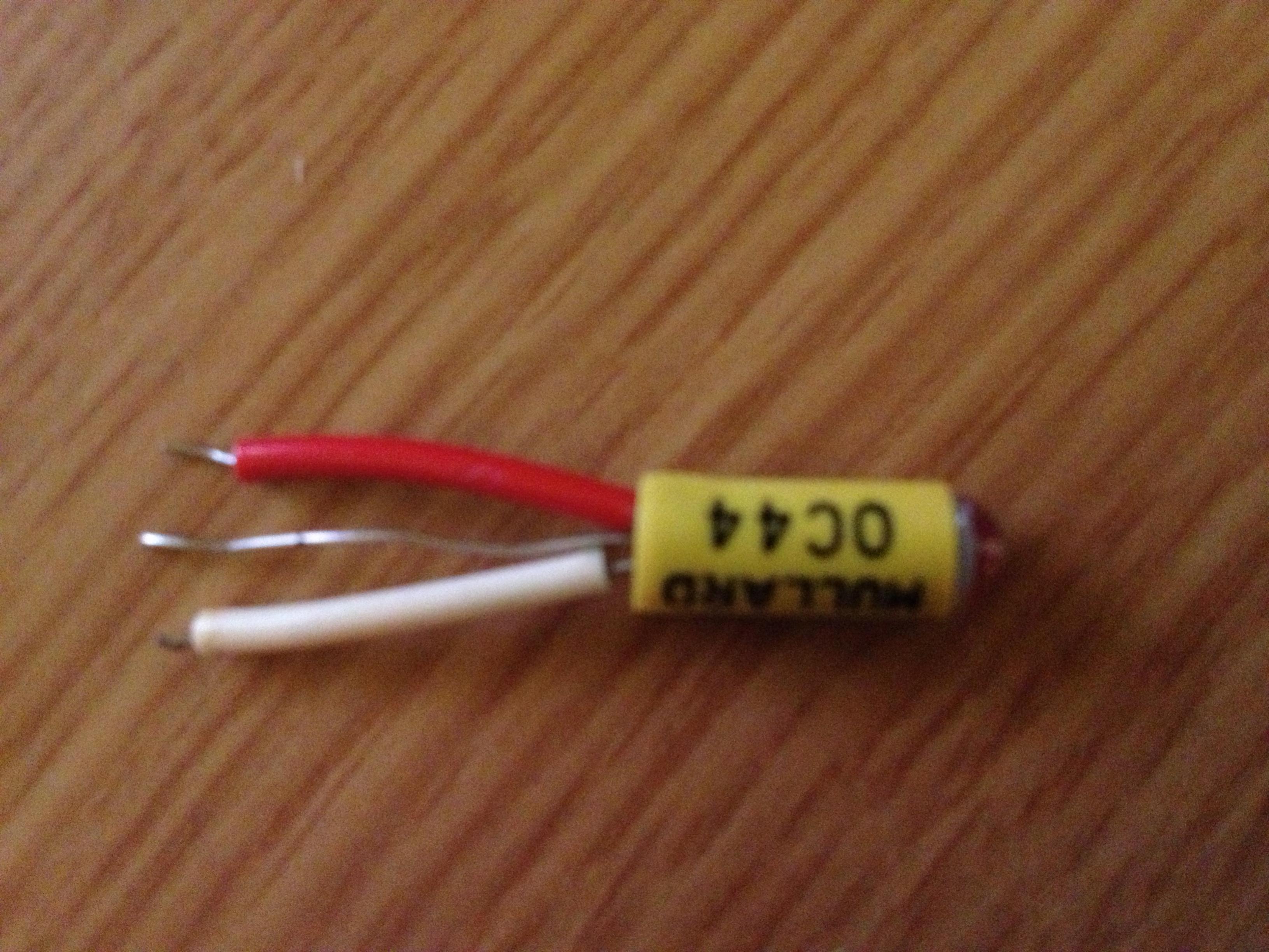

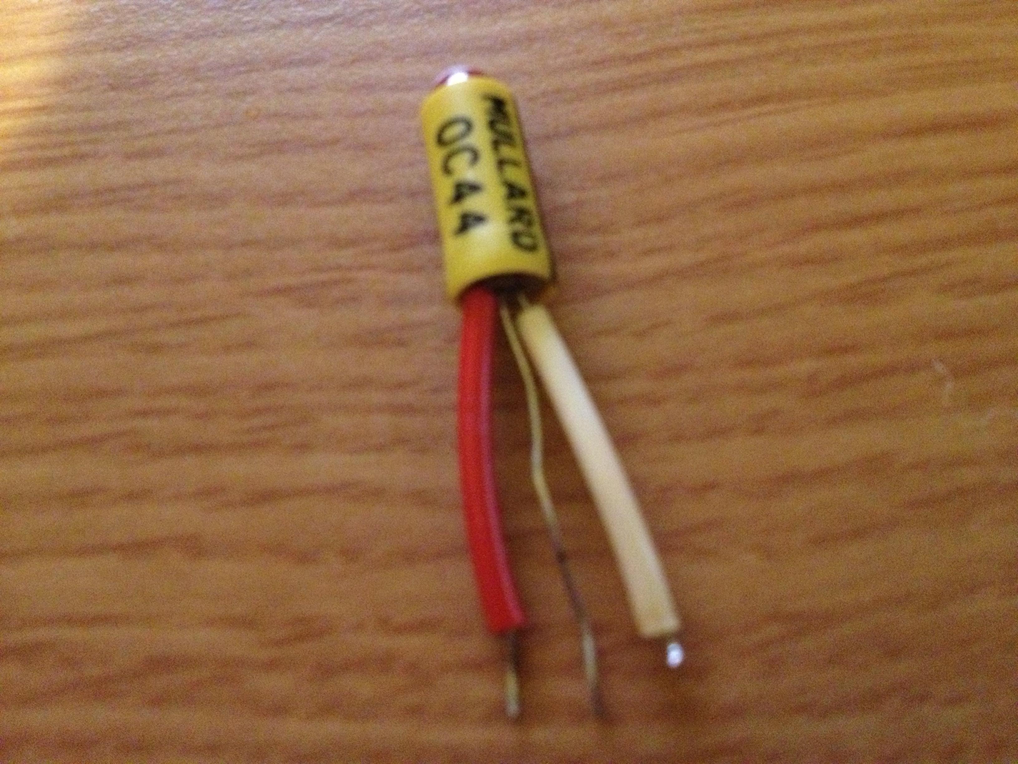

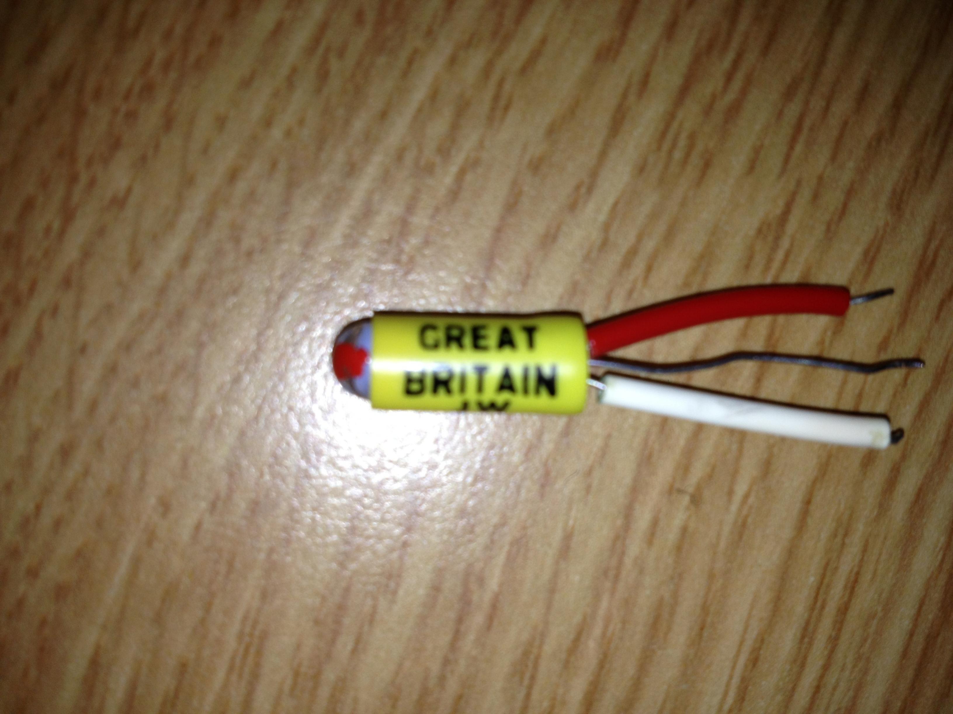

OC44 Yellow Jacket Pinout
I have acquired what I believe to be a yellow jacket mullard oc44. which appears to has a red dot at the top but not next to a pin. It comes from a radio. The centre pin is bare wire and the two outside pins are covered with (removable) insulation; one pin has white insulation (on the side of the oc44 with a black stripe), the other has red insulation. Can anyone tell me which pin is the collector, which the emmitter, and which the base,

Thanks for all the help. I will go for the one next to the stripe being the collector. It's separation from the center pin is also a little greater, which also fits with Bibliophile's link. One more question, how likely am I to damage it if I get it wrong and the collector up to the positive of a 9V battery?
Well I appear to have killed it. The way of connecting discussed above was correct. I was getting a readout which converts to 12uA leakage (is this possible, it seems strangely low) and a hfe of 70. Then I decided to messure current through the 2.2M resistor (apparently foolish). The transistor got very hot and is now basically an open circuit between collector and emitter. Oh well. Some you lose.

It seemed to be the attempted forward current measurement through the base resistor that killed it. I should read up on how the multimeters measure this but I'm guessing it may have been forcing current through the base that didn't want to be going through there
