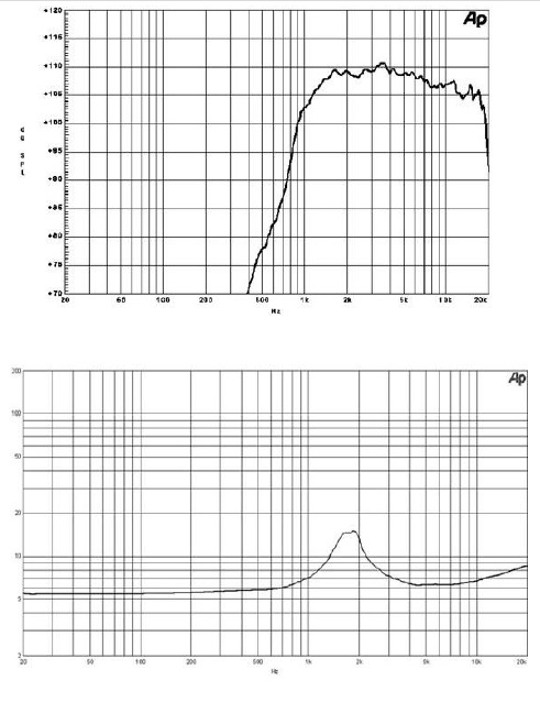

I downloaded the PDF & from looking at the fr/impedence graph i initially estimated fs @ around 1800 Hz to start working with.

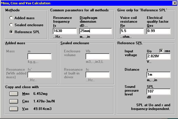

AkaBak etc

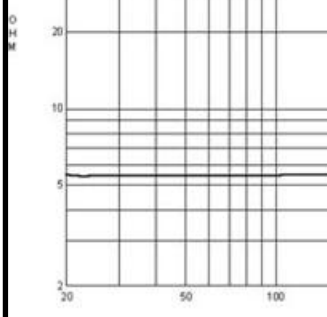

I found that one of AkaBak's useful features is the ability to get Mms & Cms & Vas from just a few numbers, as shown in my screenie. Inputting fs = 1630 Hz instead of 1930 Hz & Re = 5.5 instead of the PDF quoted spec of 6.3 seemed to better correlate with some of the other data gained via the other 2 programs.
Looking at the impedance graph in the PDF shows the DCR/Re is 5.5, not 6.3 !
Work in progress, but getting there, hopefully ;)

The spec sheet PDF saying the minimum impedance is 6.3 ohms appears to be the minimum in the usable pass band, as you say the graph clearly shows the LF impedance as 5.5 ohms.
The sensitivity rating, frequency response, and impedance graph don’t indicate the horn used, oh well...
