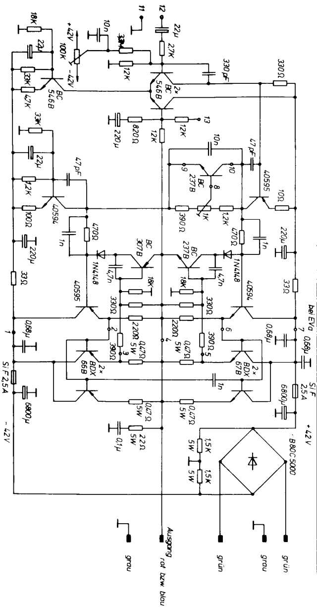

Hi: Anybody know any replacement for BDX 66 C and BDX 67 C Darlington
transistors?. My old amplifier
and here, in Argentina, there are not
more of this ones.

Rather difficult to find audio TO3 metal case devices ,
moreover if they are darlingtons type like these ones,
with good caracteristics.
You can try plastic cases TOP3 BDV64C/65C
if you cant find metal case equivalents..

slim pickins' in TO-3 Darlingtons. The TIP142,7 - etc. can be jigged into place, and work quite reliably.
two years ago I have order this types by farnell for repair a German power amp, brand "Kücke" (KS-Electronic, "Select" series), typ "E42" (see attached pictures of this model - it was the successor of "E41").
I guess, CPC-Farnell still offer this types - here some URLs about Farnell and an other:
Semiconductor: BDX66C (BDX 66C) - 20SI-P-DARLINGTON 100V / 16A / 150W
Semiconductor: BDX67C (BDX 67C) - NPN - DARLINGTON / 120V / 16A / 150W...
DARLINGTON TRANSISTOR, TO-3 - BDX66C - SEMELAB
SEMELAB|BDX67C|DARLINGTON TRANSISTOR, TO-3 | CPC
SEMELAB|BDX67C.|DARLINGTON-TRANSISTOR | Farnell Deutschland
http://igbt-module.wikispaces.com/S...uits+Manufacturer+exporting+direct+from+China
The electrical difference between E41 and E42 was only the amount of output power devices: 2 pairs vs 3 pairs.
BTW - he associated pre-amplifier V32 looks also nice:
KS-Kuecke V32, Preamplifier
What is your amplifier brand/model?
