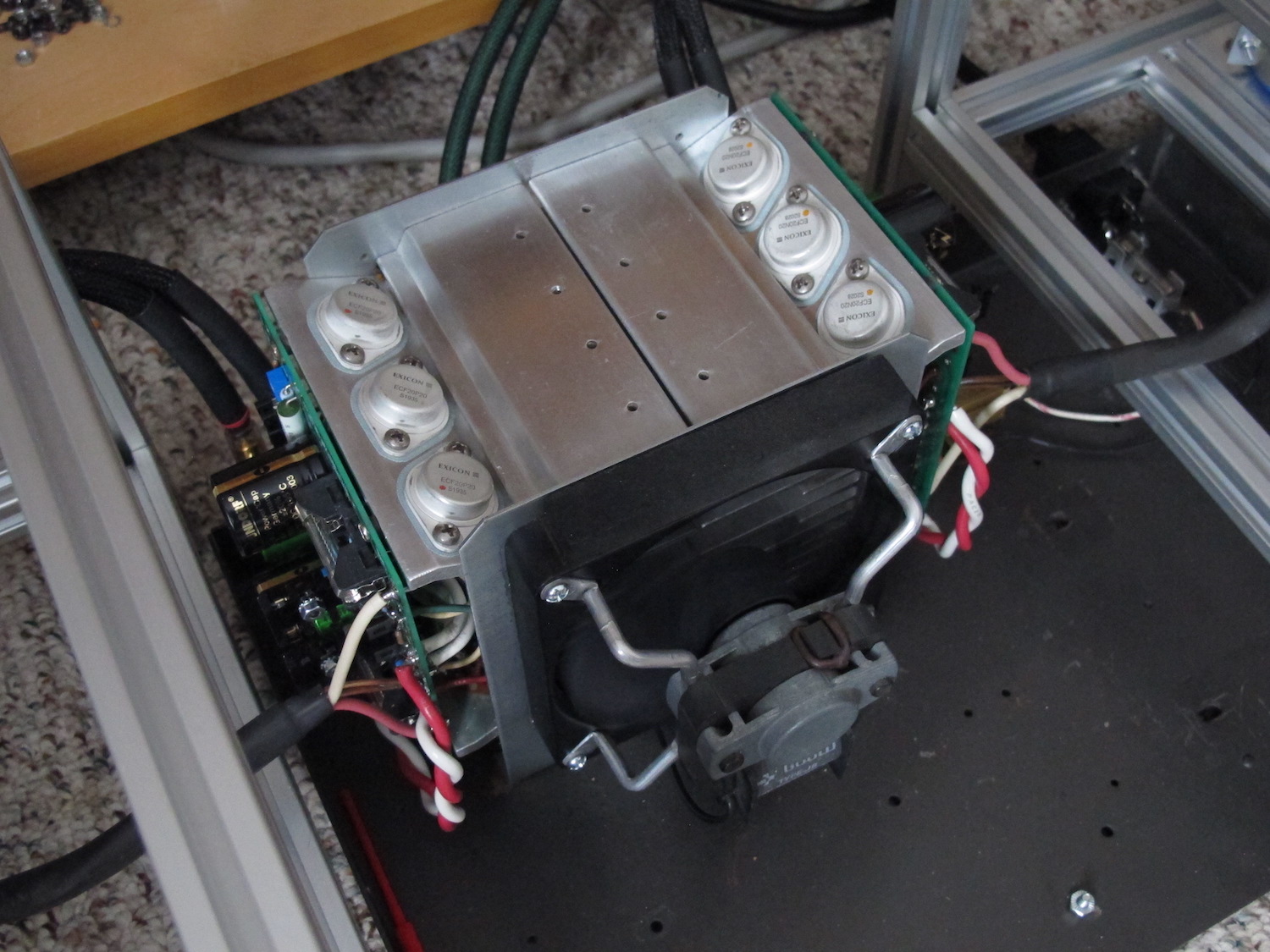

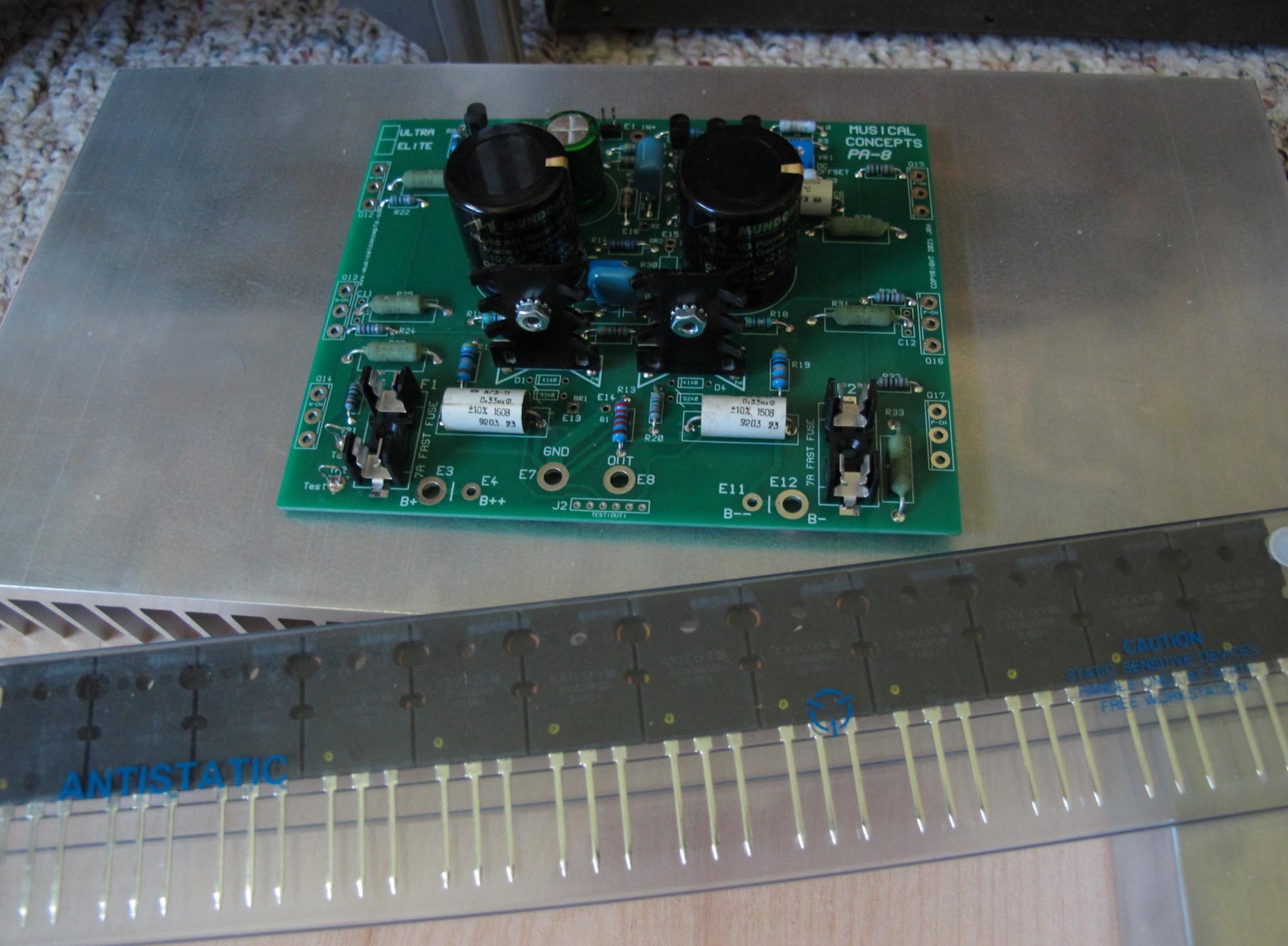

I am about to complete a few amp design / builds... have built and extensively tested my power supplies. Image 1. The next step is to attatch amplifier modules (Musical Concepts PA8 driver PCB, outputs and heatsinks) Image 2
I am using the dual die Exicon MOSFETS and want to maximize dissipation, with high'ish' bias setting / requirements, for 12 x 6 x 1.5 heatsink size... practical amp chassis sizes.
I am still on the fence between Sil Pads, or Mica / paste. Each having practical advantages. For me, the seemingly higher temperature gradient (25-30 degrees) between the output devices and the heatsink seem high with *green* Sil-Pads, leads me to question/concerns.

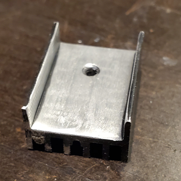

Hey that's a pretty cool concept. If it were me because I like to live on the edge, I wouldn't use insulators at all. The heatsinks are separate so they can be live. I would probably go with a finned U-channel heatsink design that you can flat sand down the middle.
attachment.php
(this one is a reject but you get the idea)
IF I had to chose between thermal pads and the method above then hands down I'd go paste/mica/paste. The layers are so thin and perfectly connected that there is very little thermal resistance at all.
Also if you're daring like me then drill some small holes through the circuit board where those triangles are to allow air to flow through them.
Disclaimer: I'm far too pragmatic to be scared of board butchering and I'm willing to take the risk. To each their own.
