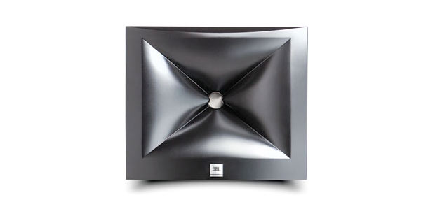

The trick with the Image Control Waveguide is that there's a horn nested inside of a horn. One horn has a diffraction slot. The other horn doesn't.
It's a real p.i.t.a. to render, particular if you're listening off-axis like I am.
A conventional diffraction slot has a sharp edge that creates diffraction at the transition from the slot to the rest of the horn
I'm using a gentle radius to reduce diffraction
Here we have two horns, identical in size, one with a diffraction slot, one without
The two horns are nested together, and there's an "X" that's pressed into the orthogonals. The "X" shape allows sound in the diffraction slot to radiate into the rest of the waveguide, but not 100% of the sound. This creates numerous pathlengths, I think this is partially responsible for the ridiculously smooth response of the JBL M2. If you think about it, all horns are resonant. The Image Control Waveguide behaves like a spectrum of horns, about the same size, with slightly different pathlenghts. The quote from the designer in post #2 seems to confirm this.
With the two horns nested together, and the "X" pressed into the one with the diffraction slot, we get this
Here's the real deal for comparison. Mine isn't exactly the same, by design; I made the transition from the diffraction slot to the rest of the horn smoother.
