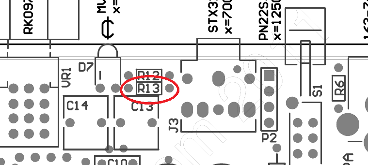

Try reheating the solder connections on R13, even if they look perfectly good.

Done. It didn't help.Try reheating the solder connections on R13, even if they look perfectly good.

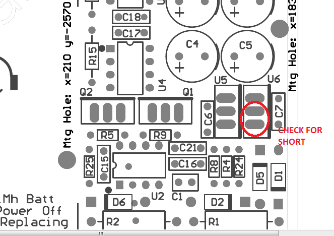

Those -16.6Vdc numbers on the Pin4's are a problem. Check the voltage from the banded end of diode D5 to ground (metal shell of gain switch) and see what you get. Should be -12.0Vdc +/- 0.3Vdc or so. If you are getting -16.6Vdc then either your negative voltage regulator (U6) is shorted, or more likely you have a solder bridge between the input and output pins on U6. On that chip (MC7912) the input and output pins are right next to each other and would be easy to short.
Use a magnifying glass to check - I've found it is nearly impossible to see a short there without using one.
