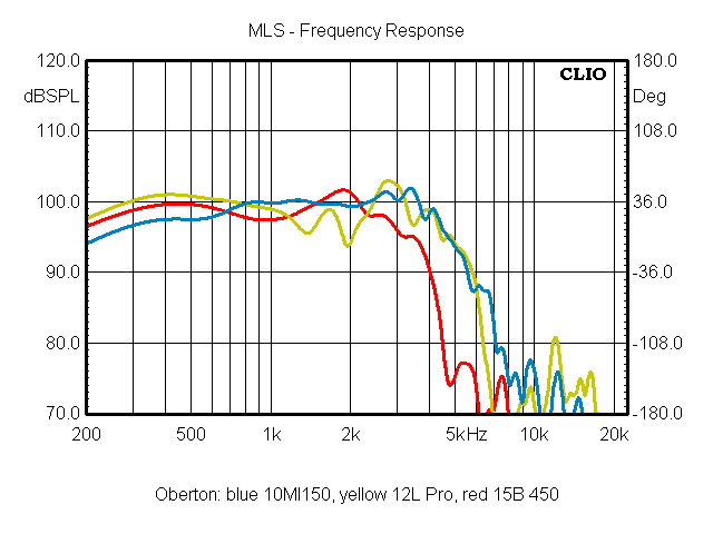

Oberton 10MI 250, 12L Pro (similar to 12L 300) and 15B 450 measured on axis, in the box with front panel recessed so diffraction is present. Anyway, measured frequency response is similar to the factory data.
Sorry, it was so long ago, actually it was 12L Pro, not 12B 400.
I can get Oberton 12B400 for 100 euro (125 US$) a piece and it looks fine looking at the factory data. Little more expensive than in surrounding countries but still ok. Other Oberton speakers are available to me as well. That 10" looks really good as far as frequency response is concerned. I might consider it.
Can you say something about measuring conditions (in cabinets, on infinite baffle...) ?
Thanks Sonce
Measured in the cabinets, on axis, at 2m distance scalled to 1m, 1/12 octave averaging. Measuring window is only 3.2ms long (small room), so not so much resolution below 1kHz.
