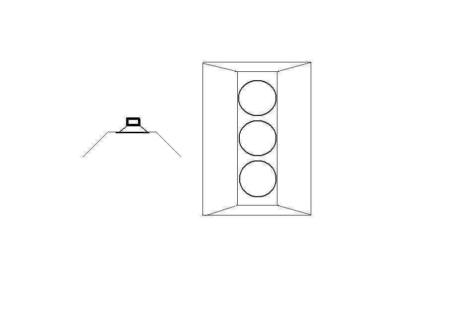

Line Array, I suppose you mean the "horn loaded" asymmetric front/back
Dont know, but to me it doesnt seem worse than an H-frame
Nelson and Kensai, I'm for whatever works best, and if keeping all OB gets the job done then thats where I'm at too.. I just thought IB may be a neat way to go, and kind of different as a IB/OB cab/baffle type of thing.. I have no experience with either methods and really appreciate all you guys that ''get er done'' and share your wisdom😎
I'm interested in what you eventually end up with as a "full meal deal" set up with the Feastrex drivers you have.. I'm looking to the D5nf driver when funds allow, and I'm considering going OB with them after maybe using the recommended enclosure first, so as to have a reference point etc..
Dave🙂
Dave🙂
tinitus said:Line Array, I suppose you mean the "horn loaded" asymmetric front/back
Just to think about:
- The area behind the cones seems to be very much
smaller than the cone area of the three drivers.
This will cause an accelleration of the air in the
pipe behind the driver which in turn introduces a huge
mass load to the drivers, thereby lowering fs and increase Qts.
The mass load will tend to decrease efficiency.
- A dipole source is worst to be located in a corner.
Room excitation by a pressure gradient transducer is difficult
- if not impossible - from there.
I feel not able to predict whether the thing can work, but i feel
it will suffer from some drawbacks.
Cheers
