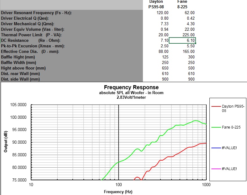

assuming 8/10" woofer and dayton ps95(which i have decided to use in this setup),
what would be the possible xo between these two?
say if i select between 500hz to 800hz then what would be the baffle width requirements for dayton ps95? this driver is just 3". i am willing to increase xo for this to 1khz if necessary.
For the mid range region an 8-10" diameter mid-woofer would be fine. You can select your mid-woofer to have a sensitivity that best matches with the subwoofer and tweeter array sound levels if you are thinking of a passive crossover between each band in your final speaker design. An all active crossover would give you more latitude for driver selection.
Do not use an H-frame or U-frame enclosure for the mid-woofer but instead a flat baffle for this driver. Neither a H-frame or U-frame mounting will permit you to cover your desired mid range frequencies without resonance peaks or dips in your desired frequency range. You can use various models to calculate your baffle width but I'm more old school on this subject. The mid-woofer baffle width will be determined primarily by your subwoofer to mid-woofer crossover frequency while the mid-woofer/tweeter array crossover frequency will be the determining factor for your tweeter-array baffle width.
My best recommendation is to build a test baffle and measure or listen to determine whether you have adequate mid-range and tweeter performance. You can even use foam board or similar material to permit trimming to suit your needs if you need to experiment. Thus you can optimize your baffle widths to ascertain the best baffle size for the final speaker. Of course if you have the ability to equalize the entire frequency response then you have more liberty to correct the final speaker to your needs.

probably i will go with all active solution, just to have more control over filtering and EQing.
sub to woofer/mid freq cutoff i am planning at 120hz.
mid-tweeter freq cutoff is what i have to decide. i am thinking of somewhere between 500-800hz. since ps95 a low power driver(just 10w rms) i guess crossing higher will result in more efficiency. as you suggested i will experiment with diff baffle sizes.
however i wonder if there is any formula for calculating the cutoff freq given the baffle width or vice versa!

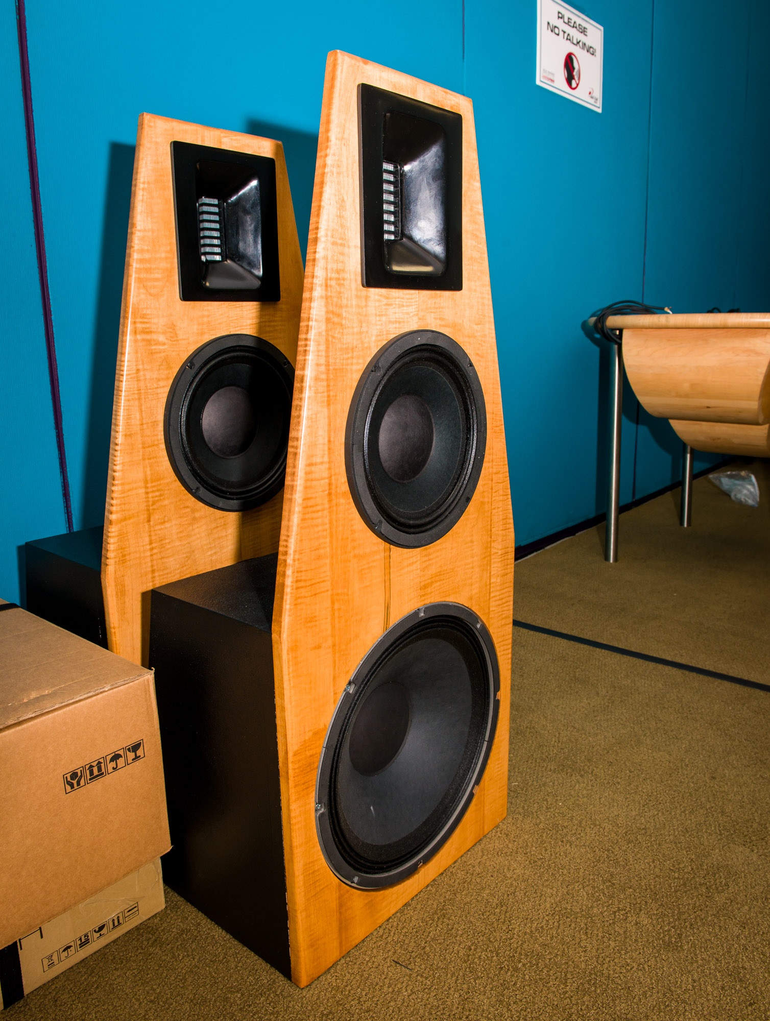

I have a recent 3-way open back design that consists of a 15" diameter woofer (Eminence Kapalite 3015LF Neo) mounted in a u-frame, a 10" diameter midrange (Faital 10PR300), and a Hawthorne Audio 700 AMT tweeter. The tweeter front waveguide is 7" wide by 8" high for scale. The active crossover frequencies were at 175 Hz and 700 Hz. Note the sloped sides of the baffle that minimizes the overall width for the mid-woofer and tweeter portion of the baffle. I constructed a MDF test baffle to verify performance for the mid woofer and tweeter mounting before cutting the wood baffle.
The photo sizing is such that the speaker looks much wider that it is. Click on the photo to re-size and correct its width. The overall baffle is 18" wide by 42" tall. The baffle width at the center of the mid-woofer is 14" and 10.5" for the tweeter center line.
Jim
Jim

your driver selection is interesting. the midwoofer (faital 10pr300) has low Qts of 0.27 which is contrary to popular belief that OB drivers should have high Qts....or at xover of 175hz the Qts values doesn't matter much?
for midwoofer job I am also looking for pro driver. One option is fane 8-225 8". unfortunately 8-125 is unavailable which has high Qts.
Fane International Ltd Loud Speakers
I using an active system with a DEQX processor for crossover and full frequency range EQ capabilities. Thus I'm not too limited by passive crossover Qts thinking in this design.
I liked the FaitalPRO driver because of its higher SPL capability at my crossover frequency vs. mid-woofers from other companies.
