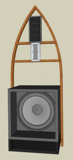

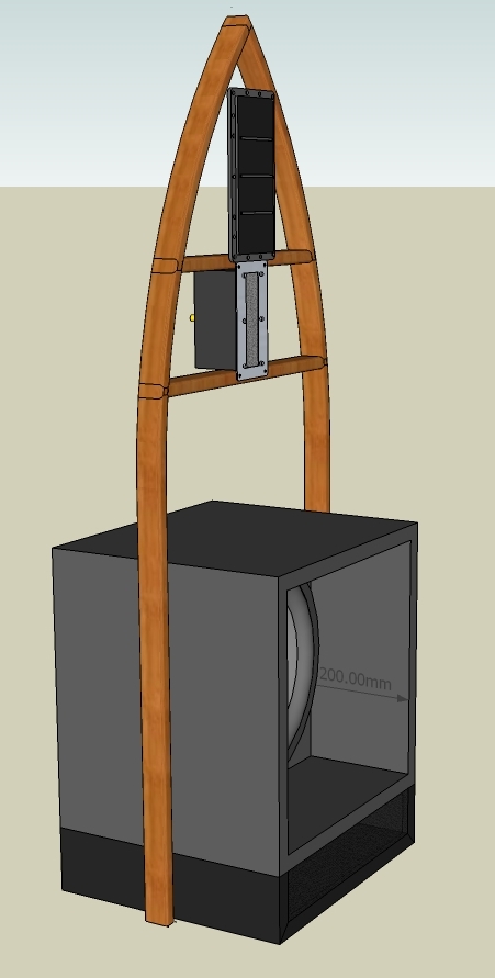

More Doodling
I have added a section at the bottom, to house the amps etc, moved the frame back to align the speakers. I have also made the gothic frame wider & could have rubberised mounts on the sides for some isolation & of course Iv'e thrown in a Neo10 for good luck.
I'm not over the moon about the design, just a place to start.
If there's anything wrong with the concept please feel free to tell me
David
David

David,
in view of best stability you better have some mass (amps etc.) fixed to the top of the H frame instead of below. I see that this would make the distance between woofer and midrange larger - but why would you place the mid driver on top of the tweeter in the first place?
Rudolf

Hi David,
nice and cool desing there ! Certainly unique those gothic curch windows.
I also considered integrating the electronics into the speaker either on top or at the sides. But I departed from the idea again because I did not want the strong magnets affect the circuits. Not sure if they would, though.
Oliver

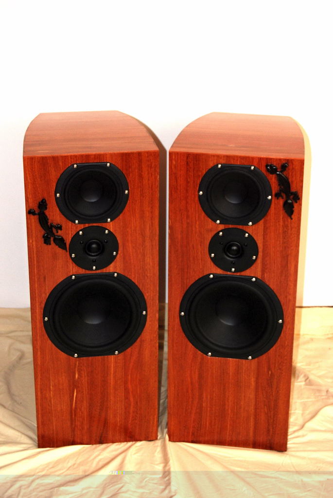

"but why would you place the mid driver on top of the tweeter in the first place?"
It is the same as they layout I have now, which is a direct copy of Lukasz Frikus P17 OB, I'll have to admit I do not know or have forgottten the theory behind the speaker placement. It is also the same as a set of box speakers that I made son my son, under the guidance of a local speaker manufacturer, my son & his mates think they sound great, although a little lacking in bass, imagine that! sorry about the right hand photo, most of the good ones are too large to load.
Having said that I cannot determine any fault when listerning to them, maybe thats because I'm a beginner.

I was thinking I might need some type of shielding, but I'm not sure you can shield for magnetic field.
David

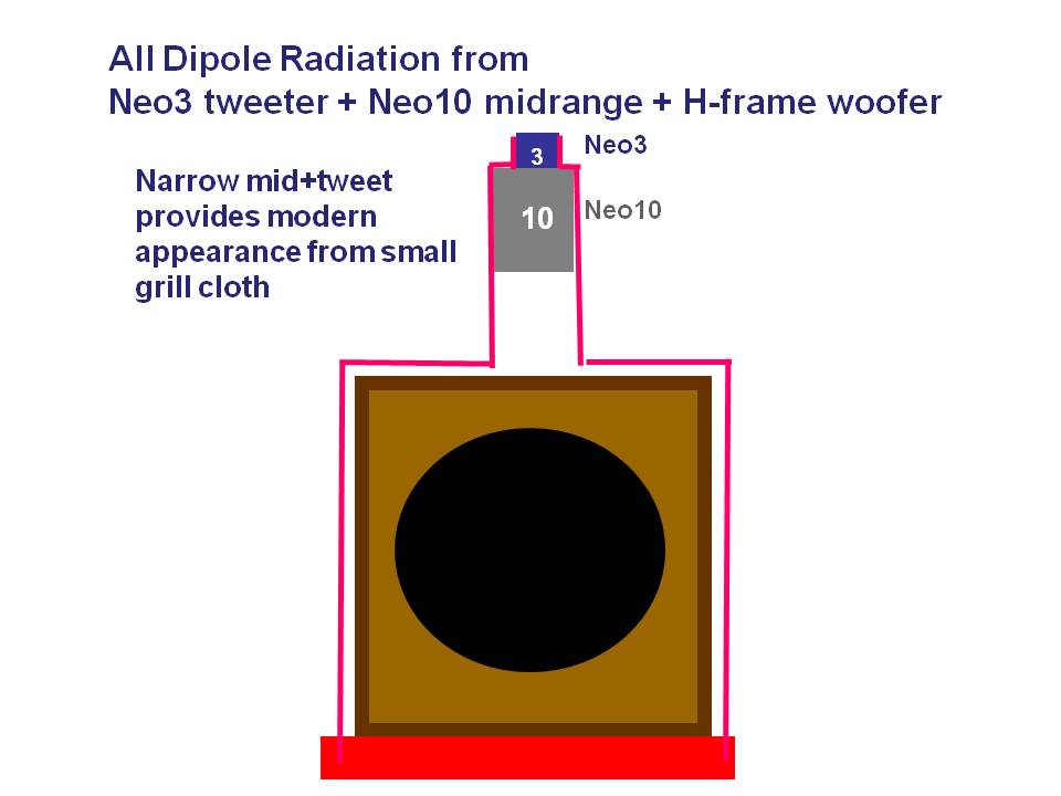

Hi DQ828,
Most dipole experts use a dipole tweeter. The modest cost Neo3 is popular. Although the RAAL 140-150 ribbon would be superior in a sealed box, the Neo3 would integrate better in a dipole design. RAAL now makes a dipole ribbon tweeter, but it is expensive and I have not seen any reviews. You may want to experiment with a Neo3 before purchasing or making a dipole ribbon tweeter.
A smaller, simplier top frame for the mid+tweet would have a more modern appearance, especially with a grill cloth like a nylon stocking.
