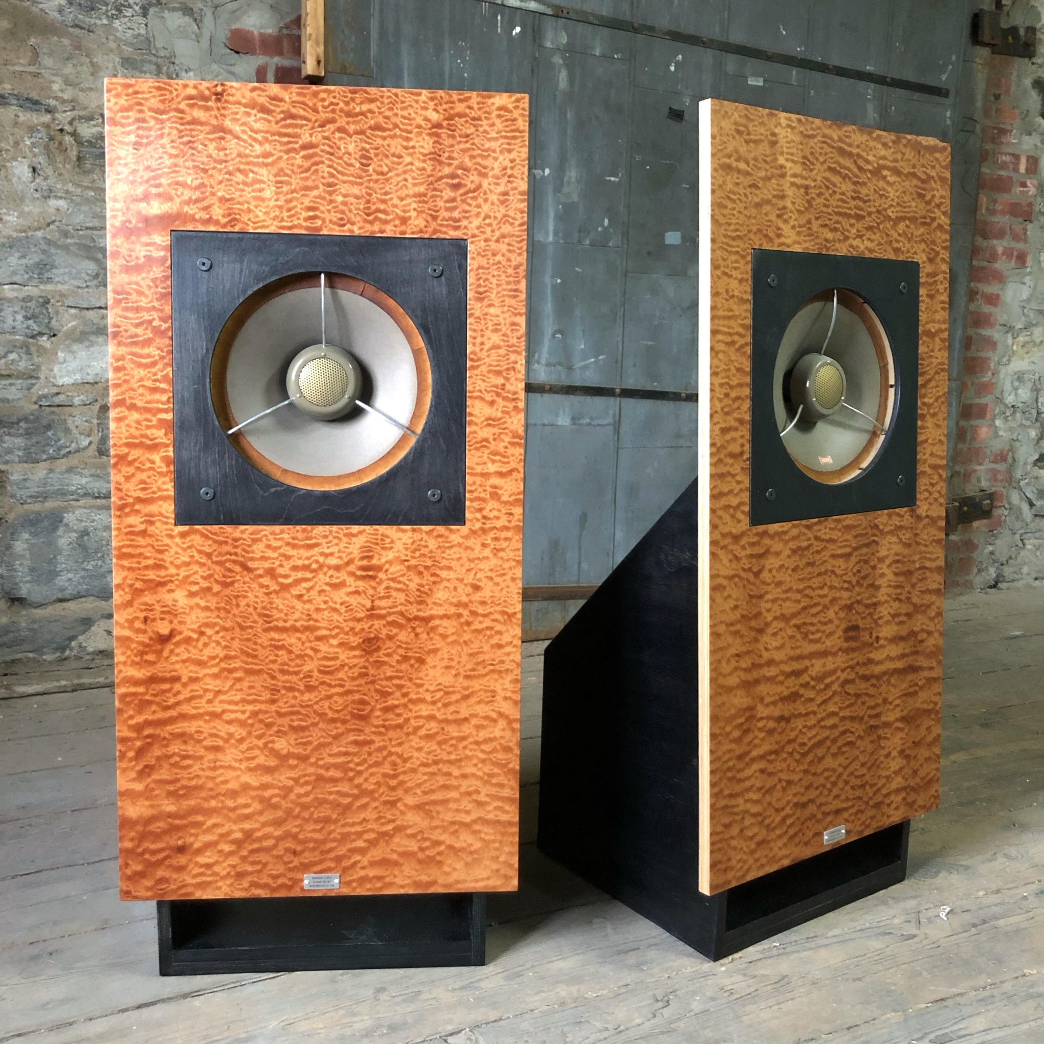

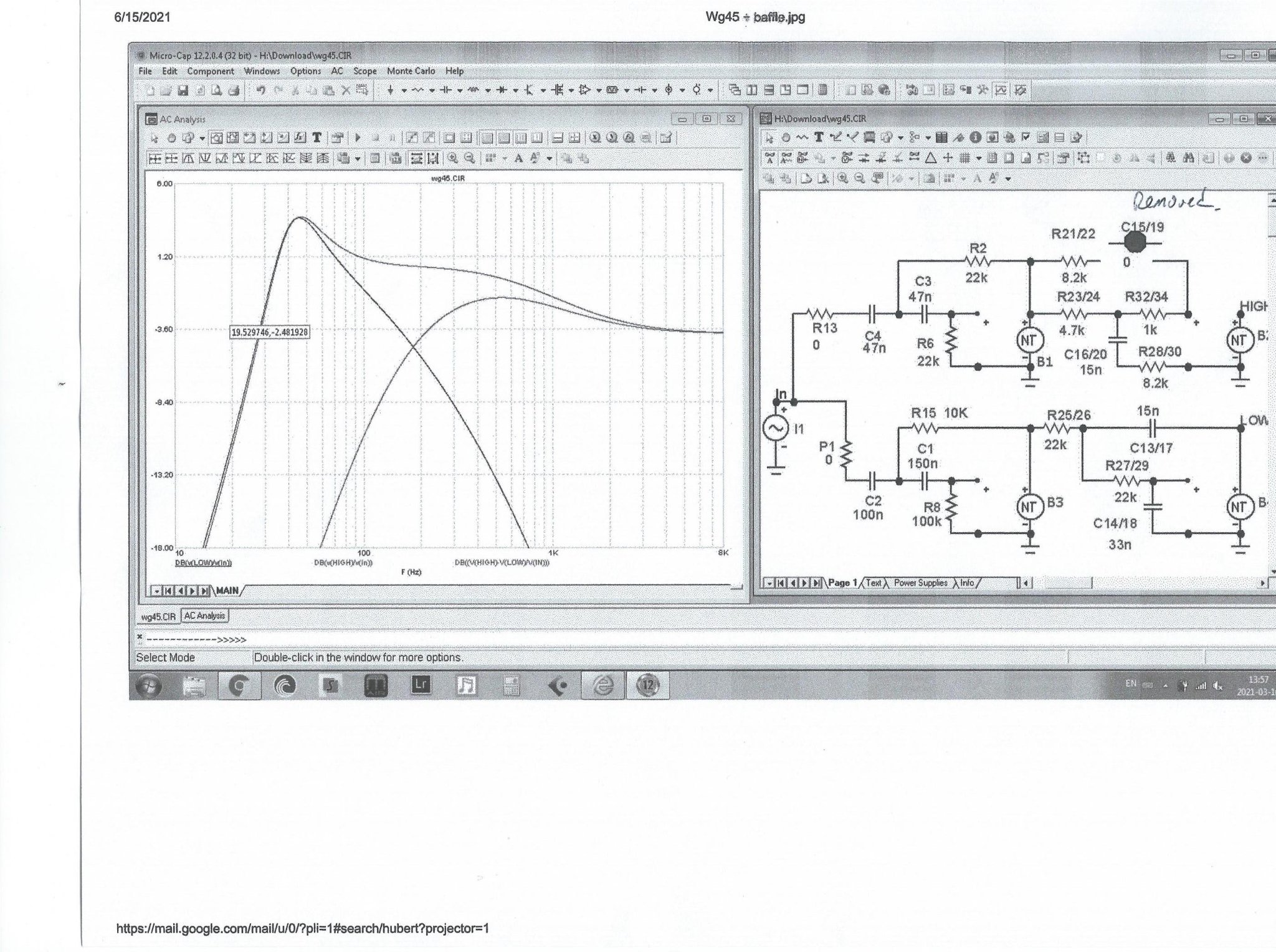

I built a pair of SLOBs a while ago (and have since changed the drivers to a pair of Lii Audio Fast 8s) - and have been playing around with Dirac on my miniDSP SHD.
I was running the Pass ACN with values suitable for the SLOBs but have since recreated the curves digitally in the SHD via biquads and am using the SHD as the crossover.

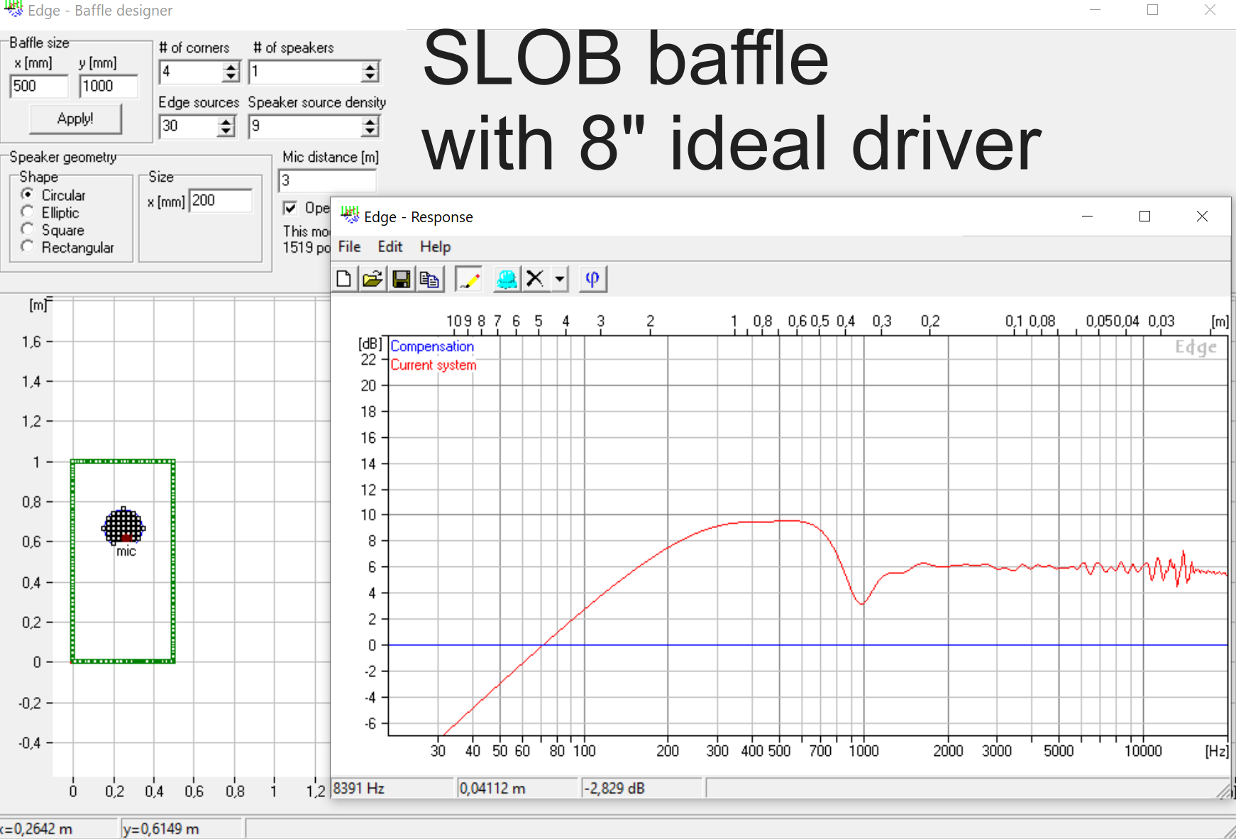

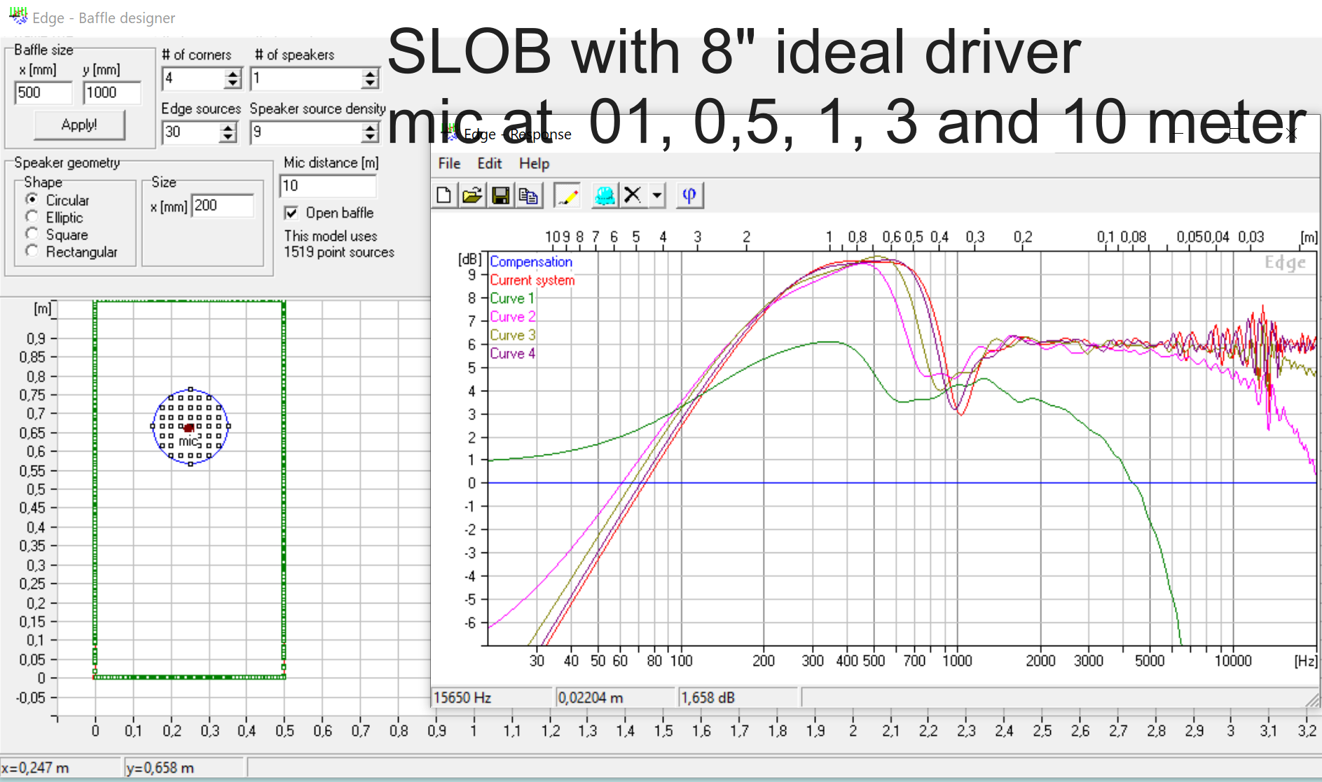

Measurement in nearfield is ok above roughly 500Hz. But baffle diffraction effects and off-axis responses must be taken care of too.

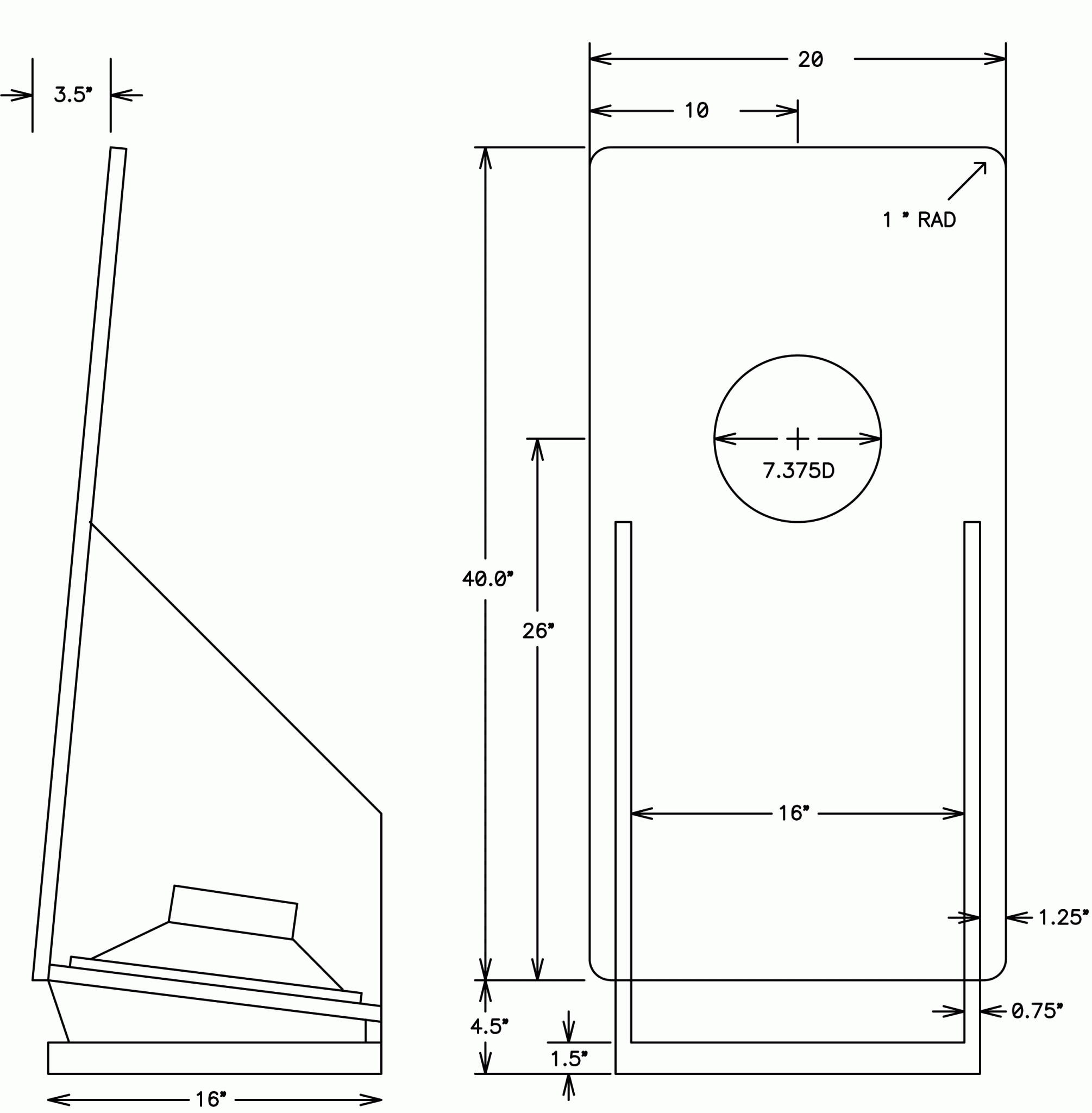

What is the size of your baffle and what is driver's position on it? With this info a simulation software can give info for eq below 500Hz.
Another possibility below 500Hz is to do several measurements near listening spot, use long gating and 1/2 octave smoothing then use averaged curve to set eq. And remeasure and listen!

@Juhazi - these are a pair of the Nelson Pass SLOBs, now with "Lii Audio" Fast-8s and Eminence 4015LFs and using a miniDSP SHD as the crossover - overall delighted with the setup, I'm just trying to ensure I'm getting the most out of Dirac built into the SHD, but do need to take better nearfield measurements - thanks for the tips.

@Juhazi - thanks so much for that sim, really appreciate it. That explains the dip I was seeing around 800Hz, which I was initially surprised me, but makes perfect sense, and know I'd see a similar sim before when building these. We forget in order to remember...

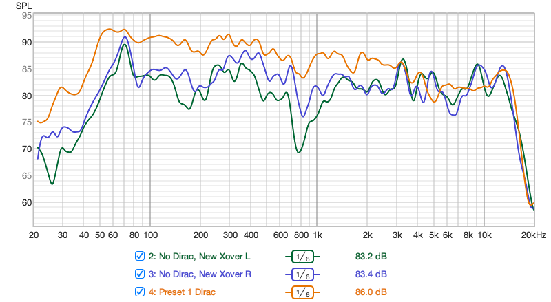

After all this help, I think my next steps may be to remeasure nearfield and from the MLP and add some careful PEQ of my own rather than Dirac, and see how that goes.
I may also try redoing the crossover as well based on the measurements. My original thought was to start with the "established" SLOB curves (attached below), but based on my measured response, I may be able to improve on that.
I feel like it sounds better than it looks? Or we just tend to all fall in love with our own creations?

Every open baffle is dipole (not with back closed drivers, of course) and radiate as dipole in whole spectrum. What we are most interested for, is freq range below first dipole peak as in that range radiation is CD . Unfortunately, those ranges are quite short in practice as we are limited with drivers size and displacement, so if want to have, as much as possible, CD radiation an OB should be at least 3 (4 is better) ways and every driver should have different sized baffle or no baffle at all
I do not know how high the SLOB can play but you can lower the dip in freq range with bigger baffle, and try to use full range above first dipole dip (now on 800 Hz). The response will be wavy but amplitudes are much smaller than first peak as can be seen on Juhazi simulation.
As well, the peak/dip are so pronounced because the driver is mounted almost simmetrically to three edges. Little bit of offset can mitigate dipole peak/dip significantly. It is easy to simulate in Edge.
