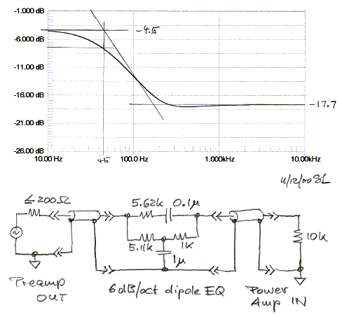

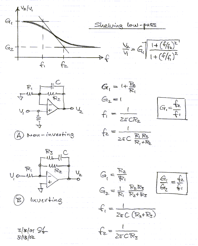

I want the u frames to get extra 6 dB at 25 Hz, it is posible with the 19 hz drivers.
But I use onlly stereo amps hybdrids, so I want to use a line level eq filter who works only in a small part 25/80 hz to correct it..
I have done now a eq and it is a eyeopener, it give more bass, but I get a hole around 100 hz so it is to wide.
it is not meant for very loud playing, but the visatons can go pretty high in spl.
see picture maybe somebody can help, I try to ignore a opamp.
Th F1 25 hz and F2 50 or 80 hz
thanks
