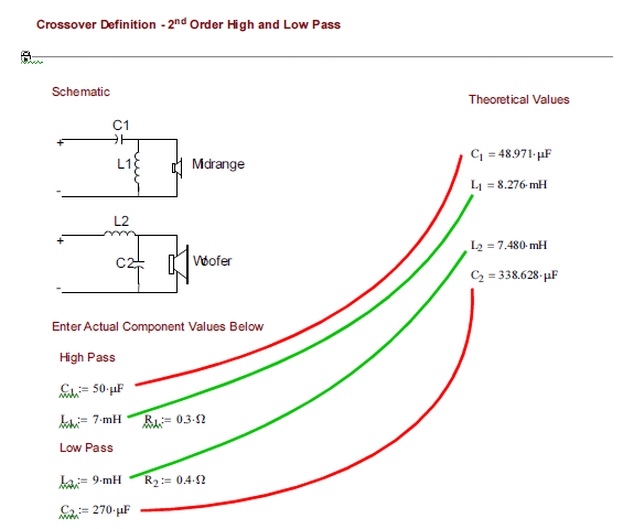

I have did this (see pdf) after first learning some, I am still green behind the ears with Martins sheets, but get slow the ping feeling.

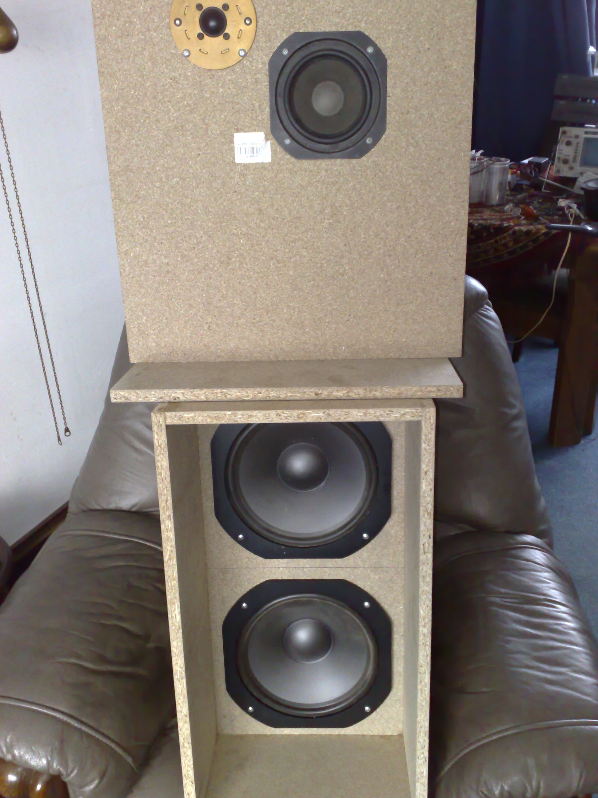

Anyway, I have use two visatons wsp26 s speakers in a single H frame and a fostex full bandwith speaker.
like to get some ideas reactions, because I have a H frame without a baffle between the upper and lower woofer, normal stacking has there a baffle but the sheet don,t work with that anyway.
Try to work with better precision. You got the divided Re of the Visatons wrong.
Why didn’t you enter the proposed “theoretical values” as Actual Component Values in the “Crossover Definition”?
You might lower the low pass filter frequency or raise the high pass filter frequency to avoid the response bump at 250 Hz.
like to get some ideas reactions, because I have a H frame without a baffle between the upper and lower woofer, normal stacking has there a baffle ...
If people put a brace between the upper and lower driver, it is only for mechanical reasons (and recommended). There is no acoustical necessity for it. And leaving it off doesn't change anything acoustically either.
Rudolf
Thank you very much for your advise, what this for my new technologie from Martin concerns, I have to practice a lot more to get it the good way, but I am have found the good way.
I a a amp designer, so, speakerboxes is for me new, what calculations concerns.
The bump I presume is because of fase reactions? there is a need of some distance between the two, (low and mid). Martin say I have to divide the RE when parallel speakers, I have the thiele parameters of visaton paralleled,
it is 2.85 ohm or specifications are not right, normal with one speaker it is 5.7 ohm I now that filtering is normally calculated with 8 ohm, Martin uses dc resistance, I have tryed to calculate filter components with a other software, using 8 and 4 ohm, but what do the sheet with the theoretical values” as Actual Component Values? .. I have already ask this to Martin but yet answerm so I wait, I have to learn this way of calculations, I am used on normal software for this, I already see that the Martin sheets are much more usefull, but I have to learn more.
But first I have to solve the winzip crash in windows 7 after a last update the winrar program crash with opening winrar or winzip, it annoying me very much, windows 7 gets more unstable with any update.. tomorrow I go further with testing and set here the result.
I will try your advise, thanks again.
kees
No phase reaction - the low and high pass filter frequencies need to be farther apart.
Martin say I have to divide the RE when parallel speakers, I have the thiele parameters of visaton paralleled, it is 2.85 ohm
Yes it is 2.85 Ohm, but you entered 2.35 Ohm in the sheet 😉
You have defined the crossover filter frequencies in the "Crossover Definition". From them the worksheet calculates the "Theoretical Values". You need to enter those values (rounded to the nearest "market" values) into the "Actual Component Values" column. See attached picture. The "Actual Component Values" are not calculated automatically!
There are detailed "Instructions" on how to do this below the "H frame Enclosure Geometry Definition". Did you read them? 🙄

Well it sing, and it go low, however, it is sensitive for where I am in my room, a meter for the box it has a beautifull bass, but 3 meters before the box the bas dropps for shure with 3 db minimal, I presume the h frame has to stand on the floor, and in a corner, what not so is with the testing.
the 0.5 is that I have to move the speaker baffle to correct for the baffle itselfs? can you explane some more for me please, thank you.
here is some music from youtube, the box sound this way, 30 hz, it go there easely but you can,t hear that with the camera recording, and is mono (use just one channel so you miss a lot).
The low pass for the bas speakers, not higher then 100 hz and minimum 18 db octave, the sound above 150 hrz is coulored like you wil hear in this video, here is is 6 db octave and 250 hz, for up, bessel fuction work best, 12 db or more, it give no fase problems..
I did hear from other members that the H frame coloured the sound, and so I have to say yes it does give hollow sound, so low pass not hihger then 100 and maybe even 80 hz.
As with every loudspeaker, bass is sensitive to the room modes. This is nothing unique for a dipole.
Every change in baffle size changes the response of a dipole. I would not call it "colour". Please equalize the H frame in the right way and it will be useful up to 200 Hz.

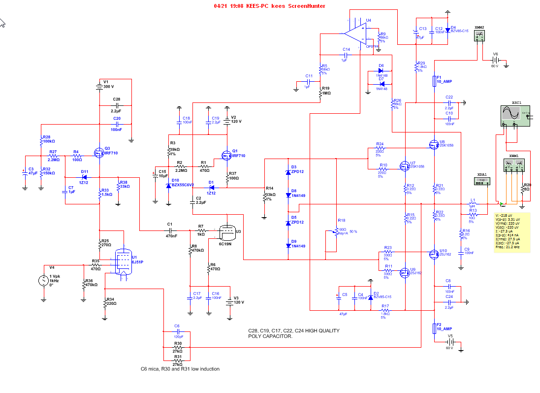

schematic of my amp design is here also.
thanks
