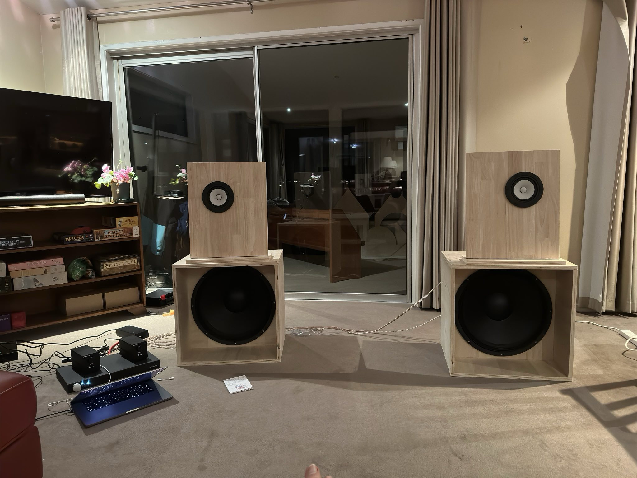

Hi Tigeranand,
I have built with the 18SW450. I have ended up going with H-Frames for now.
50cm x 50cm, with 40cm depth (20cm Front & Back of the woofer).
They have only been in a temporary home, so I'm hesitant to give too much information, as they definitely have room to grow with regards to placement, and I am also just starting to learn REW and Minidsp EQ for the first time.

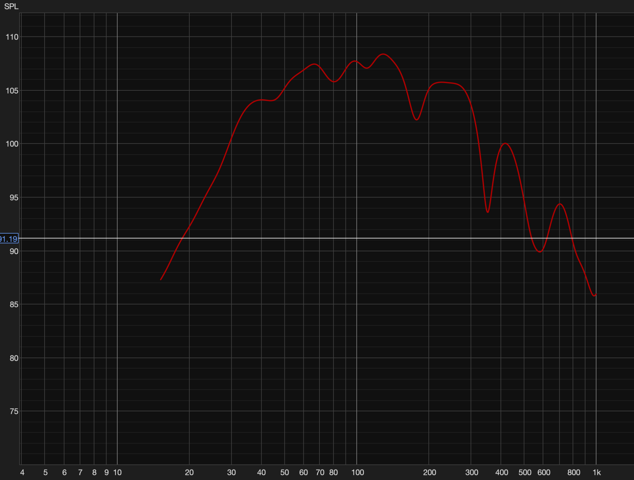

But DAMN they are effortless. They make so much bass when they need to, completely disappear when not called upon. I haven't really "opened them up" yet, but they get plenty loud as it is. I have some very quick and very dirty measurements, that included a terrible noise floor, so I will only show the basic response. I don't even know if I have good measurement technique as yet.
Raw 18SW450 at 20hz - 1000hz.

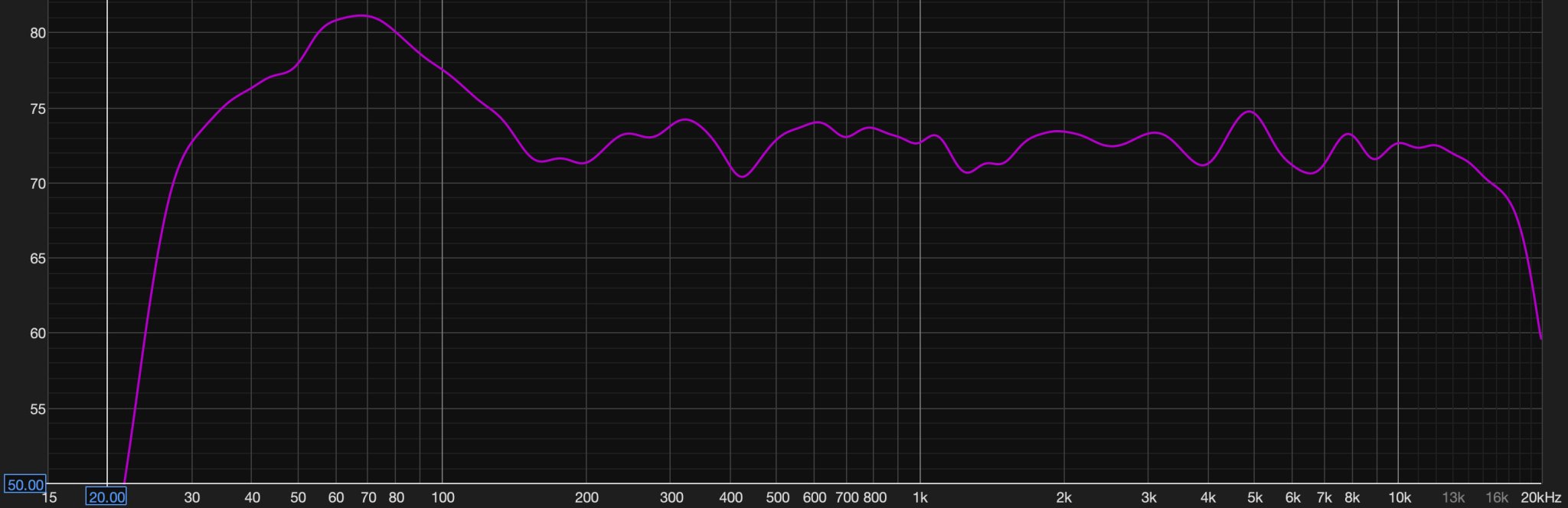

My first attempt at EQ. Yes I know the cross between Bass & upper isn't very smooth yet.
I think I actually added a small cut at 65hz to take the lump out of the bass response after this measurement.
Overall it sounds great to be honest.
The MAOP has a surprising amount of output for the baffle it's on, but definitely drops off below about 200hz. This is a bit tough as the H-Frame has it's resonance at about 200-250hz, so it's a balancing act to get it right. And again, I might not have a clue what I'm actually doing, but it's certainly fun.

I've done my first open baffles, first 18" drivers, first two ways and first active crossovers & EQ all in one go. So many things to wrap my head around!
I've also got some other drivers stashed away that I am going to swap the MAOPs out with for the fun of it.
Pluvia 7HD & Scanpeak 10F/8424G00. I also have some RS225-4 that I might try making a 3 way out of, though I know they aren't particularly suitable. Active & OB makes it so easy to experiment and rapidly iterate. I'll likely also try a simpler U Frame design for the woofers at some point as well.
