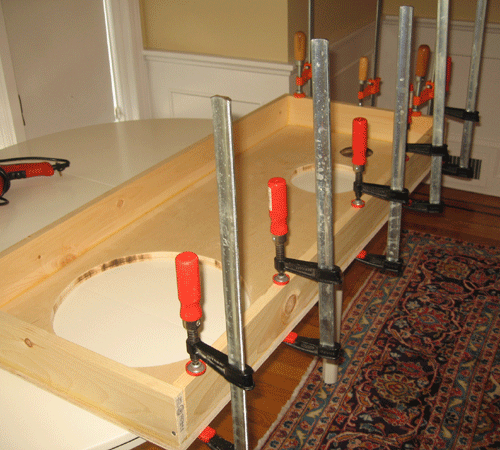

Here is my progress so far on the Betsy-Boomer. I need to cut bases so they will stand up with the drivers mounted. Easy build bc there is complete access to the front and rear of the baffle. I hope to have drivers mounted and everything hooked up for listening and tuning in the coming days. You can see my BIBs in the background along with H-frames and a super tweeter that i will incorporate into the build. I look forward to comparing the two setups.
Godzilla
Godzilla
Looking sharp there, Godzilla.

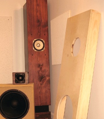

>>> Godzilla, wouldn't those wings at fullranger height interfere with the midband?
We shall see... but i don't expect them to.
My back went out yesterday (i was disarming someone with a gun during krav maga class... green belt test next thursday) and could not do much speaker building. But tonight i put together a pair of very cheap speakers from PE buyouts. Drilling, screwing lol, and wiring them up, not to mention listening to them thru a cheap sonic impact amp really loosened up my back for the better! Speaker building is good!
Godzilla
Godzilla
I can't imagine they would. If those little wings were a problem, one would think a box would be a huge problem! I recall seeing some narrow OB's with really deep wings. I imagine that at some point, you develop a resonance strong enough to be an issue. I think Zilla's design is quite a bit shy of that.

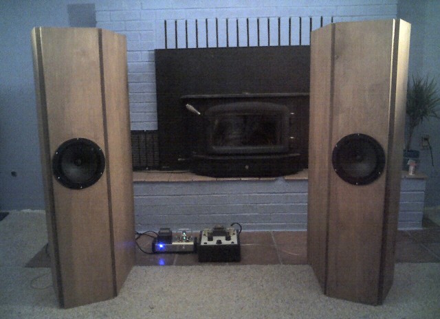

My only camera is a cellphone. Here are the OB's in a temporary location, with the B200's, which demand that the wings be folded back.
The little amps are a Dared MP5 on the left, and the Bottlehead on the right. The Bottlehead is a lot sweeter but has just 2 watts to the Dared's 13 watts. (And behind the amps is our pride and joy, a wood stove that fits inside the previously useless fireplace -- winter is pretty cold at 7,000 feet.)
Dared MP5 ... the Dared's 13 watts
