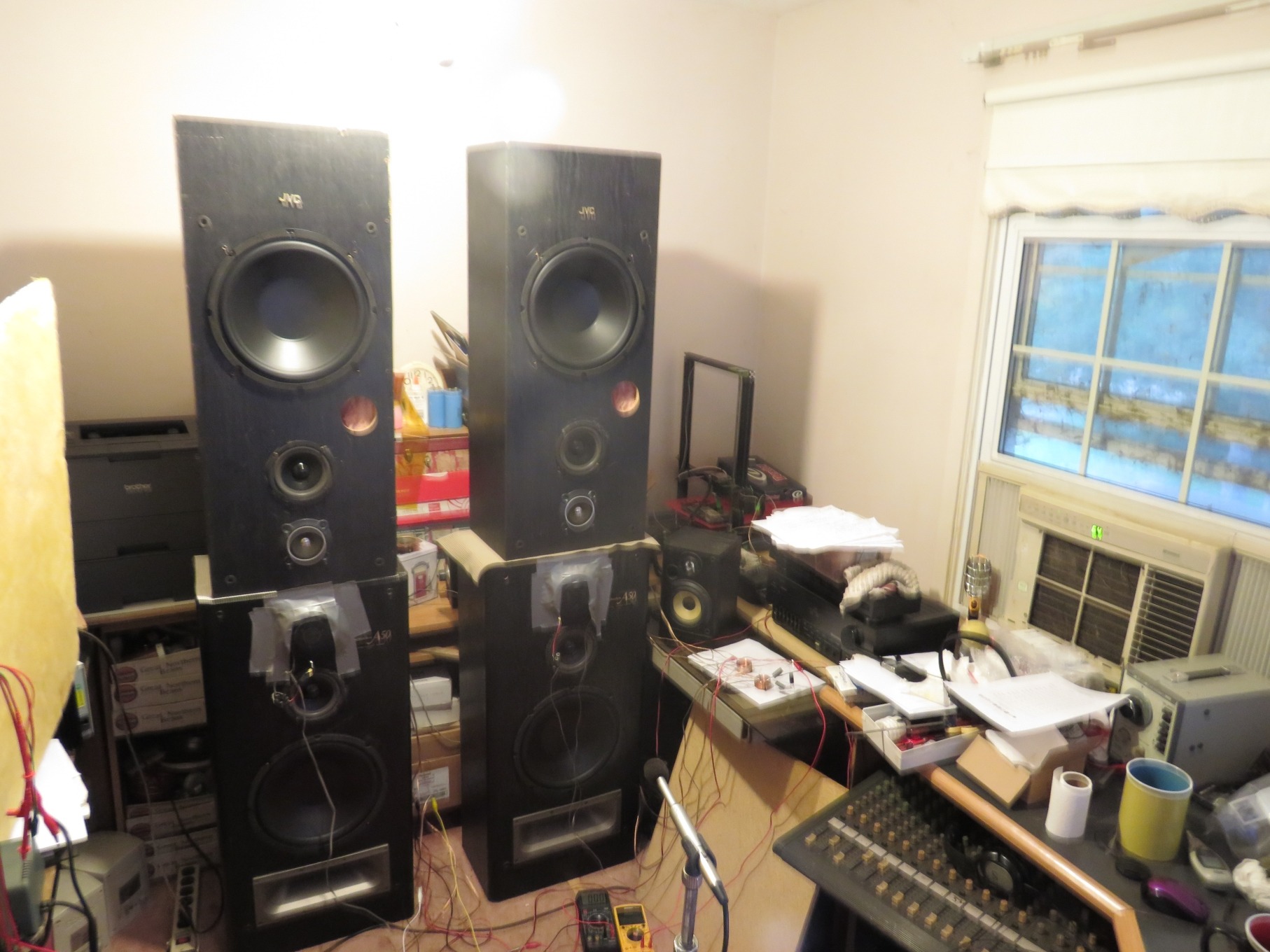

I too have six of them to work with for now but plan on getting another case or two to use in OB for my ESL's and the four I have going Now is plenty enough for this room already !!! ;O 😀

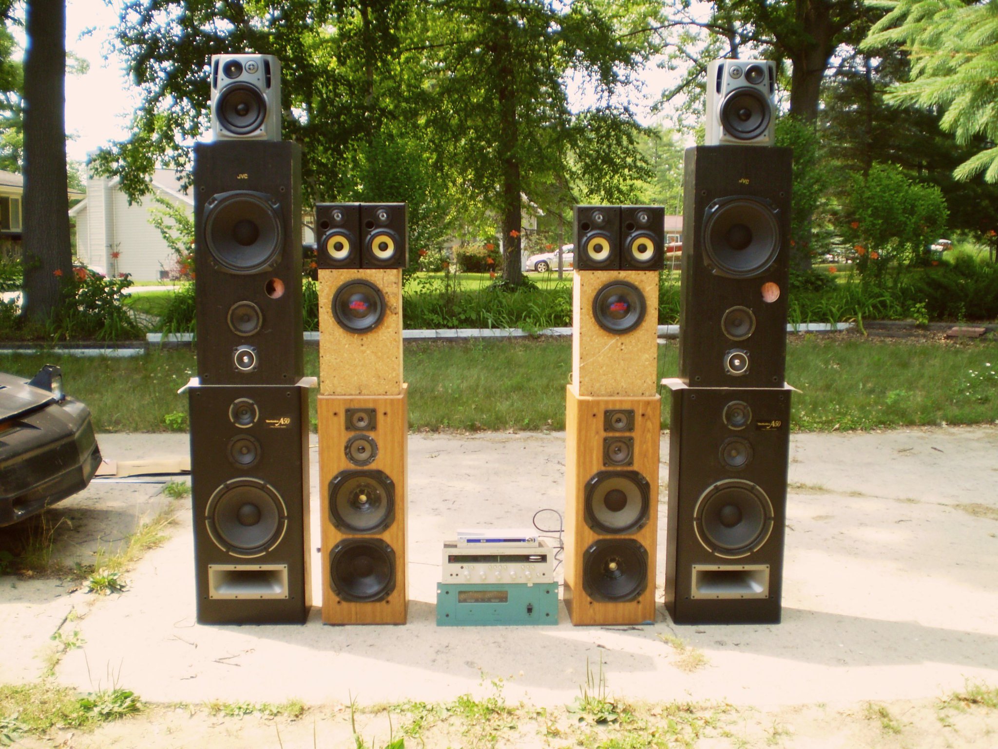

I am actually gonna get the 10" versions, the 10sw-4's as well for a pair of smaller 2x10's I use with the stack, I am thinking a pair of 8x10"s per side with 6" wide segmented ESL's 6-8 foot tall would be nice in my bigger Living room area, and is actually my dream system been in design all these years. 🙂

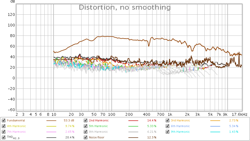

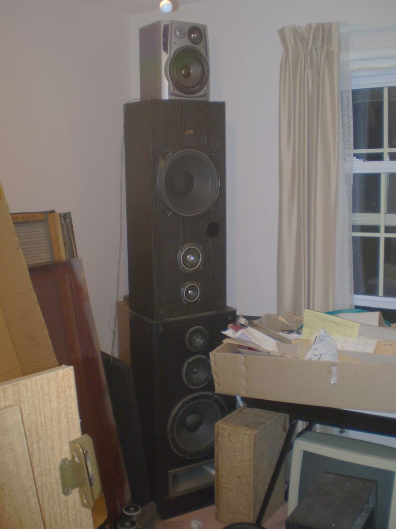

Below are pic's the the original stack that I kept blowing the midranges and started the Desktop ESL project to adapt to it for mid's and the way I had each stack stacked in the corner of the room and it's now current condition.

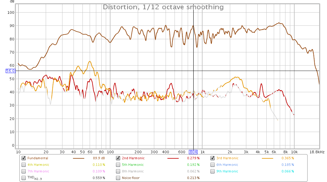

The two graphs are of the woofer it self in my setup as it is and a FR with the match to the mid's I am currently using, eventually will new replaced with new ESL's. 😉
When properly tuned they are flat down to 20-25hz or so, and that is just 4 drivers so far.
I have included them to show that the THD of this driver is very good for what it cost (me $23), WaY better than the old stock crap I blew up !! 😀
However they are actually better than what REW depicts as I was having a noise issue with the mixer I was using to interface to my computer, It uses JRC junk and the floor is not any lower than -68-72db and the room was rattling a bit as well !! 😠
:headbash:

I was thinking about using the side of the wall as part of a simple TL with the stack next to it or something, with 11.5 feet my space is tight as you can see in the pic's.
