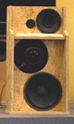

I have a buddy in California how has build a lot of OB stuff. He has a pair of OBs with 2 Eminence 18s (going opposite directions) a Beta 12LTA for the mid and a big dome tweeter. That's a lot of speaker!
You could skip the 12" and dome and use your 511 horn instead. I'll see if I can dig up a photo of his dipoles.

Here is a photo.
Very bad photo, but it's all I have. You get the idea, anyway.

Those 18"ers would be about perfect for a ripole (might even give you an Fs as low as say 18Hz in that config). Of course since you want them to run up so high, ripole won't work for you (even small drivers in ripole really won't sound good or even respond audibly above say 200Hz). In OB, yeah, they'll need EQ, or possibly you could use some resistance in series with them to raise their Qts a bit to help out.
Kensai
That 2x18 - 1x12 + tweeter shown above is all passive filtered.
EQ is part of the crossover. Basically the hi/mid of the 18s is attenuated to bring it into line with the resulting low end.
I have not heard them - I'm 4000Km away and they aren't that loud! But they've been around to a number of DIY meets and the bass is said to be "heart rending." Driven off about a 100 watt, amp I think.
