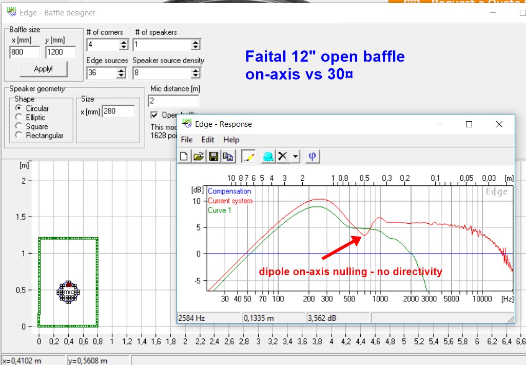

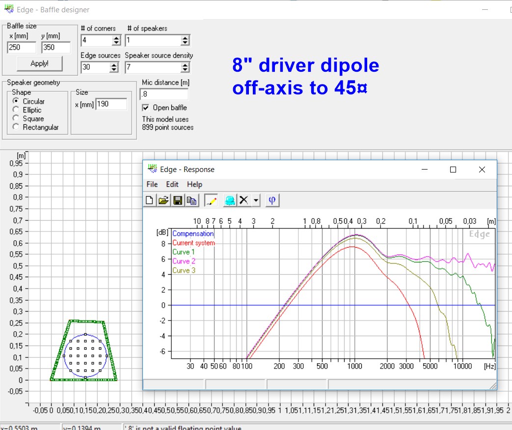

Hi, you should also consider off-axis response. Large drivers get in trouble pretty soon. I like to use The Edge for preliminary studies on baffles and driver location, it is so easy and quick, you can study off-axis by moving the mic sideways and saving plots.

Faital 12" radiating membrane has diameter 280mm. In 80x120cm baffle Edge simulation gives this response (assuming linear on-axis radiation)
You want straight 200-2000Hz. Smack dab in the middle - you are in trouble with a 12" driver! This would be ok for 50-800Hz. Around 500Hz this size driver looses directivity, there is on-axis dip and off-axis the response is roughly the same 360¤ around - omnipole. Above 1000Hz the driver slowly starts beaming because of it's diameter.
By offsetting the driver in the baffle, wiggles get smoothed a little, but response is not mirrored left-right anymore. A narrower baffle shifts dipole peak and on-axis null to higher frequecy. A nude 12" gets in trouble around 1000Hz, I cross it around 800Hz.
Laws of physics limit a dipole driver's usable uniform, linear radiation pattern to max 3 octaves below dipole peak, and eq + crossover design is challenging.

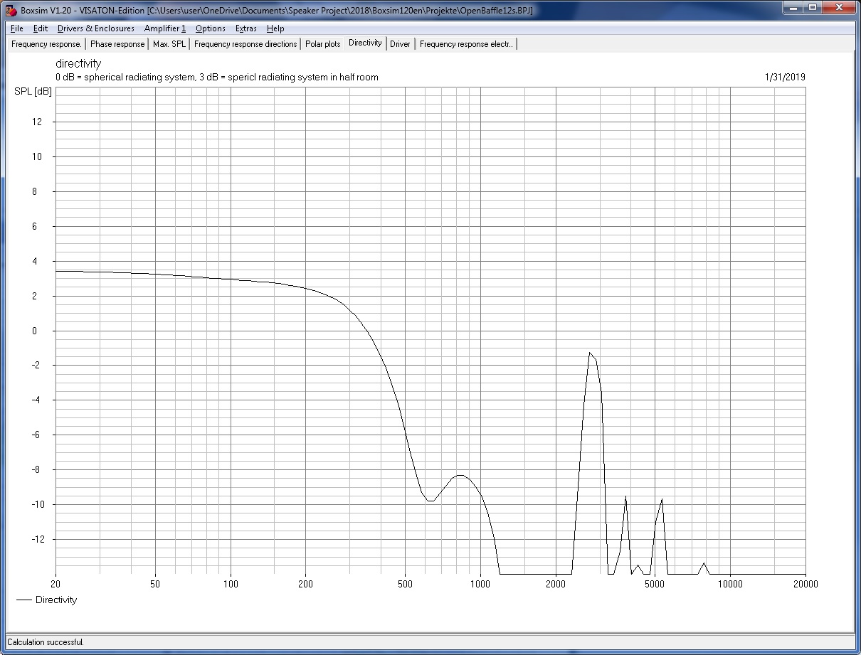

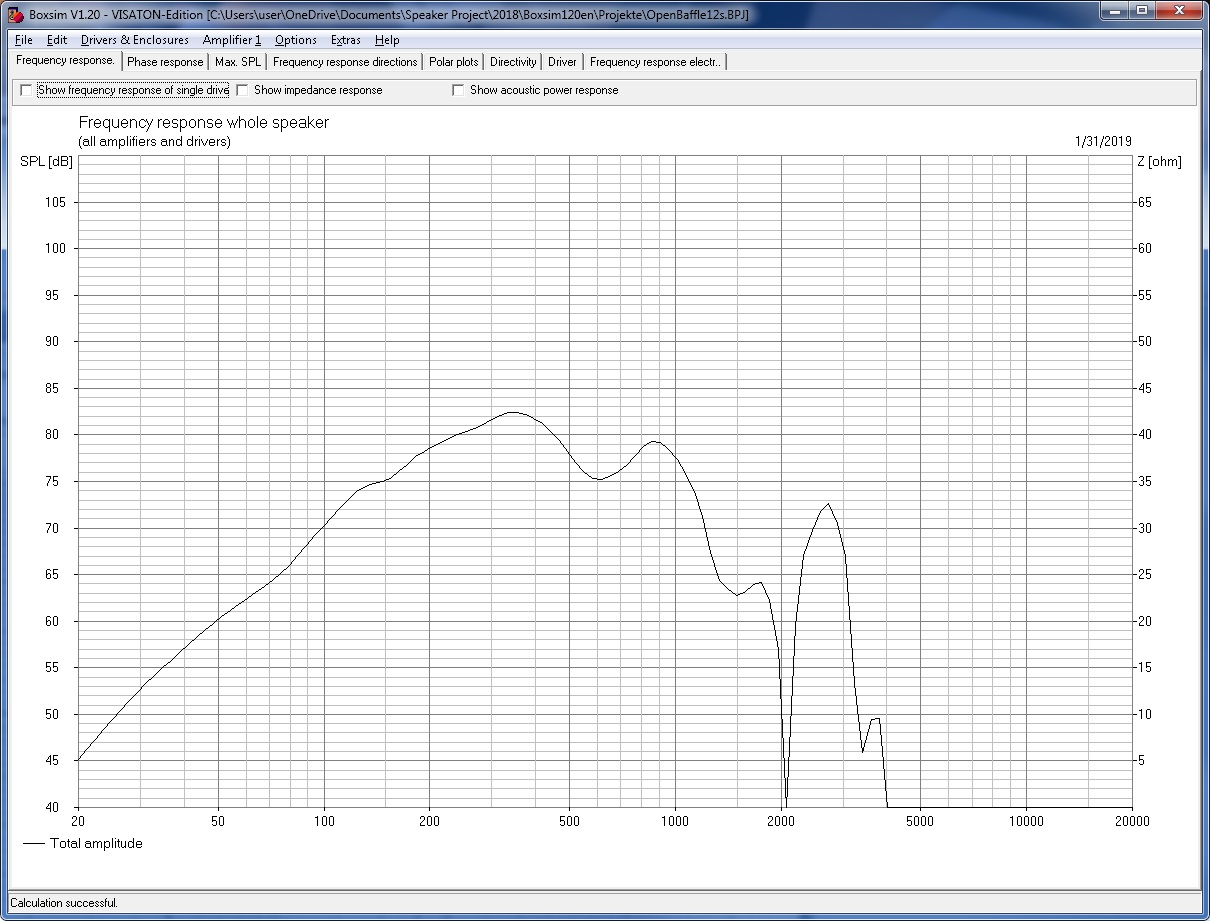

Open Baffle Boxsim Results
See the attached results for 100cm x 100cm baffle size with two twelve inch woofers modeled. You edit the baffle size in the Drivers & Enclosures Tab
/ Common Outer Housing .
Here are the Frequency Response, Off axis frequency responses horizontal and vertical and Directivity.
I unchecked the single driver, impedance and acoustic power to show only the Total amplitude plot on the frequency response graph to avoid confusion.
The Boxsim model will show you everything you need. It takes a little effort to learn all the menus. Open an example design to see a crossover. The crossover component optimization works really well.
