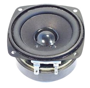

With a tandem of Visaton FRS8M you might get surpried, and they are cheap at 11 EUR
