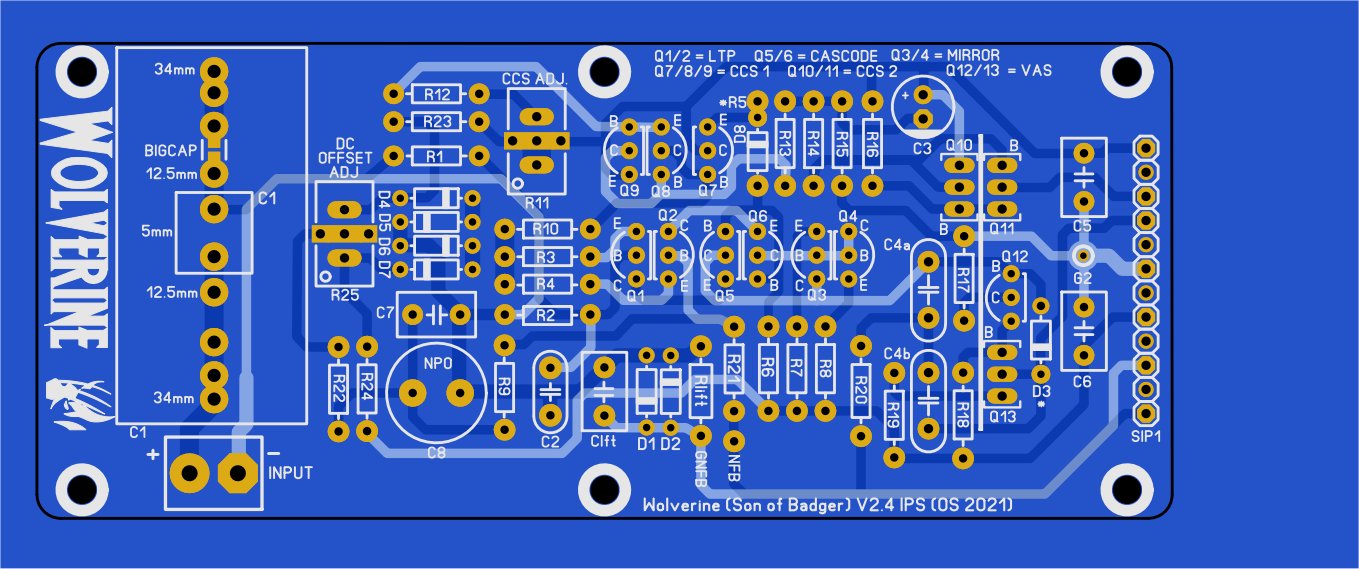

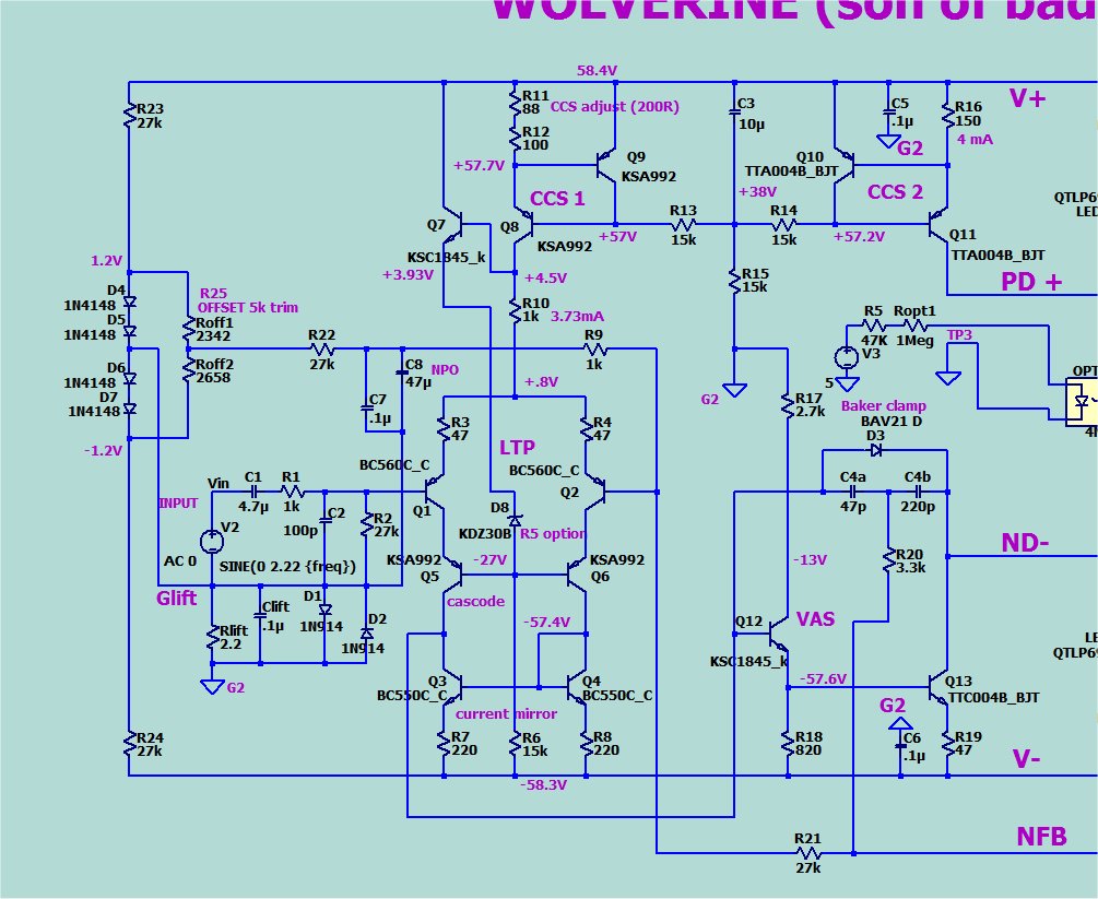

Cheap OEM pots go bad , but hermetically sealed Bourns trimmers are
aerospace quality (20 years +).
Offset is nice , if it is external (DC injection). LTP is rarely a perfect match.
You need bias.
CSS adjust can .... be good. BJT's have a current "sweet spot" of highest gain.
Yes ,Wolverine is mine (Badger/blameless ++)
To beat the other amps , not covered in depth by many.
Other amps are the Leach amp. You can do it very simple (below 1).
That symmetric will cancel out thermally minus the error of the gain difference
between 1st/2nd stages. Pretty good.
(below 2) is one that is accurate .05mA 0-70C. Hawksford VAS is unique at
clip , LED flash !! and prevent any overload Q11-14. Clip looks rounded
like a tube amp and is much harder to hear. TOP dog , but simple.
PS , a "blameless" will beat it at 20Khz but not in durabilty or PSRR. (or sound).
20hz-10Khz they are the same.

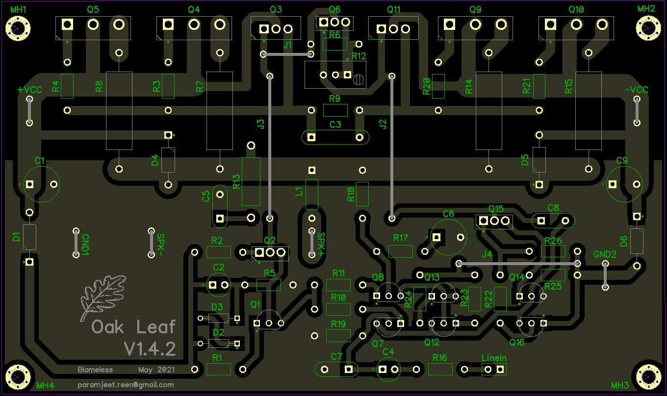

No , if study my type layout carefully ... you will see P/N/P/N alternating.
I takeoff NFB between a P/N pair (right in the middle-of just one pair).
The other 2 pair P/N's don't matter. My output coil (L1) also comes right from the middle
of the farthest right P/N pair.
Just taking NFB from the middle and having L1 at the end will either disrupt
P or N at the centered NFB point.
Even as I am not globally symmetric , my L1 and NFB is perfectly symmetric.
PS - the other "symmetric" is the actual design of the amp. A symmetric
IPS is one with opposing LTP/VAS , like a Leach amp. Totally different
than output stage symmetry , either physical or NFB wise.
ostripper, what is the function of U1, 4N25?
Microprocessor bias external control with a passive default.
Set (passive default) to 50mA , OPTI 1 can step up to 150mA with
a 4-bit word.
OPTO fully isolates the high Z 110V p-p Vbe circuit from the (LED).
control.
A multi-position switch or switch/pot could be on the front panel -
100K = 75mA to 39K= 150mA. Open circuit opto led would be default.

Oh Wow - I actually did miss the P/N/P/N alternating layout. Interesting!
So then I will stay put on the (+) speaker output placement, and try to place the inductor as far as I can from the NFB. The vertical mounting of the inductor should help to some extent in reducing the inductive coupling with adjoining components.
Yes I now understand the other "symmetric" design that you pointed out 🙂

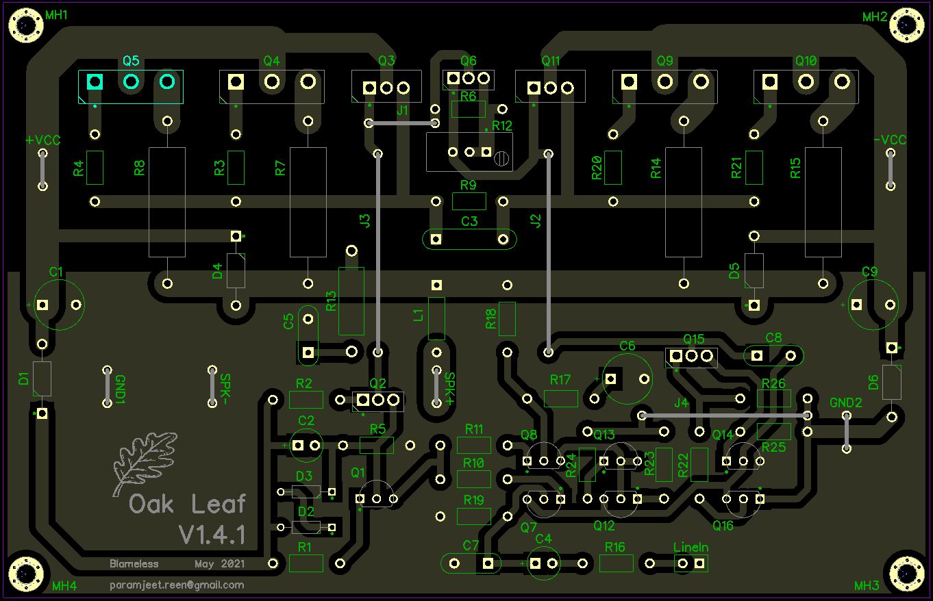

The Latest:
Removal of the ground plane will be a bit more involved since it will require a ground trace running through the PCB. Presently the ground plane takes case of ground for a few components. So keeping the ground plane as of now.
Updated PCB traces to make the Speaker takeoff point same as the NFB takeoff point (both from the middle of the output trace). Hopefully, this ghost has now been laid to rest.
What is left is to add a damping resistor across the output inductor. Yes, that got missed in the schematic as well, and will be added to both the schematic as well as the PCB Layout. Thank you Nick Cresswell (chefhat) for pointing out this error!
Oak Leaf - YABI (Yet Another Blameless Implementation)
Version 1.5.1
a). Added damping resistor (R27) across output inductor (L1).
L1 will be vertically mounted and the resistor will also be vertically mounted inside of it.
b). Re-routed NFB track to make it smaller in length.
Version 1.5.1

Almost there.
Your common returns (6 in total) need to be segregated. I suppose it's a bit of a headache, but the most difficult is to start. Speaker return (the 7th return) should go straight to the power supply common (assuming you won't bring the whole power supply onto the AMP PCB)
Almost there.
Thank you for the inputs!
I understand what you are saying is relevant for the PCB layout.
Unfortunately, when I made this PCB layout, it was designed ground up (pun intended) for using the ground plane for supplying ground to all components (Yep a clanger. I know better now).
I was just wondering if I can stick in several ground wires from the power supply to the board at strategic places (maybe like 3 or 4 places) and get away with it?
Yes, the speaker return can actually be removed from the board and come off the power supply common. That would actually help take some high currents off the ground plane. Only high currents that will remain will be at the two ends of the PCB that supply current to the output stage which can have their own ground wires from the power supply.
Tell me it will work... please.... 🙂

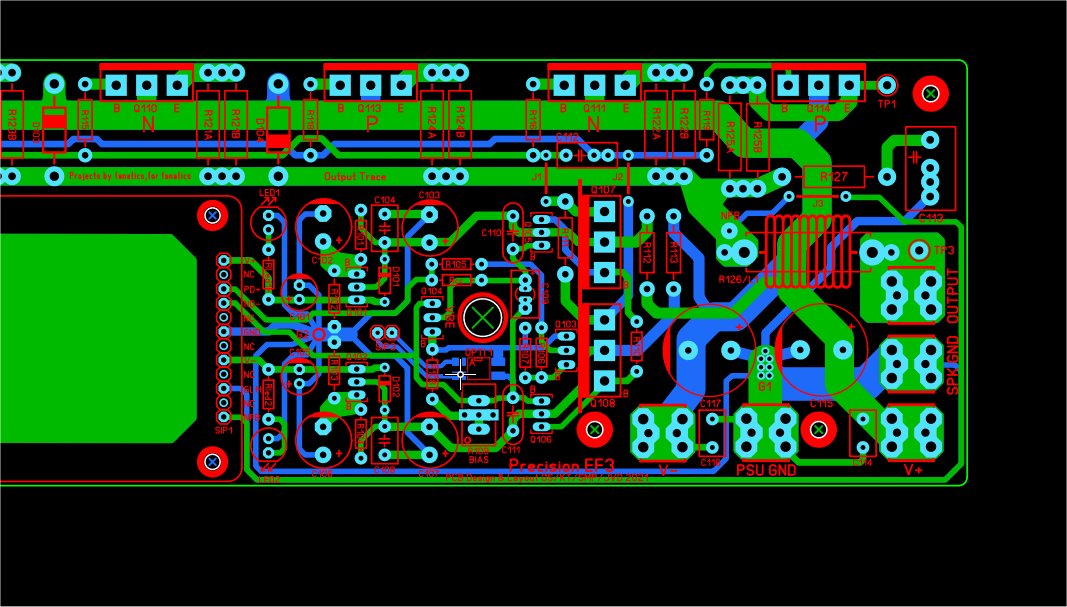

Have a look here:
A Complete Guide to Design and Build a Hi-Fi LM3886 Amplifier - Circuit Basics
https://www.circuitbasics.com/wp-co...er-With-an-LM3886-Master-Wiring-Diagram-4.png
Also - see attached photo
Have a look here:
Now that's certainly a subtle hint as to what needs to be done 😉
Wonderful links there - Thanks!
Now that you (and a few others before you who essentially pointed out the same thing) got me thinking on the grounding aspect, I did a bit of lookup on the topic and it seems there is another interesting topology other than the star ground that is demonstrated in the PCB image you shared.
Bob Cordell BC 1 BAF 2019 Final - YouTube
This is a deep link half an hour into Bob Cordell's presentation at Burning Amp 2019 where he talks about the power and grounding topology that he used for the BC-1.
This certainly seems more "PCB Trace Layout Friendly" then the star ground topology with "medusa hair" traces moving all across the board.
What do you feel?
