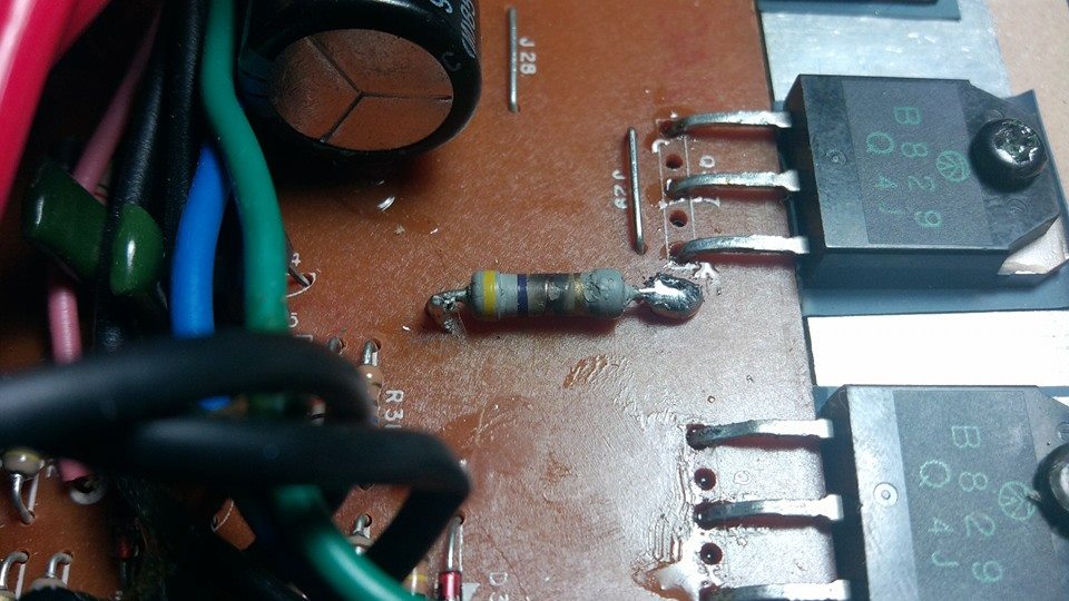

A few weeks ago I decided to try my hand at fixing this old amp again, managed to get some equivilent transistors and popped them in. Please excuse the misplaced solder, I was trying to bypass the resistor and it didn't work.

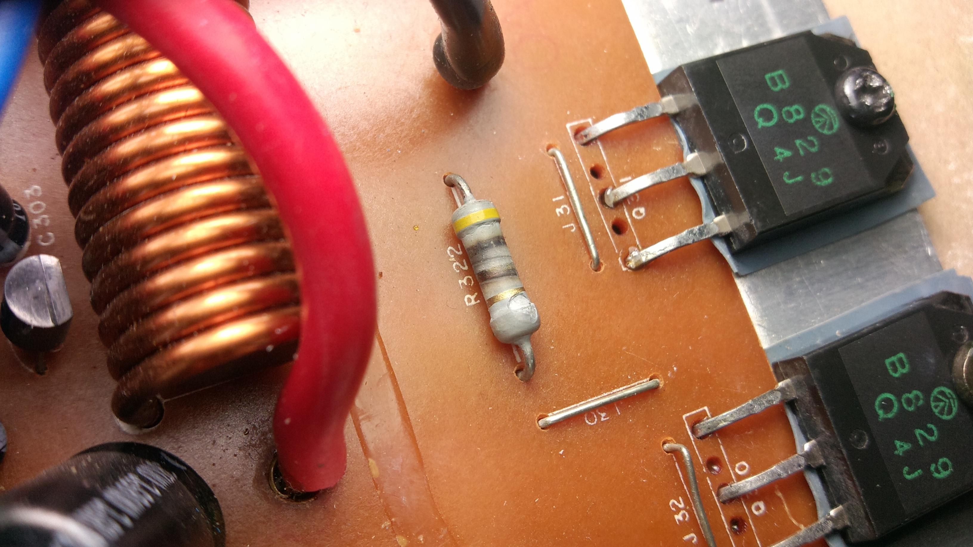

I can't figure out if this is a 0.46 Ohms 5% or 4.6 Ohms 5%
I don't know if you've done any other damage.

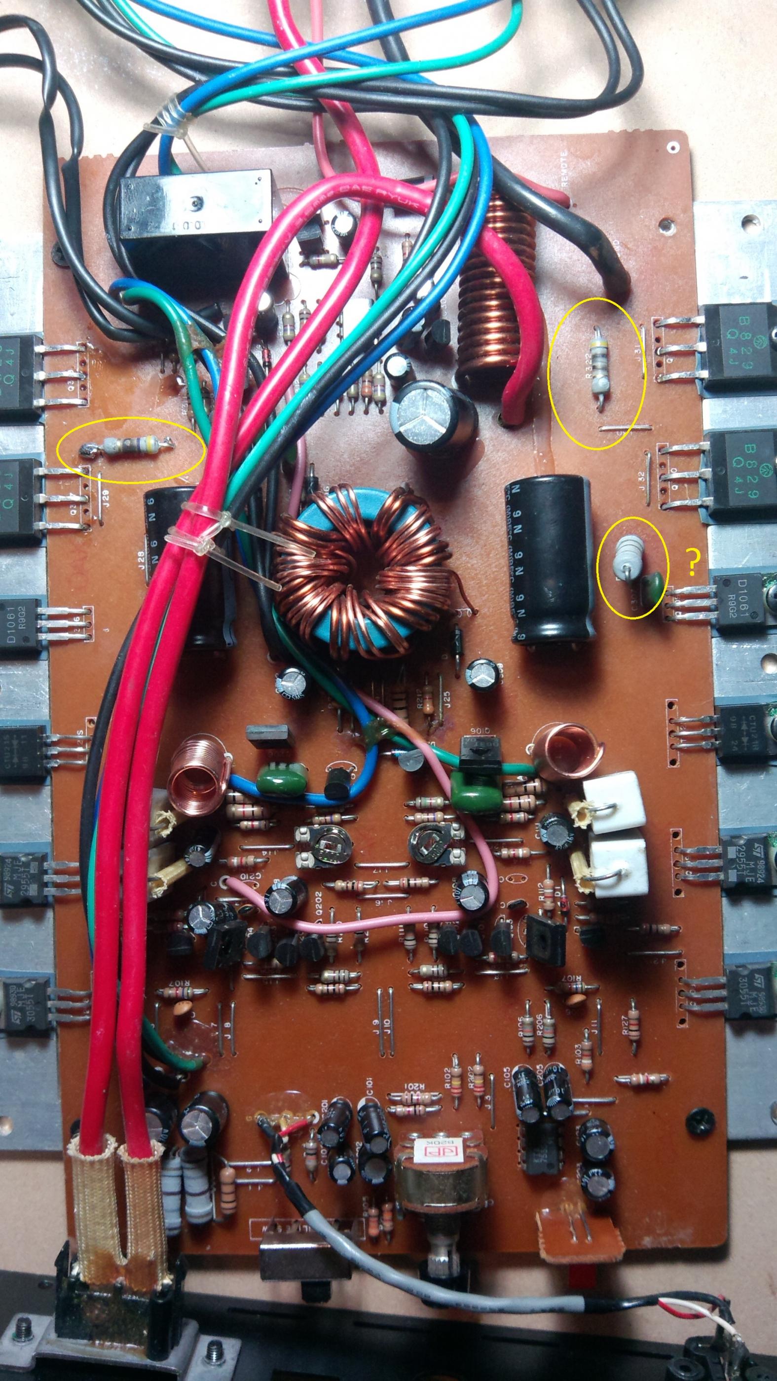

Thank you for your help Perry and others. I feel like a complete noob but at the same time I have learned quite a bit. I'll be ordering the CORRECT replacements from Ebay after Xmas, but I still can't figure out the resistor colors, What is your educated guess judging from the pictures (I'm partially color blind so it doesn't help)
