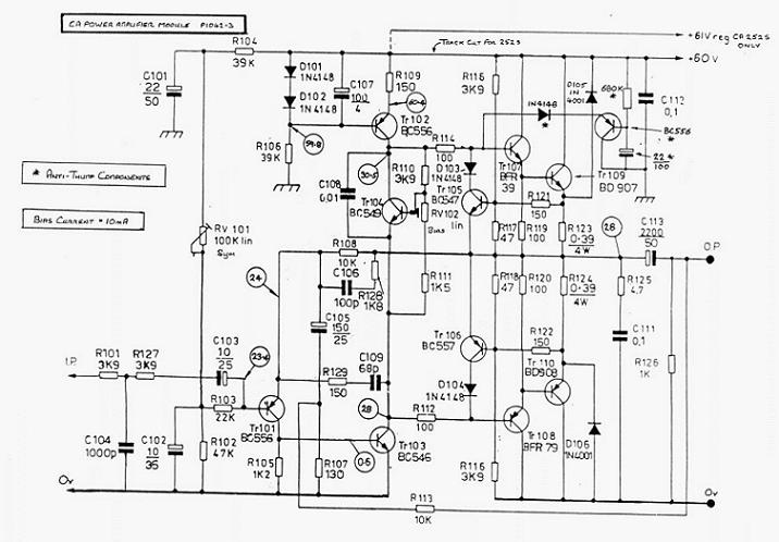

Wow! According to the diagrams the output caps are inside the feedback loop!:xeye Now I need to consult my old theory books on this one. The problem is that increasing the the value of the output caps effectively improves the frequency response at the lower end but those lower frequencies are now being passed back as negative feedback. I'm just concerned that phase shifts aren't turning negative feedback into positive feedback. I could do with some help on this one if anyone knows better than me!
Does it sound ok? You might need to feed in a 1kHz signal and examine the output.
That output circuit looks finely tuned to me. Take a look at R125/C111 and C113/R126. That's manipulating the frequency response and is done to make sure negative feedback stays negative at all times.

Interesting point about the 4 x feedback 0.1 film caps and R's, I havent got a scope so its pure guesswork if its making poss feedback, Doesnt distort or overheat so cant be that much wrong, Just fitted a thermistor to deal with the start up inrush and a mains noise filter just for the hell of it, Next the good qual caps now its stable.

No magic.
R125/C111 is just an output zobel network and R126 provides a ground/ unload for the output capacity. Otherwise, when you plug in your speakers in the powered-on amp, your woofers will possibly blow. This resistor also forms an "end" to the feedback loop.
To include the cap in the NFB loop is clever and well implemented - the loop includes another elcap of course and the compensation. This amp would not work any other way.

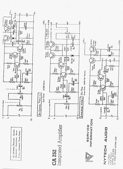

schematics nytech ca 252
Hello, does anyone got the schematics and could email me ?
