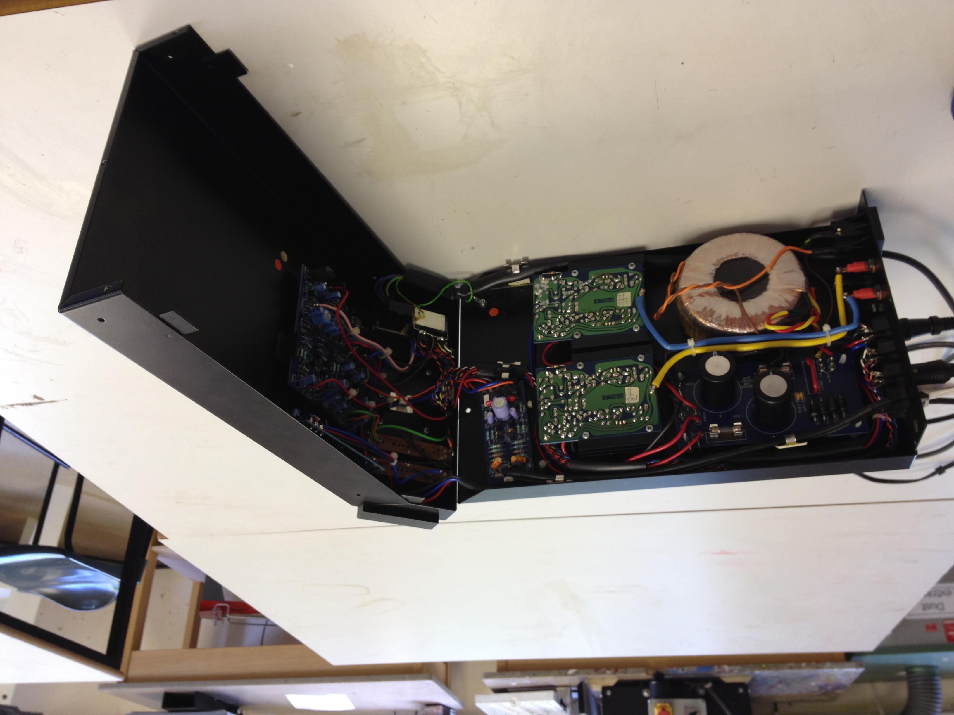

Hi, I'm new to the forum this week and hoping one of you experts out there can help diagnose a problem with my Nytech. I acquired it from the school I work at as it was not functioning for them.
So upon getting it home I discovered it works wonderfully with a pre-amp plugged in to the pre-amp in DIN socket. This bypasses the balance and volume faders and sounds amazing.
However the problem is - there is barely any audible signal using any of the other inputs. I would of course like to use it with phono in mainly. If the volume is up high, a very faint signal can be heard using tape in or phono in.
I opened the case to see if there was any obvious problem, and found it fairly busy with additional processing cards - a little different to the ca202.
It all looks clean and there were no obvious defective components / wires etc. It's very clean inside.
I'm at a bit of a loss as how to approach this issue. Your help would be much appreciated. Here's a photo:

48v would be needed to obtain the rated output power. 28v is ample for a pre-amp, and there are sound quality benefits to having a separate rail.
I thought of possibly one other common component and that could be an op-amp IC, I've seen them shared on both L/R channels before - not very likely though.
The 48V is a simple bridge psu, so plenty of ripple. The derived 28V should be stable and clean. Single rail amplifiers are always more sensitive to power supply noise.
There is a 82R series resistor on the 28V rail forming an extra RC filter for the input stage power supply of both channels. Check the voltages on this part

I've cracked open the Amp again wielding a multimeter in it's general direction for a while tonight. I could not find any 82r resistors to check on any of the boards.
However I have noted a couple of happenings - there is no L or R voltage to the main pre amp board (fixed to the underside of the lid) leading from the phono/aux switch or the resistors next in line.
There is also another separate smaller module with 34V input (down to stable 28). This has outputs to both the volume fader and back to the Pre/Amp socket - none of these outputs show a voltage.
So I am wondering now if the switch is defective.
However, after vigorous testing well into the night I stupidly popped one of the little glass fuses - 250mAV so now nothing works! I'll get to the electrical wholesaler soon...
I was posting from memory, thinking about R368 680R on the disc input.
If there is no 28V, check fuse F1 160mA on the PSU board. I don't see a 250mA fuse on the schematic. There is no short circuit protection on the 28V regulator, so R374 22R may have blown open
