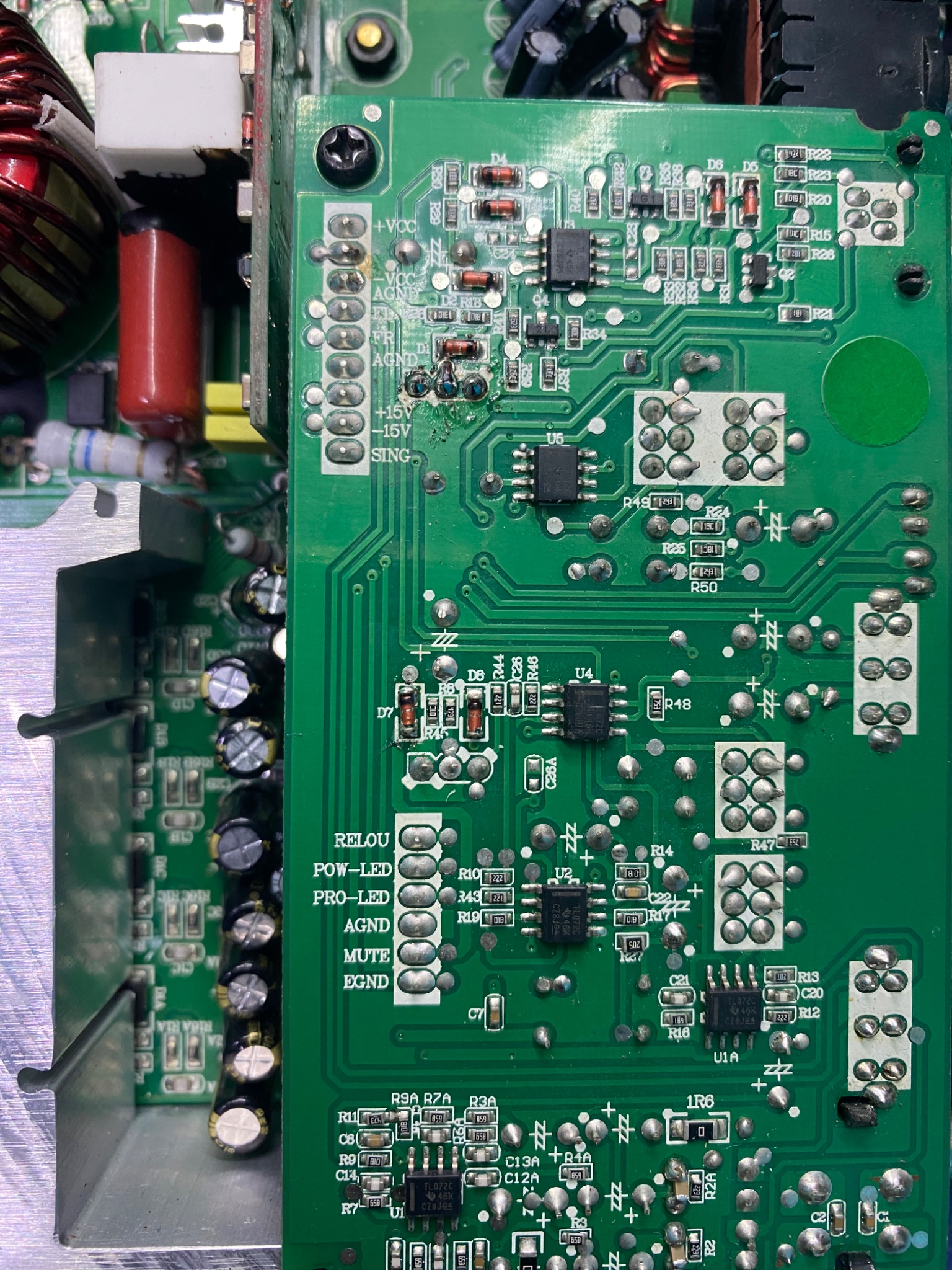

This amp protect Led is on but it is not in protect. I see oscillation on all channels but it has no output.I think it is in mute.I see 12v on the mute pin.Also R15e was open.

Sub channel drive board has 14 pins.I will inject a signal to see if I can see it on any of the pins.
0.756v on relay input while channel is oscillating.
Signal is not reaching the SG pin on the driver board.It is directly connected to the SING pin on the preamp board.

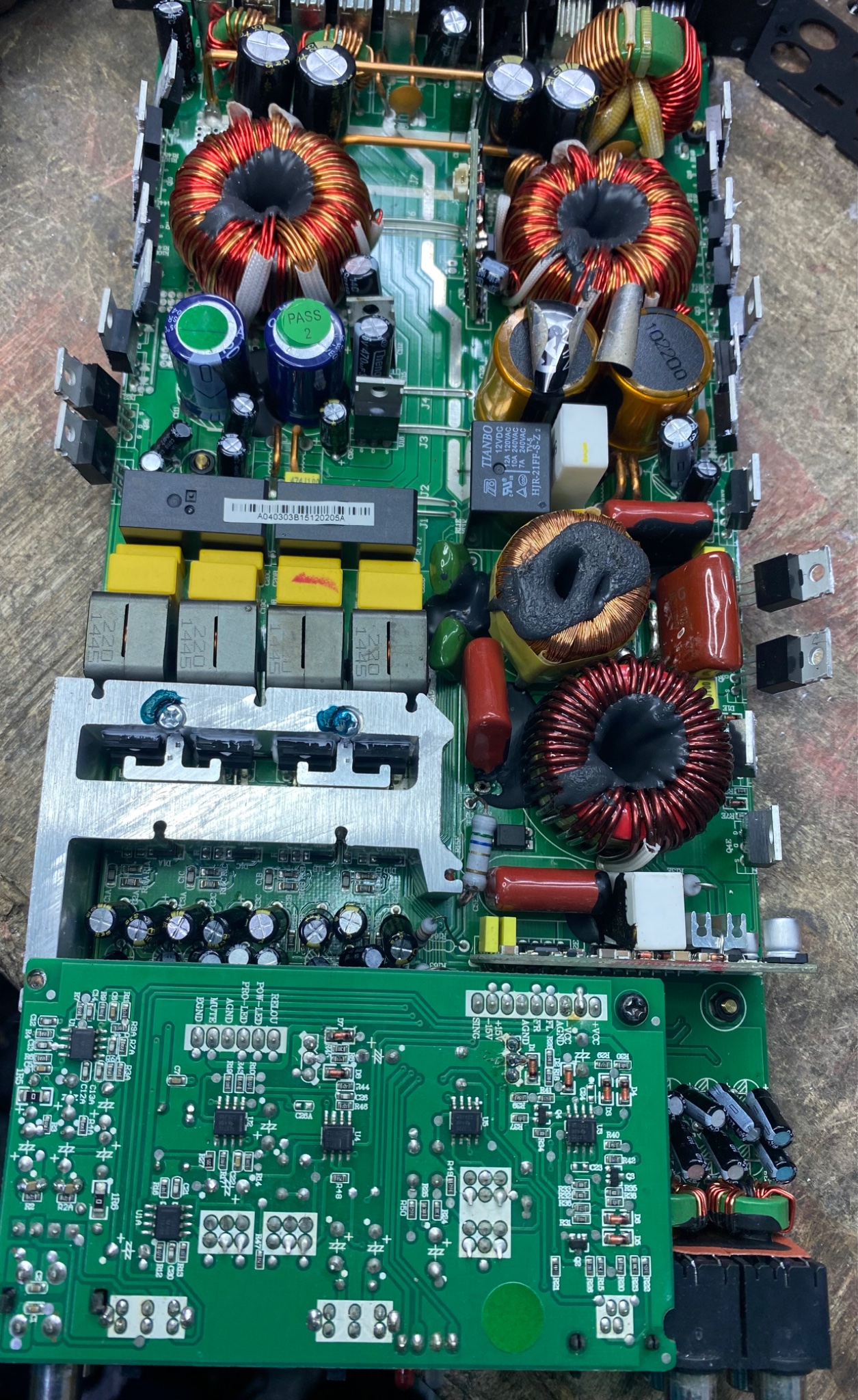

I have a donor amp,I swap the preamp board but no change.I am not sure if that board is functional just tried it.

The supply voltages mark on the sub driver board present.

The sub driver board from the old amp look like work had been done on it but I will try it to see.
