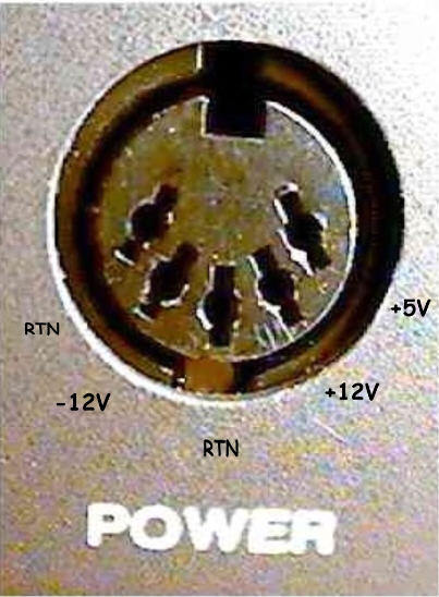

Hi everyone. I'm still trying to find the specs on the ac adaptors that the nView z310/z350 panels use. I have searched far and wide for any information on these panels and it is very rare. If anyone owns either one of these you could help me out alot by finding out the voltages on the pins of the adapter.
I attached a pic of the power plug.

Hello, I hope this will help you. I have 2 z350's. The power supply is made by Bestec power electronics co. The model # is BPA-353-n.
INPUT - 100-240v 50/60Hz 1a-max
OUTPUT +5.9v/3a, +12v/1.55, -12v/0.27a

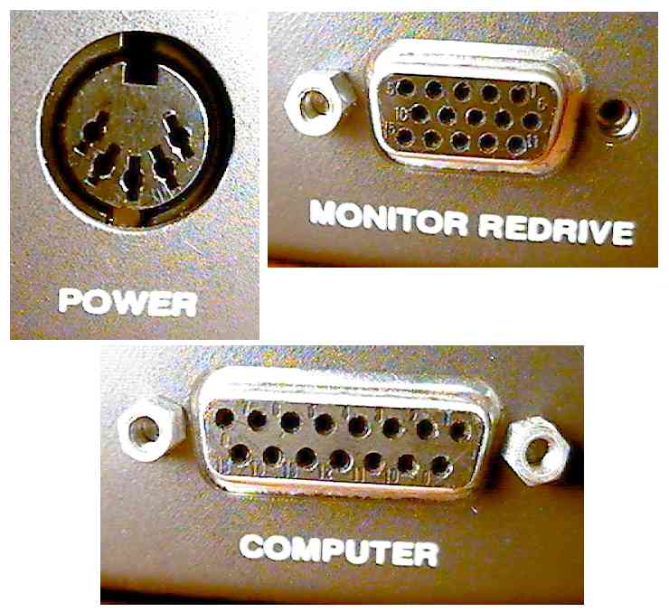

I do not have VGA adapter for my z350. I was hoping someone would be able to tell me the pin-out that will go from 3 rows of 5 to 2 rows with 7 and 8. The post in panel paranoia for a nview spectra c did not work for my z350. I noticed in the previous photo that the holes are numbered. I think I will try again using these as my guide. Hope my info helps you.

ATX power supply seems to work
OK, after learning a little about amperage I rigged up an ATX power supply to feed the z350 the proper voltages.
The nView fired up and here is all I got:
* the fan turned on.
* the speaker made a very low noise that sounded like it was turned on
* the red LED turned on
* the small LCD display panel in the keypad turned on and after a few seconds displayed "press any key" - pressing any key on the keypad did nothing
the green LED never lit
the LCD panel itself never seemed to do anything, no display, no logo, etc.
I do not have anything connected to the panel VGA port yet.
What is the typical startup sequence for a z310/z350 ? Is this typical? I would expect pressing a key on the keypad to do something.

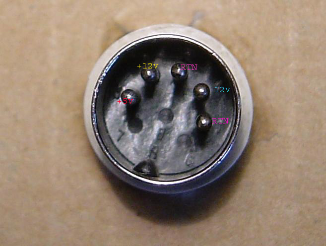

davneil
this is the plug with the voltages on the pins . the colour of the writing corresponds to the colour of the wire's you will find in the pc powersupply ,exept for the RTN which is black any AT powersupply will do.these wires are usually standard.if you have any probs i will help you as best as i can.good luck.
ps this works on my z310 . iam only assuming it is the same for the z350.
thanks all
thanks all
