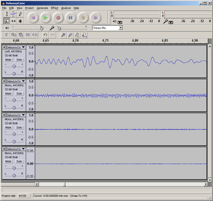

I posted current source, converted wav file to my site.
If your player can open / play extended wav format, please let me know.
attached is Audacity screen capture, it shows result wav file. If I have 8 channel sound device, maybe I can play it now.

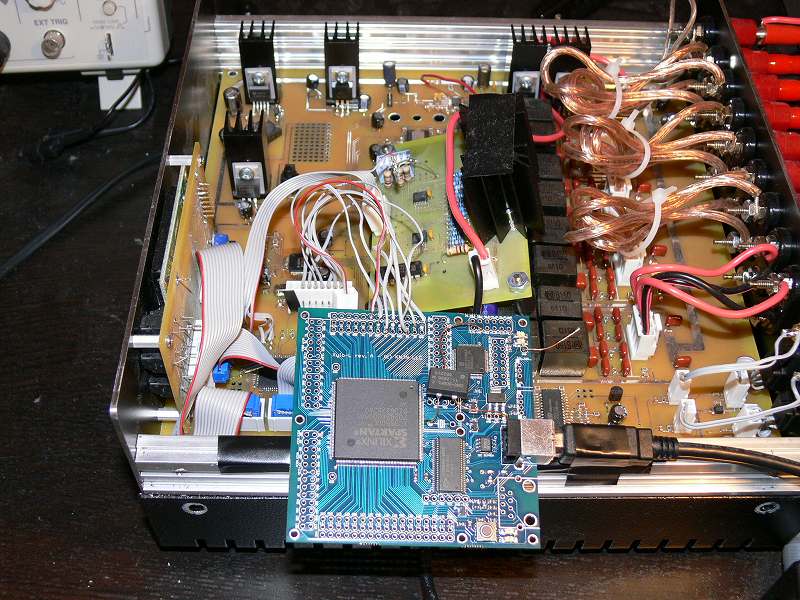

I posted to my site, test result of Xylo-L board from www.fpga4fun.com.
This is very easy board, enough for my application, but not a extreme faster.
Hi, Now I did almost hardware/firmware/PC software, and listening True 8192 Taps FIRed 4 way sound:spin:
