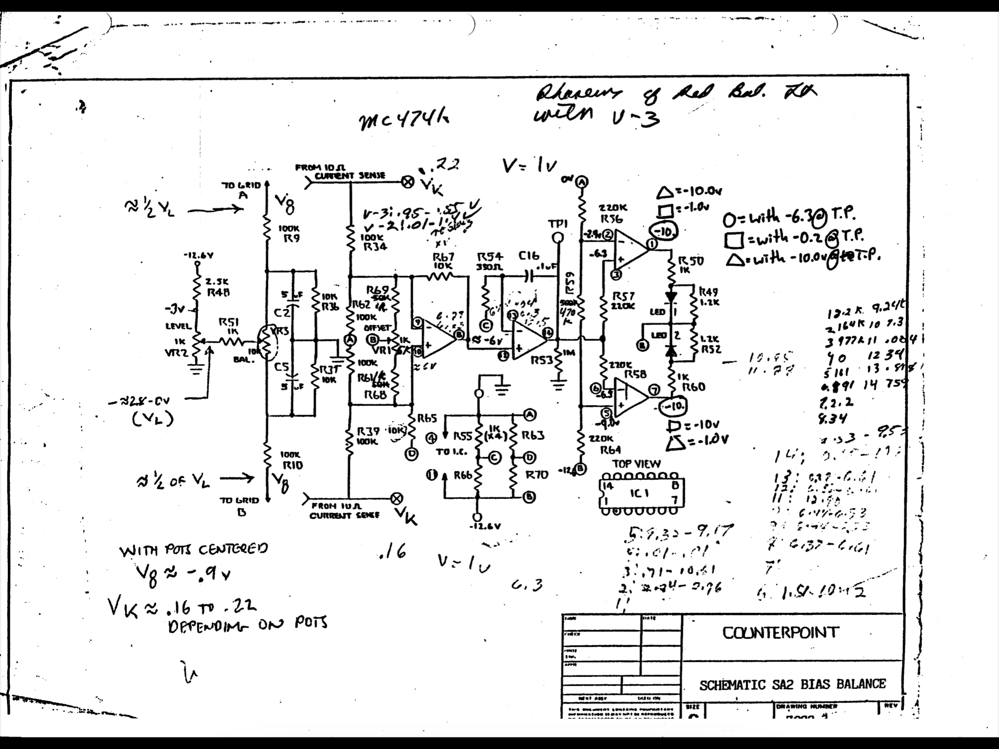

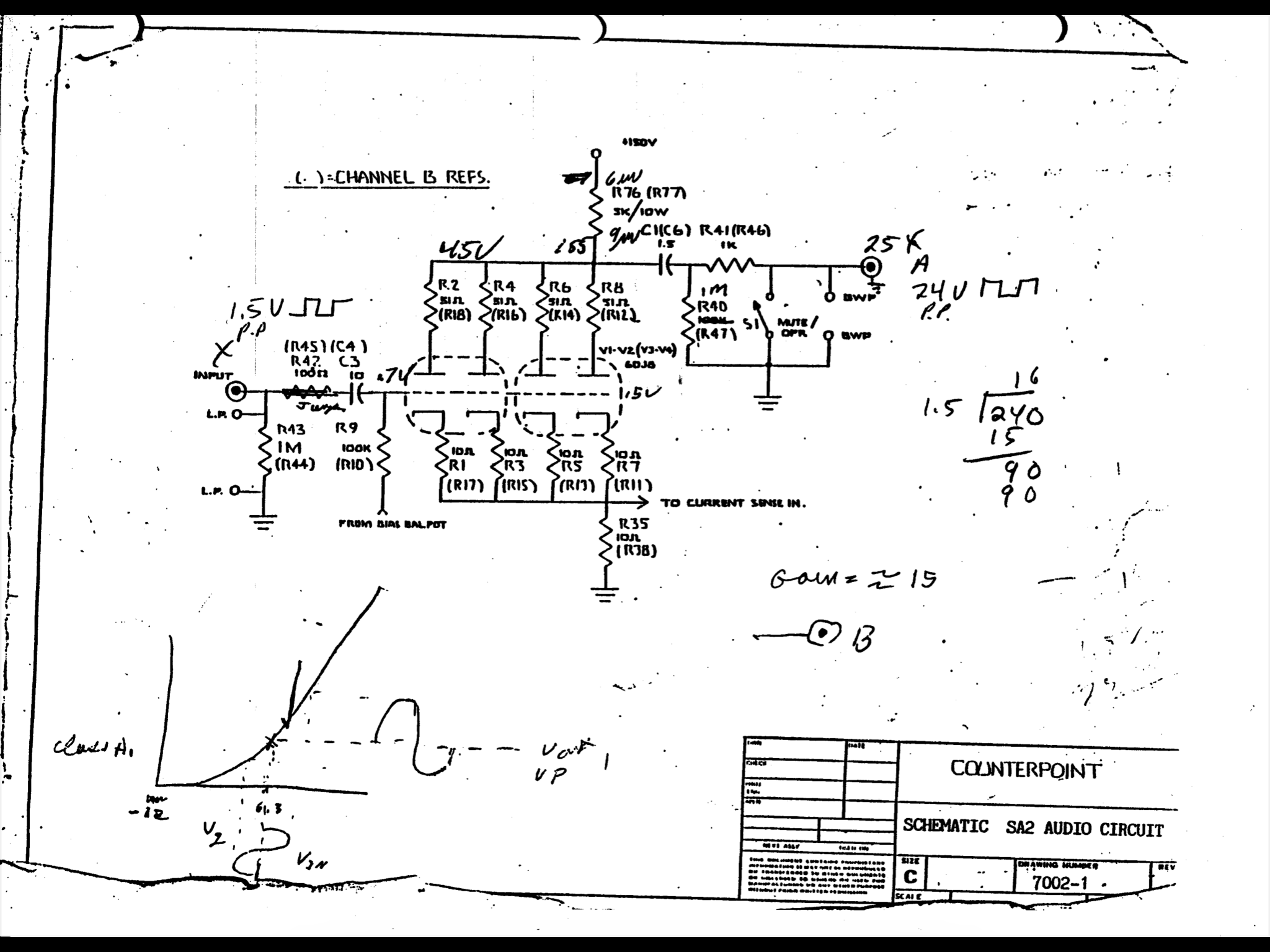

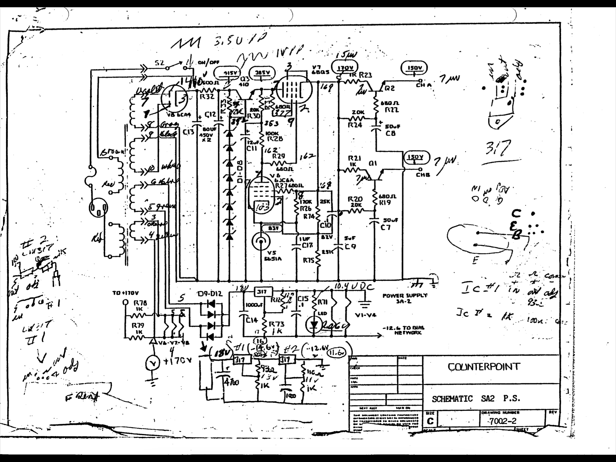

I was researching various tube based MC stages, and came across this thread, and thought I would mention the Counterpoint SA-2, an acquaintance of mine had mentioned owning one. A very interesting design, using fixed biasing, and a neat bias control setup as well!

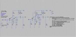

I've been running this simple thing since forever. The tubes were Zaerix branded, made in Russia 6DJ8.
It started out as a quick and dirty experiment, but it's so pleasant I just kept running it until it died: I mistakenly plugged it in an unswitched outlet, so it was running continuously for 10+ years! I swapped in a mckinnie which has a lot less noise, better resolution, but less micro dynamics. And if John Curl (who designed it in the 70's) would look the other way, I'd say I prefer my little thingy.
I found some ex-oscilloscope, HP branded, made by Amperex, 6DJ8 and swapped the thingy back. I'm happy.
  • PPA-Tube-103.asc

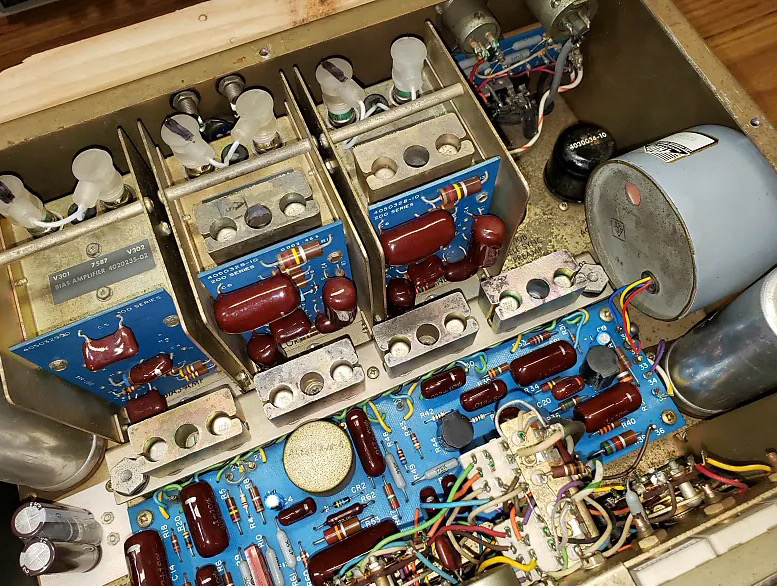

Mounting Nuvistors to reduce microphonics
Nuvistors vary greatly in their tendency to be microphonic from unit-to-unit. The problem is that the character of a microphonic Nuvistor can be very “wirey” and irritating, due to the smaller internal elements resonating at higher frequencies than those in larger tubes.
Ampex used Nuvistors extensively in their last tube recorder, the famous and much-coveted MR-70. It used two tube types throughout: 7895 triodes and 7587 tetrodes. Ampex used a trick however; they mounted the Nuvistors into heavy metal clamps, and I believe these clamps were then isolated from the main chassis by rubber shock isolators. The clamps and rubber “springs” effectively acted as mechanical low-pass filters to keep out vibrations that could excite the internal elements. That’s a bit if a nuisance but perhaps worth trying.
It sounds like you haven’t even tried it. You can open that .asc file and see the schematic right away. You don’t even need to “simulate” anything. It will take you less effort than posting here a few times.
Without the right version of spice you won't see anything.
My macspice did not understand the thing.
Displaying the schematics might be a nice gesture to us non-windows people.
Zung gave a probably nice circuit as Christmas gift to the community,
but it is wrapped in a way so that not everybody can enjoy it.
Opening the file for me gives a netlist, on my couch reading device,
and on the office computer also.
I am sure other people would be delighted also. No need to discuss this.
